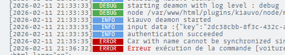

J’ai refait l’installation, ca à l’air d’etre bon (« authentication succeeded ») mais j’ai une nouvelle erreur (lock.disable):

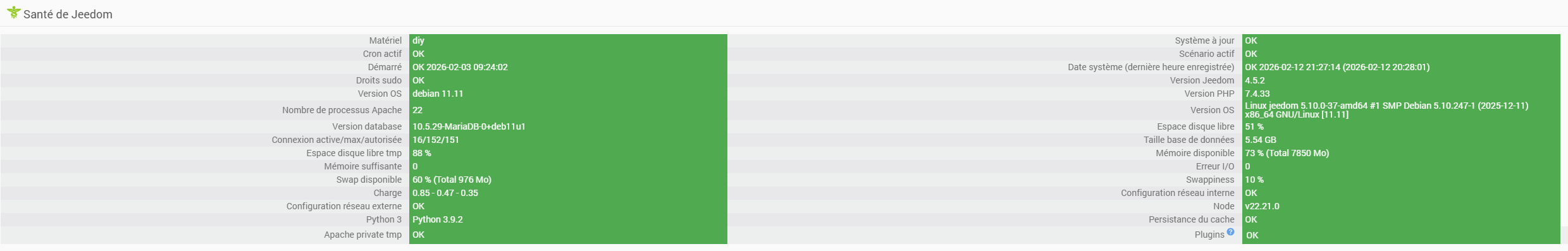

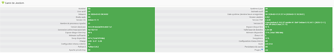

Page santé et log exploitable, voir lien.

Voici:
0026|[2026-02-11 21:33:33] INFO  Starting kiauvo deamon
0027|[2026-02-11 21:33:33] DEBUG  starting deamon with log level : debug
0028|[2026-02-11 21:33:33] DEBUG  node /var/www/html/plugins/kiauvo/node/main.js --region=EU --pin=**** --password= --userName= --port=8090 --language=fr --callbackUrl=aHR0cDovLzE5Mi4xNjguMS4zOTo4MC9wbHVnaW5zL2tpYXV2by9jb3JlL2FwaS9pbnRlcm5hbC5waHA= --fakeVehicles=0 --euAccessToken=******** --euRefreshToken=***** --sharedFile=/tmp/jeedom-kiauvo-key.dat
0029|[2026-02-11 21:33:33] INFO  kiauvo deamon started
0030|[2026-02-11 21:33:35] INFO  input data :{"key":"2dc38cbb-8f3c-432c-af2b-2b07c640f8f9","task":{"accessToken":"eyJhbGciOiJSUzI1NiIsInR5cCI6IkpXVCJ9.eyJwaWQiOiI1YmIyYzcyMDlhOTk0MzA0MTk0MzZlYzQiLCJ1aWQiOiIyYjFlMTNkNC03YzQ2LTRiZWUtYmJlZi02ZDIzYjBhNmVhM2QiLCJzaWQiOiJmZGM4NWMwMC0wYTJmLTRjNjQtYmNiNC0yY2ZiMTUwMDczMGEiLCJleHAiOjE3NzA4NDU2MTUsImlhdCI6MTc3MDg0MjAxNSwiaXNzIjoidXZvIn0.f9TqJGgGhMmtEbF2IhzaixRDpjNrog8e-9e4DJytHJELPf-gPVCKXcMceosCpmVjdkyXMfWgi8KyiLMlkHPb9dx9nvRjKarQJ3V7O0WBZ74u8HTs1dIjYBiBu5BHTC1eJg4AIuSTG0hogpy07yHoXy8nWiyv32xcrQabfAmtSQvmBh0KYz5QYMZYeGs8gcFh_FC31bzE0QjIK3LN5bfeRbGTjFpiRYMuTb9OP3xA5E9sQCvhUGwpx1NTt3eRoEULGGxe1XqyE0ey9R7Xfv54orlWWgHryQ4sRXSD65qh4StCSdlzSLAFiHo3wBpaQAbKdkeptsDfHYUkgxneEaDvkA","refreshToken":"NJK2MGY5NDUTY2FMOS01ODHILTHHMDITMZQ1MMYYMZA2ZJJM","tokenExpiresAt":1770845615},"status":"eu-set-tokens"}
0031|[2026-02-11 21:33:35] INFO  authentication succeeded
0032|[2026-02-11 21:35:35] ERROR  Car with name cannot be synchronized since it has no identifier set (EV6)
0033|[2026-02-11 21:36:32] ERROR  Erreur exécution de la commande [voiture][EV6][déverrouiller] : Le démon kiauvo n'a pas réussi a traiter la demande. Details : http://127.0.0.1:8090/cars//lock.disable?key=****** status : 404 , message : <!DOCTYPE html>
0034|<html lang="en">
0035|<head>
0036|<meta charset="utf-8">
0037|<title>Error</title>
0038|</head>
0039|<body>
0040|<pre>Cannot GET /cars//lock.disable</pre>
0041|</body>
0042|</html>
0043|[2026-02-12 08:02:02] ERROR  Erreur exécution de la commande [voiture][EV6][activer le préchauffage] : Le démon kiauvo n'a pas réussi a traiter la demande. Details : http://127.0.0.1:8090/cars//heat.enable?temperature=21&defrost=true&heating=true&key=****** status : 404 , message : <!DOCTYPE html>
0044|<html lang="en">
0045|<head>
0046|<meta charset="utf-8">
0047|<title>Error</title>
0048|</head>
0049|<body>
0050|<pre>Cannot GET /cars//heat.enable</pre>
0051|</body>
0052|</html>
0053|[2026-02-12 08:03:02] ERROR  Erreur exécution de la commande [voiture][EV6][activer le préchauffage] : Le démon kiauvo n'a pas réussi a traiter la demande. Details : http://127.0.0.1:8090/cars//heat.enable?temperature=21&defrost=true&heating=true&key=****** status : 404 , message : <!DOCTYPE html>
0054|<html lang="en">
0055|<head>
0056|<meta charset="utf-8">
0057|<title>Error</title>
0058|</head>
0059|<body>
0060|<pre>Cannot GET /cars//heat.enable</pre>
0061|</body>
0062|</html>
