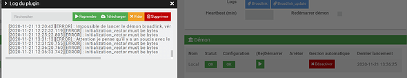

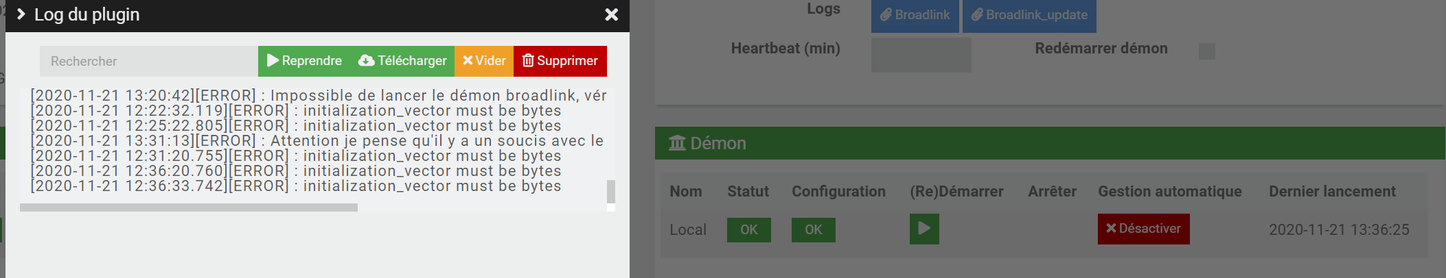

[2020-11-21 13:02:08.519][DEBUG] : Client connected to [127.0.0.1:39568]
[2020-11-21 13:02:08.522][DEBUG] : Message read from socket: b'{"apikey":"Qv0QurfI5MHiTMRtjW5N8N0qXhML3URr","cmd":"send","cmdType":"learn","device":{"mac":"8fdb00770f78","ip":"192.168.1.68","name":"BroadLink","delay":"300","port":"80","type":"rm2","mode":"normal"}}'
[2020-11-21 13:02:08.523][DEBUG] : Client disconnected from [127.0.0.1:39568]
[2020-11-21 13:02:08.530][DEBUG] : Message received in socket JEEDOM_SOCKET_MESSAGE
[2020-11-21 13:02:08.538][DEBUG] : Send command
[2020-11-21 13:02:08.540][ERROR] : initialization_vector must be bytes
Oui redémarré à l’instant.
J’ai voulu créer de nouvelles commandes, mais rien ne se passe non plus
