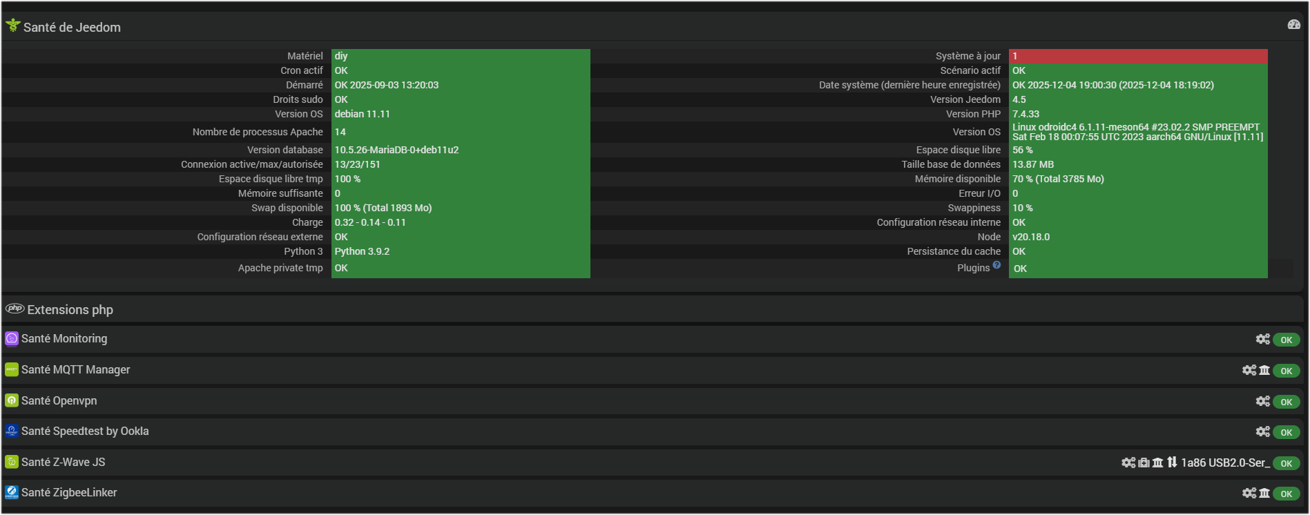

Alors chez moi la box N°2 odroid c4 que j’avais passé en 4.5 ne fait pas de plantage et dans le log il n’y a plus d’arrêt du client lors de la sauvegarde a n’y rien comprendre, j’ai deux différences par rapport à l’atlas, la clé zigbee est une sonoff et zigbee2mqtt est en version 2.6.1.

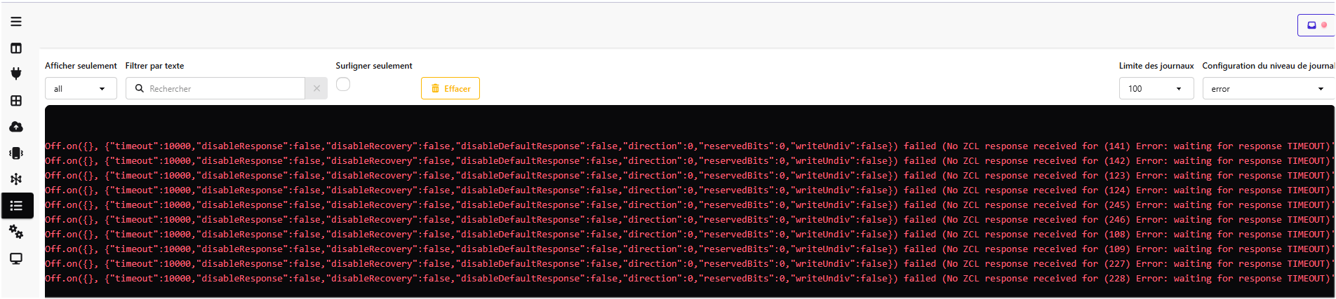

Par contre sur l’atlas ou je suis revenu en 4.4.20 tous fonctionne toujours bien mais j’ais remarqué que sur l’interface Zigbee2Mqtt (6.2.3) quand je regarde journaux
[04/12/2025 18:40:33] z2m: Publish 'set' 'state' to 'ECL Hote' failed: 'Error: ZCL command 0xa4c1386a29d0197c/1 genOnOff.on({}, {"timeout":10000,"disableResponse":false,"disableRecovery":false,"disableDefaultResponse":false,"direction":0,"reservedBits":0,"writeUndiv":false}) failed (No ZCL response received for (141) Error: waiting for response TIMEOUT)'
[04/12/2025 18:40:34] z2m: Publish 'set' 'state' to 'ECL Hote' failed: 'Error: ZCL command 0xa4c1386a29d0197c/1 genOnOff.on({}, {"timeout":10000,"disableResponse":false,"disableRecovery":false,"disableDefaultResponse":false,"direction":0,"reservedBits":0,"writeUndiv":false}) failed (No ZCL response received for (142) Error: waiting for response TIMEOUT)'
[04/12/2025 18:43:43] z2m: Publish 'set' 'state' to 'ECL Hote' failed: 'Error: ZCL command 0xa4c1386a29d0197c/1 genOnOff.on({}, {"timeout":10000,"disableResponse":false,"disableRecovery":false,"disableDefaultResponse":false,"direction":0,"reservedBits":0,"writeUndiv":false}) failed (No ZCL response received for (123) Error: waiting for response TIMEOUT)'
[04/12/2025 18:43:44] z2m: Publish 'set' 'state' to 'ECL Hote' failed: 'Error: ZCL command 0xa4c1386a29d0197c/1 genOnOff.on({}, {"timeout":10000,"disableResponse":false,"disableRecovery":false,"disableDefaultResponse":false,"direction":0,"reservedBits":0,"writeUndiv":false}) failed (No ZCL response received for (124) Error: waiting for response TIMEOUT)'
[04/12/2025 18:45:18] z2m: Publish 'set' 'state' to 'ECL Hote' failed: 'Error: ZCL command 0xa4c1386a29d0197c/1 genOnOff.on({}, {"timeout":10000,"disableResponse":false,"disableRecovery":false,"disableDefaultResponse":false,"direction":0,"reservedBits":0,"writeUndiv":false}) failed (No ZCL response received for (245) Error: waiting for response TIMEOUT)'
[04/12/2025 18:45:19] z2m: Publish 'set' 'state' to 'ECL Hote' failed: 'Error: ZCL command 0xa4c1386a29d0197c/1 genOnOff.on({}, {"timeout":10000,"disableResponse":false,"disableRecovery":false,"disableDefaultResponse":false,"direction":0,"reservedBits":0,"writeUndiv":false}) failed (No ZCL response received for (246) Error: waiting for response TIMEOUT)'
Il y a des erreurs et quand j’étais en V 4.5 c’était ce module qui m’arrêtait le client.
Donc je vois des erreurs dans journaux mais dans jeedom il n’y a aucune erreur dans le log zigbee2mqtt

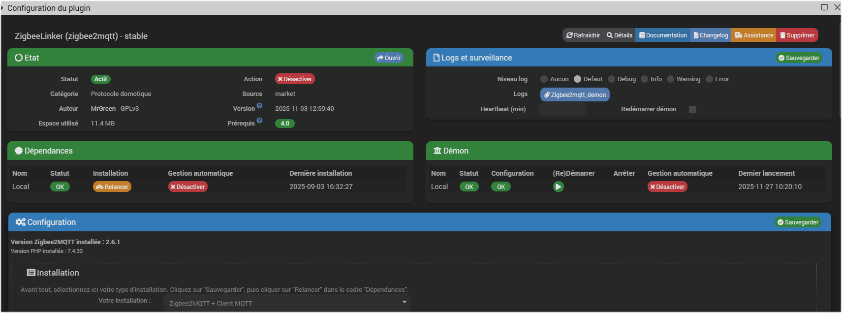

Faites attention de ne pas trop mélanger les soucis si je ne dis pas de bêtises, il y a 3 soucis :
  1. Version 2.7 de Zigbee2MQTT - Ne fonctionne qu’avec la V4.5.1 de Jeedom
  2. Version 2.6.3 et inferieur Zigbee2MQTT en Jeedom V4.5:
    2.1 PHP 8 : erreur qui provoque des erreur de calcul => plantage du client MQTT (pallié avec les dernière version de ZigbeeLinker)
    2.2 PHP 7 : problème inconnu => plantage du client MQTT (pallié avec les dernière version de ZigbeeLinker)
La version Béta a été passé en Stable pour la stabilité du démon client MQTT.

Alors c’est presque ça, je suis en 4.5 et 2.7 et nodejs 20.19.1 :sweat_smile: et ça roule.
