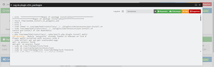

Il faut donner les logs alors. Lire le post suivant pour un partage efficace (pas dichier, pas d’image).
+ touch /tmp/jeedom_install_in_progress_z2m
+ echo 1
+ echo 2
+ sudo chmod +x /var/www/html/core/class/../../plugins/z2m/resources/pre-install.sh
+ sudo /var/www/html/core/class/../../plugins/z2m/resources/pre-install.sh
Launch pre-install of z2m dependancy
+ echo 3
+ php /var/www/html/core/class/../php/jeecli.php plugin install mqtt2
PHP Warning:  Module 'mosquitto' already loaded in Unknown on line 0
Plugin mqtt2 installed with success+ echo 4
apt: no process found
apt-get: no process found
+ sudo apt update
Hit:1 http://deb.debian.org/debian bullseye InRelease
Hit:2 http://security.debian.org/debian-security bullseye-security InRelease
Hit:3 http://deb.debian.org/debian bullseye-updates InRelease
Hit:4 https://deb.nodesource.com/node_22.x nodistro InRelease
Reading package lists...
Building dependency tree...
Reading state information...
21 packages can be upgraded. Run 'apt list --upgradable' to see them.
+ echo 5
Hit:1 http://security.debian.org/debian-security bullseye-security InRelease
Hit:2 http://deb.debian.org/debian bullseye InRelease
apt-utils is already the newest version (2.2.4).
lsb-release is already the newest version (11.1.0).
git is already the newest version (1:2.30.2-1+deb11u5).
0 upgraded, 0 newly installed, 0 to remove and 21 not upgraded.
[Check Version NodeJS actuelle : v22.21.0 : PHP Warning:  Module 'mosquitto' already loaded in Unknown on line 0
[  OK  ]
Clean npm cache
npm warn using --force Recommended protections disabled.
+ echo 6
+ sudo apt install -o Dpkg::Options::=--force-confdef -y php-yaml
php-yaml is already the newest version (2.2.1+2.1.0+2.0.4+1.3.2-2).
+ echo 7
+ sudo systemctl restart apache2
+ echo 8
+ sudo chmod +x /var/www/html/core/class/../../plugins/z2m/resources/post-install.sh
+ sudo /var/www/html/core/class/../../plugins/z2m/resources/post-install.sh
+ echo 'Launch post-install of z2m dependancy'
+++ realpath /var/www/html/core/class/../../plugins/z2m/resources/post-install.sh
++ dirname /var/www/html/plugins/z2m/resources/post-install.sh
+ BASEDIR=/var/www/html/plugins/z2m/resources
+ '[' -d /var/www/html/plugins/z2m/resources/zigbee2mqtt ']'
+ rm -rf /var/www/html/plugins/z2m/resources/zigbee2mqtt
+ mkdir /var/www/html/plugins/z2m/resources/zigbee2mqtt
+ git clone --depth 1 https://github.com/Koenkk/zigbee2mqtt.git /var/www/html/plugins/z2m/resources/zigbee2mqtt
Cloning into '/var/www/html/plugins/z2m/resources/zigbee2mqtt'...
+ cd /var/www/html/plugins/z2m/resources/zigbee2mqtt
+ '[' -f /var/www/html/plugins/z2m/resources/../data/wanted_z2m_version ']'
+ '[' -n '' ']'
+ npm install -g pnpm
changed 1 package in 4s
1 package is looking for funding
run `npm fund` for details
+ pnpm i --frozen-lockfile
Lockfile is up to date, resolution step is skipped
Progress: resolved 1, reused 0, downloaded 0, added 0
Packages: +269
Progress: resolved 269, reused 269, downloaded 0, added 39
Progress: resolved 269, reused 269, downloaded 0, added 269, done
dependencies:
+ ajv 8.17.1
+ bind-decorator 1.0.11
+ debounce 3.0.0
+ express-static-gzip 3.0.0
+ fast-deep-equal 3.1.3
+ finalhandler 2.1.1
+ humanize-duration 3.33.1
+ js-yaml 4.1.1
+ json-stable-stringify-without-jsonify 1.0.1
+ jszip 3.10.1
+ mqtt 5.14.1
+ object-assign-deep 0.4.0
+ rimraf 6.1.2
+ semver 7.7.3
+ source-map-support 0.5.21
+ throttleit 2.1.0
+ winston 3.18.3
+ winston-syslog 2.7.1
+ winston-transport 4.9.0
+ ws 8.18.3
+ zigbee-herdsman 7.0.4
+ zigbee-herdsman-converters 25.83.1
+ zigbee2mqtt-frontend 0.9.21
+ zigbee2mqtt-windfront 2.4.2
optionalDependencies:
+ unix-dgram 2.0.7
devDependencies:
+ @biomejs/biome 2.3.8
+ @types/finalhandler 1.2.4
+ @types/humanize-duration 3.27.4
+ @types/js-yaml 4.0.9
+ @types/node 24.10.1
+ @types/object-assign-deep 0.4.3
+ @types/readable-stream 4.0.22
+ @types/serve-static 2.2.0
+ @types/ws 8.18.1
+ @vitest/coverage-v8 3.2.4
+ tmp 0.2.5
+ typescript 5.9.3
+ vitest 3.2.4
Done in 4.2s using pnpm v10.18.3
+ pnpm run build
> zigbee2mqtt@2.7.1 build /var/www/html/plugins/z2m/resources/zigbee2mqtt
> tsc && node index.js writehash
+ chown www-data:www-data -R /var/www/html/plugins/z2m/resources/zigbee2mqtt
+ echo 9
+ php /var/www/html/core/class/../php/jeecli.php plugin dependancy_end z2m
+ echo 10
+ rm /tmp/jeedom_install_in_progress_z2m
> zigbee2mqtt@2.7.1 start
> node index.js
Migration notes written in /var/www/html/plugins/z2m/data/migration-1-to-2.log
Migration notes written in /var/www/html/plugins/z2m/data/migration-2-to-3.log
Migration notes written in /var/www/html/plugins/z2m/data/migration-3-to-4.log
READ THIS CAREFULLY
Refusing to start because configuration is not valid, found the following errors:
- serial/adapter must be equal to one of the allowed values
If you don't know how to solve this, read https://www.zigbee2mqtt.io/guide/configuration
Failure page is available at http://0.0.0.0:8080/
> node index.js
READ THIS CAREFULLY
> node index.js

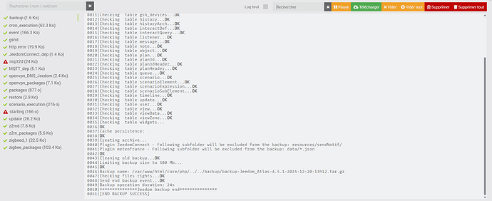

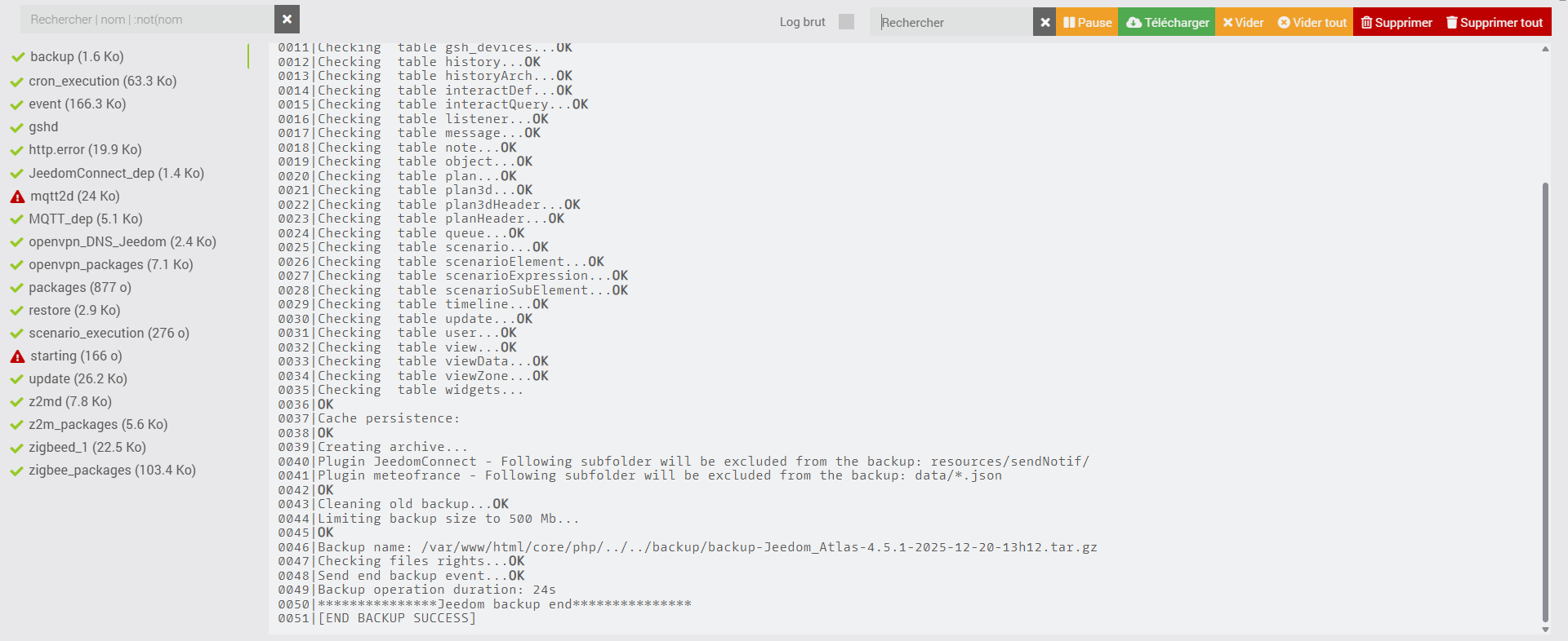

les premiers copier coller des logs je les ai pris ici
et les derniers suivant les instructions qu’on ma donné je les ai pris ici
desolé c’est un peu le bazar j’ai l’impression

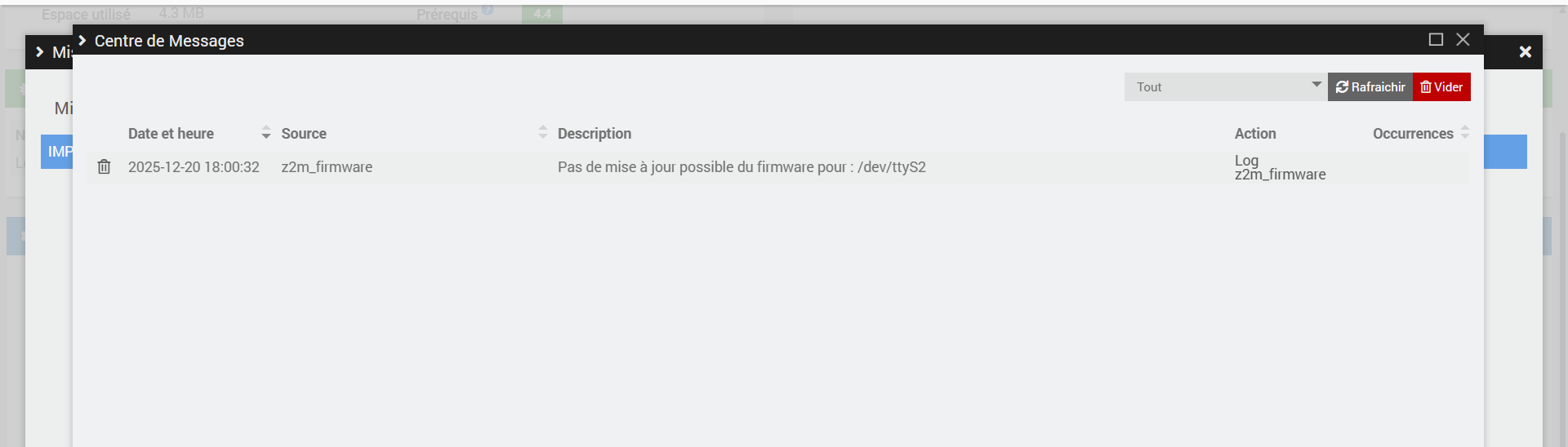

C’est tout de même dommage de ne pas mettre à jour le firmware du contrôleur interne alors que l’installation est neuve
