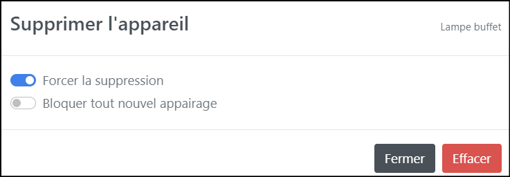

debug 2023-11-18 18:49:12: Received MQTT message on 'zigbee2mqtt/bridge/request/device/remove' with data '{"block":false,"force":false,"id":"0xa4c138f0cec444ca","transaction":"zwivj-5"}'
info 2023-11-18 18:49:12: Removing device '0xa4c138f0cec444ca' (block: false, force: false)

error 2023-11-18 18:49:22: Request 'zigbee2mqtt/bridge/request/device/remove' failed with error: 'Failed to remove device '0xa4c138f0cec444ca' (block: false, force: false) (Error: {"address":3272,"clusterId":32820,"sequence":202} after 10000ms)'
debug 2023-11-18 18:49:22: Error: Failed to remove device '0xa4c138f0cec444ca' (block: false, force: false) (Error: {"address":3272,"clusterId":32820,"sequence":202} after 10000ms)
