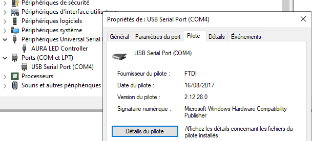

Bonsoir Fabrice,
Oui il est bien reconnu avec la dernière version du pilote :

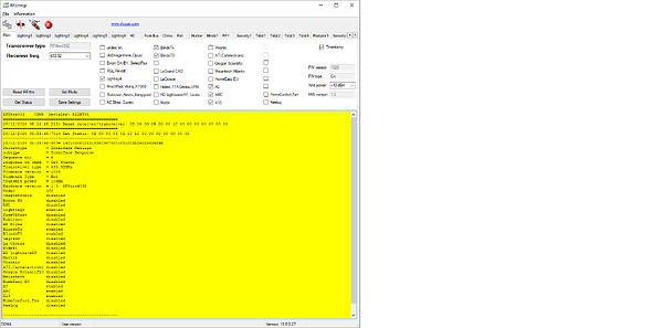

Vous avez quelle version sur le RFXCOM ?
Voici ma version :
Je n’ai rien de cela sous les yeux.
Mais j’étais en 1025 et je suis passé en version conseillé 1049 de mémoire.

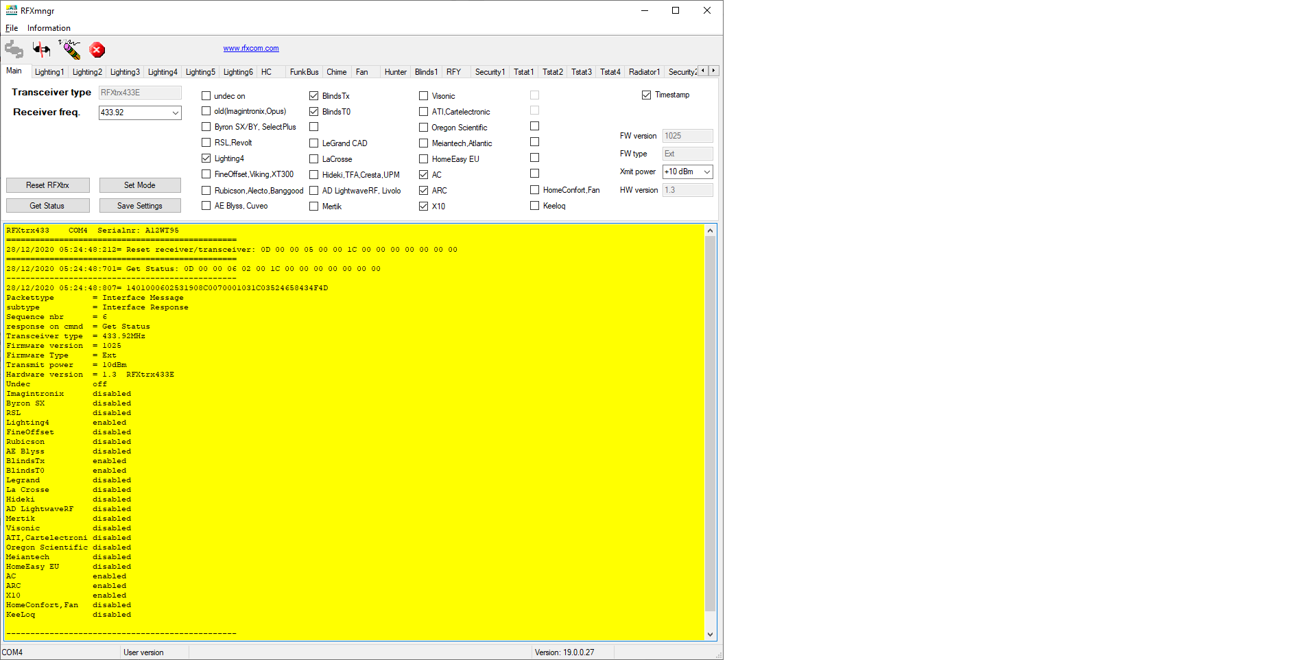

RFXtrx433 COM4 Serialnr: A12WT95
28/12/2020 05:29:29:198= Reset receiver/transceiver: 0D 00 00 08 00 00 1C 00 00 00 00 00 00 00
28/12/2020 05:29:29:687= Get Status: 0D 00 00 09 02 00 1C 00 00 00 00 00 00 00
28/12/2020 05:29:29:793= 1401000902531908C0070001031C03524658434F4D
Packettype = Interface Message
subtype = Interface Response
Sequence nbr = 9
response on cmnd = Get Status
Transceiver type = 433.92MHz
Firmware version = 1025
Firmware Type = Ext
Transmit power = 10dBm
Hardware version = 1.3 RFXtrx433E
Undec off
Imagintronix disabled
Byron SX disabled
RSL disabled
Lighting4 enabled
FineOffset disabled
Rubicson disabled
AE Blyss disabled
BlindsTx enabled
BlindsT0 enabled
Legrand disabled
La Crosse disabled
Hideki disabled
AD LightwaveRF disabled
Mertik disabled
Visonic disabled
ATI,Cartelectroni disabled
Oregon Scientific disabled
Meiantech disabled
HomeEasy EU disabled
AC enabled
ARC enabled
X10 enabled
HomeConfort,Fan disabled
KeeLoq disabled
28/12/2020 05:29:30:344= 1401070A07436F7079726967687420524658434F4D

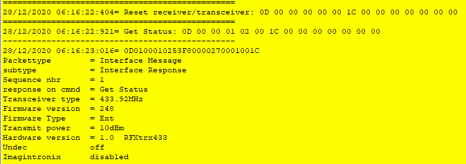

Voici le résultat :
RFXtrx433 COM4 Serialnr: A14ID33Q
28/12/2020 06:30:51:374= Reset receiver/transceiver: 0D 00 00 00 00 00 1C 00 00 00 00 00 00 00
28/12/2020 06:30:51:879= Get Status: 0D 00 00 01 02 00 1C 00 00 00 00 00 00 00
28/12/2020 06:30:51:996= 0D0100010253F80000270001001C
Sequence nbr = 1
Firmware version = 248
Firmware Type = Ext
Hardware version = 1.0 RFXtrx433
Undec off
Byron SX disabled
RSL disabled
Lighting4 disabled
FineOffset disabled
Rubicson disabled
AE Blyss disabled
BlindsTx disabled
BlindsT0 disabled
Legrand disabled
La Crosse disabled
Hideki disabled
Mertik disabled
Visonic disabled
Oregon Scientific enabled
Meiantech disabled
AC enabled
ARC enabled
X10 enabled
KeeLoq disabled
28/12/2020 06:30:52:427= 1401070207436F7079726967687420524658434F4D
