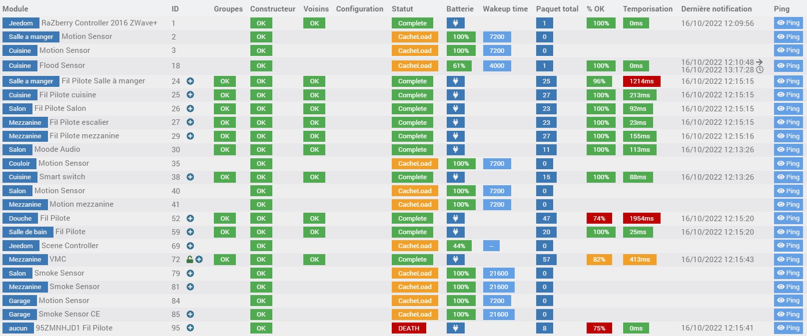

J’essaie l’inclusion de Fil pilote Zwave Qubino, l’inclusion à moins de 1m se passe bien, mais immédiatement aprés le module apparait DEAD

je vois ca dans les logs
2022-10-16 12:36:24.460 Info, Node104, Sending (NoOp) message (Callback ID=0x44, Expected Reply=0x13) - NoOperation_Set (Node=104): 0x01, 0x09, 0x00, 0x13, 0x68, 0x02, 0x00, 0x00, 0x25, 0x44, 0xee
2022-10-16 12:36:24.468 Detail, Node104, Received: 0x01, 0x04, 0x01, 0x13, 0x01, 0xe8
2022-10-16 12:36:24.469 Detail, Node104, ZW_SEND_DATA delivered to Z-Wave stack
2022-10-16 12:36:27.562 Detail, Node104, Received: 0x01, 0x07, 0x00, 0x13, 0x44, 0x01, 0x01, 0x35, 0x9a
2022-10-16 12:36:27.562 Detail, Node104, ZW_SEND_DATA Request with callback ID 0x44 received (expected 0x44)
2022-10-16 12:36:27.562 Info, Node104, WARNING: ZW_SEND_DATA failed. No ACK received - device may be asleep.
2022-10-16 12:36:27.562 Warning, Node104, WARNING: Device is not a sleeping node.

D’après les screens que tu as posté, tu es sur le plugin-zwave !
