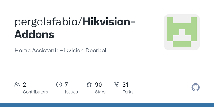

Hey, I have created an addon, not a custom component, because the lib is not compatible for Alpine Linux
I’m updating the addon, to add suppoet for tamper, callstatus, also for opening door, and also to reject/answer the call

Here are my add-ons
It will be updated next week… I can capture anything you want , compatibel with all door intercoms, even 8003
Like , callstatus, tamper alarm, call dismissed ,door opened, door ID opened… Motion…
I can also send commands
Like door 1 or 2 open, or send a command to reject/answer the call…
Will be updated next week, with also RPI support
I updated my repository, added a lot of stuff, also the RPI lib is included…
