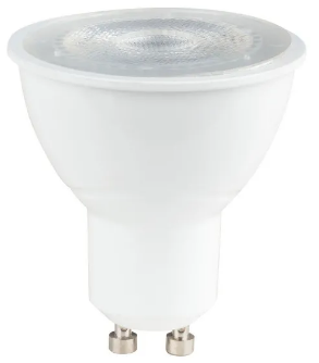

@Loic
Ampoule Lidl GU10 Blanche Livarnolux
Gu10BlancheLidl
    "ieee": "58:8e:81:ff:fe:de:70:56",

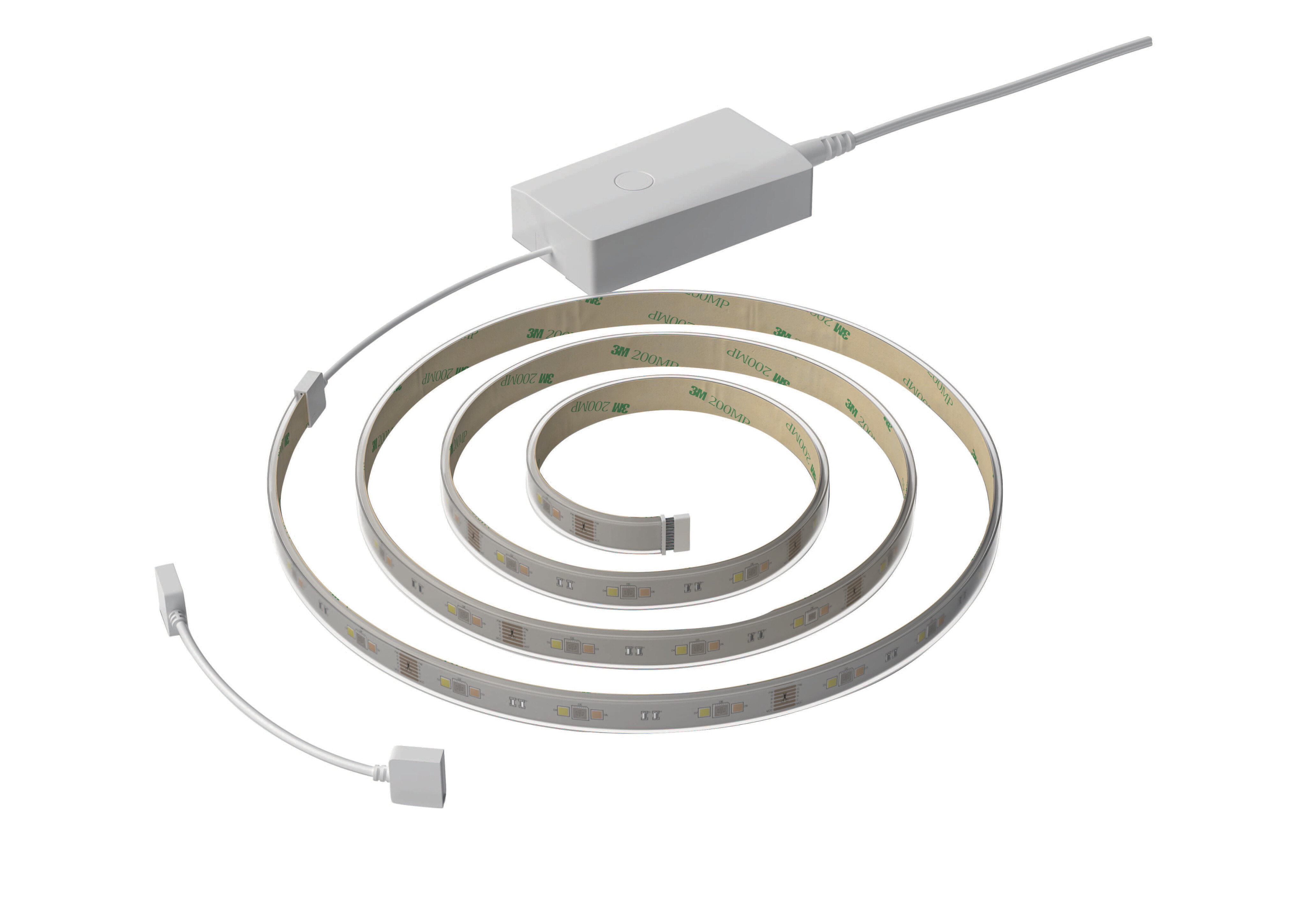

Pour les produits LIDL il ne restera que les E27 et E14 RGB ainsi que le ruban LED mais je ne les ai pas :slight_smile:
Moi non plus…:roll_eyes:
peut être @DamDam44 ?
Bon allé j’arrête de faire le fainéant
Ruban LED LIDL
    "ieee": "58:8e:81:ff:fe:d2:77:fb",

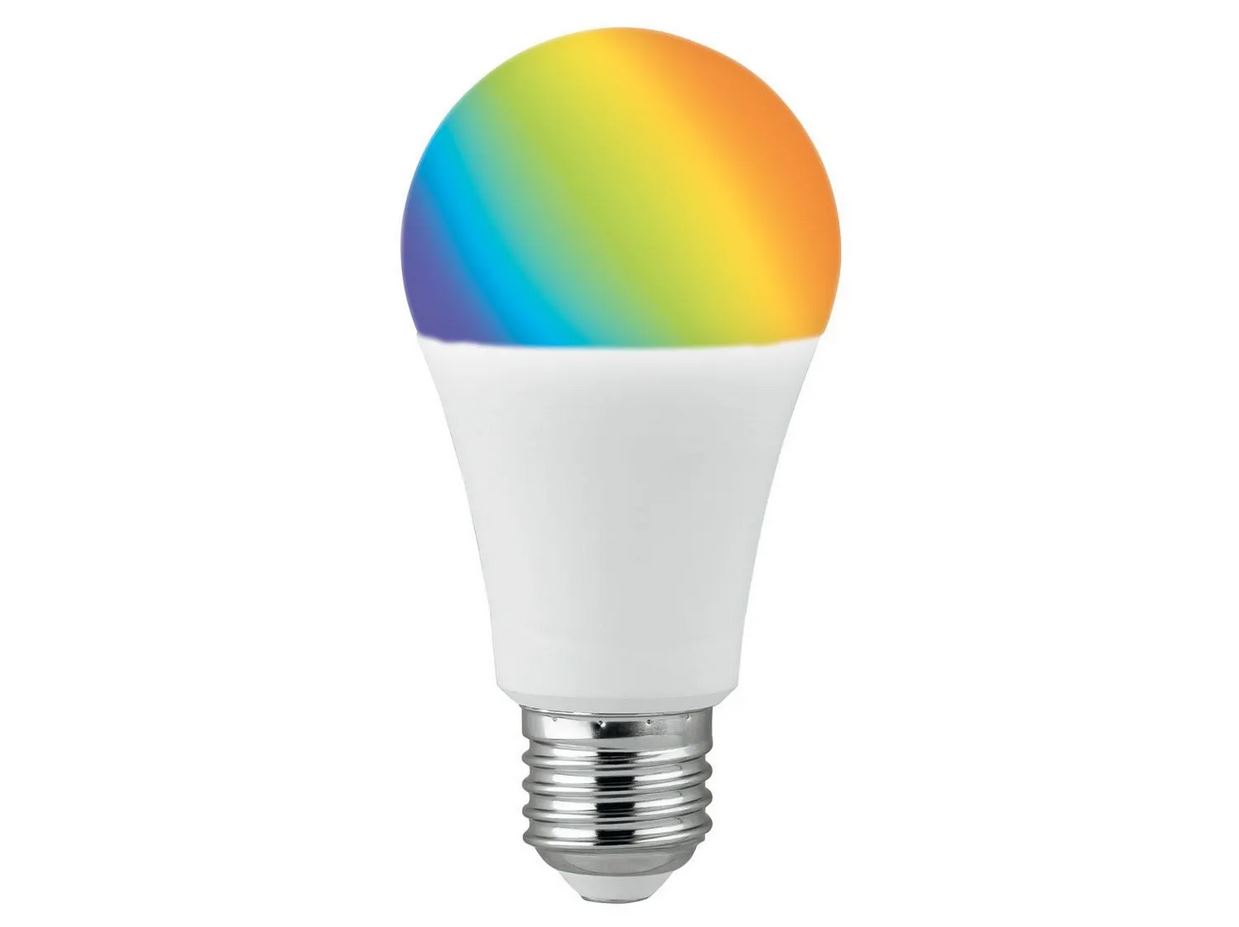

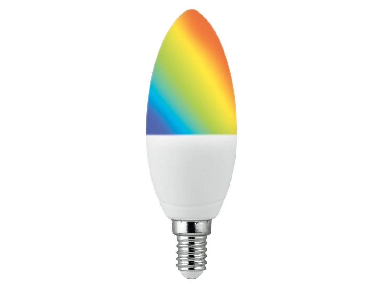

Voici les configurations manquantes pour les ampoules :wink:
Les photos proviennent du site Lidl
D’abord les E14 RGB Lidl
    "ieee": "58:8e:81:ff:fe:d6:1c:f3",

            "manufacturer": null,
            "model": null,
            "output_clusters": [
                    "id": 33,
                    "name": "GreenPowerProxy",
                    "attributes": []
            "input_clusters": []
    "signature": {
        "manufacturer": "_TZ3000_odygigth",
        "model": "TS0505A",
        "node_desc": {
            "byte1": 1,
            "byte2": 64,
            "mac_capability_flags": 142,
            "manufacturer_code": 4098,
            "maximum_buffer_size": 82,
            "maximum_incoming_transfer_size": 82,
            "server_mask": 11264,
            "maximum_outgoing_transfer_size": 82,
        "endpoints": {
            "1": {
                "profile_id": 260,
                "device_type": 269,
                "input_clusters": [
                    0,
                    3,
                    4,
                    5,
                    6,
                    8,
                    768,
                    4096
                    25,
                    10
            "242": {
                "profile_id": 41440,
                "device_type": 97,
                "input_clusters": [],
                    33
    "class": "zigpy.device"
Et voici les données pour les E27 RGB Lidl
    "ieee": "84:2e:14:ff:fe:15:cb:84",
    "nwk": 29647,
    "status": 2,
    "lqi": "103",
    "rssi": "-81",
    "last_seen": "1612176636.9671001",
    "node_descriptor": "01:40:8e:02:10:52:52:00:00:2c:52:00:00",
    "endpoints": [
            "id": 1,
            "status": 1,
            "device_type": 269,
            "profile_id": 260,
            "manufacturer": "_TZ3000_dbou1ap4",
            "model": "TS0505A",
                    "id": 25,
                    "name": "Ota",
                    "attributes": []
                    "id": 10,
                    "name": "Time",
                    "attributes": []
            "input_clusters": [
                    "id": 0,
                    "name": "Basic",
                    "attributes": [
                            "id": 0,
                            "name": "zcl_version",
                            "value": 3
                            "id": 1,
                            "name": "app_version",
                            "value": 80
                            "id": 2,
                            "name": "stack_version",
                            "value": 0
                            "id": 3,
                            "name": "hw_version",
                            "value": 1
                            "id": 4,
                            "name": "manufacturer",
                            "value": "_TZ3000_dbou1ap4"
                            "id": 5,
                            "name": "model",
                            "value": "TS0505A"
                            "id": 6,
                            "name": "date_code",
                            "value": ""
                            "id": 7,
                            "name": "power_source",
                            "value": 1
                    "id": 3,
                    "name": "Identify",
                    "attributes": []
                    "id": 4,
                    "name": "Groups",
                    "attributes": []
                    "id": 5,
                    "name": "Scenes",
                    "attributes": []
                    "id": 6,
                    "name": "On\/Off",
                    "attributes": [
                            "id": 0,
                            "name": "on_off",
                            "value": 1
                    "id": 8,
                    "name": "Level control",
                    "attributes": [
                            "id": 0,
                            "name": "current_level",
                            "value": 255
                    "id": 768,
                    "name": "Color Control",
                    "attributes": [
                            "id": 3,
                            "name": "current_x",
                            "value": 45874
                            "id": 4,
                            "name": "current_y",
                            "value": 19660
                            "id": 7,
                            "name": "color_temperature",
                            "value": 153
                    "id": 4096,
                    "name": "LightLink",
                    "attributes": []
            "id": 242,
            "status": 1,
            "device_type": 97,
            "model": null,
                    "id": 33,
                    "attributes": []
    "signature": {
        "model": "TS0505A",
        "node_desc": {
            "byte1": 1,
            "byte2": 64,
        "endpoints": {
            "1": {
                "profile_id": 260,
                "device_type": 269,
                "input_clusters": [
                    0,
                    3,
                    4,
                    5,
                    6,
                    8,
                    768,
                    4096
                    25,
                    10
            "242": {
                "device_type": 97,
                    33
