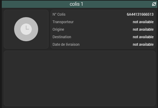

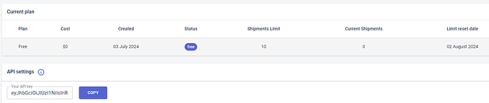

J’ai bien créé un compte sur parcelsapp, récupéré la clé API (dashboard)
mais aucune information remonte

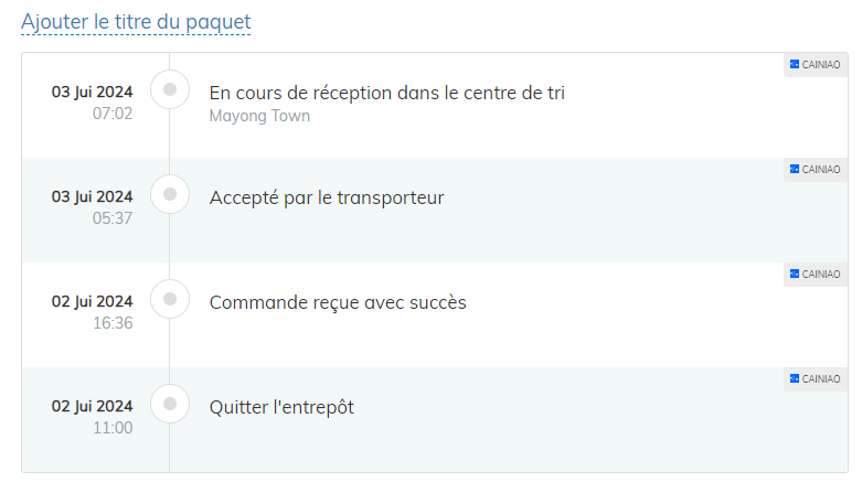

Sur le site
Le log est le suivant :
[2024-07-03 16:38:47][DEBUG] : ┌─Command execution : refresh [2024-07-03 16:38:47][DEBUG] : | Parcel trackingId : 6A44131666513 - Destination country : France - Zipcode : 76150 [2024-07-03 16:38:47][DEBUG] : | Result getTrackingResult() request - step 1 : [200] - {"error":"UNCONFIRMED_ACCOUNT"} [2024-07-03 16:38:47][DEBUG] : | Result getTrackingResult() request - step 2 (0) : [200] - {"error":"MISSING_UUID","description":"No .uuid found"} [2024-07-03 16:38:49][DEBUG] : | Result getTrackingResult() request - step 2 (1) : [200] - {"error":"MISSING_UUID","description":"No .uuid found"} [2024-07-03 16:38:51][DEBUG] : | Result getTrackingResult() request - step 2 (2) : [200] - {"error":"MISSING_UUID","description":"No .uuid found"} [2024-07-03 16:38:53][DEBUG] : | Result getTrackingResult() request - step 2 (3) : [200] - {"error":"MISSING_UUID","description":"No .uuid found"} [2024-07-03 16:38:56][DEBUG] : | Result getTrackingResult() request - step 2 (4) : [200] - {"error":"MISSING_UUID","description":"No .uuid found"} [2024-07-03 16:38:58][DEBUG] : | Result getTrackingResult() request - step 2 (5) : [200] - {"error":"MISSING_UUID","description":"No .uuid found"} [2024-07-03 16:39:00][DEBUG] : | Result getTrackingResult() request - step 2 (6) : [200] - {"error":"MISSING_UUID","description":"No .uuid found"} [2024-07-03 16:39:02][DEBUG] : | Result getTrackingResult() request - step 2 (7) : [200] - {"error":"MISSING_UUID","description":"No .uuid found"} [2024-07-03 16:39:04][DEBUG] : | Result getTrackingResult() request - step 2 (8) : [200] - {"error":"MISSING_UUID","description":"No .uuid found"} [2024-07-03 16:39:06][DEBUG] : | Result getTrackingResult() request - step 2 (9) : [200] - {"error":"MISSING_UUID","description":"No .uuid found"} [2024-07-03 16:39:08][DEBUG] : | Result getTrackingResult() request - step 2 (10) : [200] - {"error":"MISSING_UUID","description":"No .uuid found"} [2024-07-03 16:39:08][DEBUG] : └─End of parcel info refresh : [200]

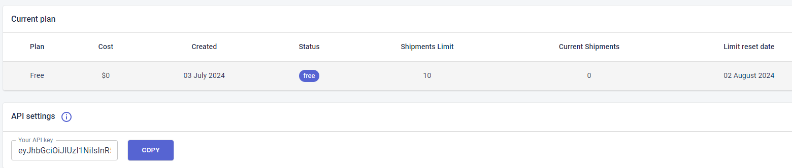

Sur l’onget API de parcelsapp (dashboard) j’ai ça :

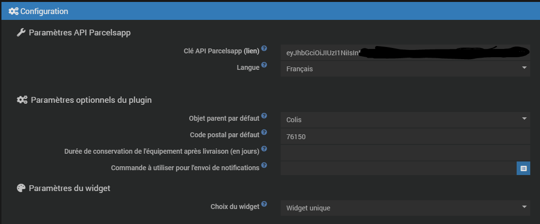

Coté Plugin j’ai ça :

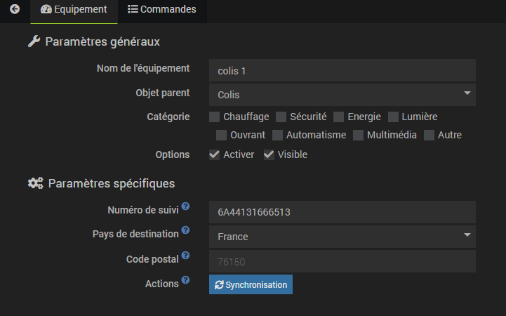

et l’équipement
J’ai peut être fait une mauvaise manip…
Bonne soirée
Hello @Ocbsd
Tu as du recevoir un mail pour confirmer ton compte parcelsapp. Il faut cliquer sur le lien pour que cela fonctionne. Ensuite tu pourras resynchroniser et ca devrait fonctionner ![]()

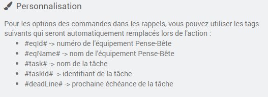

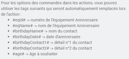

pk tu n’imposes pas les qlq éléments possible
je le fais par exemple sur plugin-birthday ou plugin-remindme , et 0 support sur cette partie là !
permet par exemple :
ou encore
pour :
chacun met finalement le texte qu’il veut, et je remplace seulement les qlq « tag » par les vraies valeur avant l’envoie
