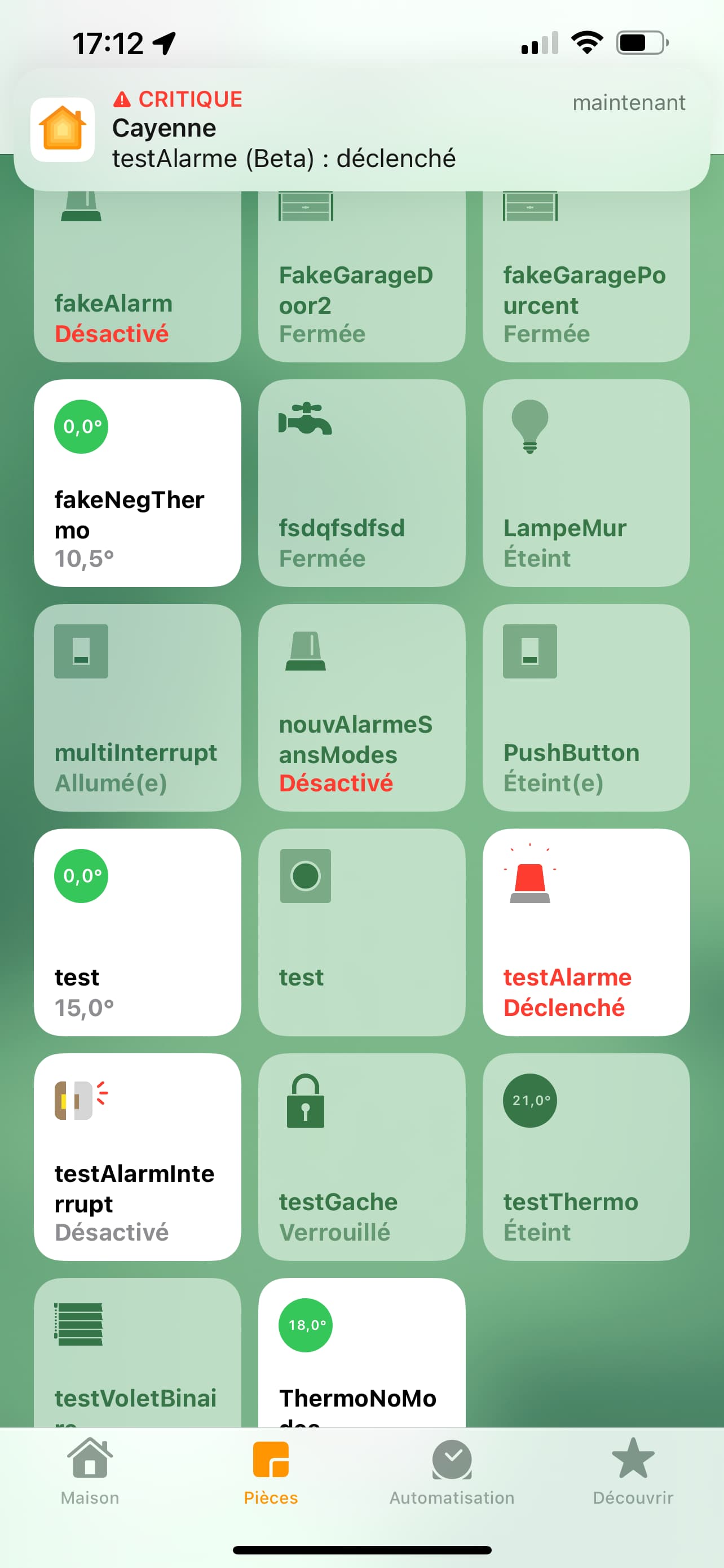

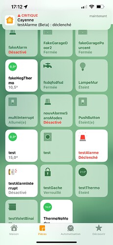

plus assez actif pour garder les regles …
[7/20/2022, 4:55:04 PM] [NEUBOIS] [INFO] [Maj reçue de Jeedom] commande:417 value:1
[7/20/2022, 4:55:04 PM] [NEUBOIS] [INFO] [[Modification Cache Jeedom: Alarme>Actif(ALARM_ENABLE_STATE) de 0 vers 1 dans {"id":"417","logicalId":"enable","generic_type":"ALARM_ENABLE_STATE","eqType":"alarm","name":"Actif","order":"1","type":"info","subType":"binary","eqLogic_id":"58","isVisible":0,"currentValue":0,"configuration":{"phpType":"integer"}}
[7/20/2022, 4:55:04 PM] [NEUBOIS] [INFO] [Maj reçue de Jeedom] commande:423 value:À distance
[7/20/2022, 4:55:04 PM] [NEUBOIS] [INFO] [[Modification Cache Jeedom: Alarme>Mode(ALARM_MODE) de À distance vers À distance dans {"id":"423","logicalId":"mode","generic_type":"ALARM_MODE","eqType":"alarm","name":"Mode","order":"4","type":"info","subType":"string","eqLogic_id":"58","isVisible":1,"currentValue":"À distance","configuration":{"phpType":"string"}}
[7/20/2022, 4:55:04 PM] [NEUBOIS] [INFO] [Commande envoyée à HomeKit] Cause de modif: "Mode" (423) Envoi valeur: 1 dans Security System Current State
[7/20/2022, 4:55:04 PM] [NEUBOIS] [INFO] [Commande envoyée à HomeKit] Cause de modif: "Mode" (423) Envoi valeur: 1 dans Security System Target State
[7/20/2022, 4:57:04 PM] [NEUBOIS] [INFO] [Maj reçue de Jeedom] commande:2211 value:1
[7/20/2022, 4:57:04 PM] [NEUBOIS] [INFO] [[Modification Cache Jeedom: DT Salon Baie AR>Ouverture(OPENING) de 0 vers 1 dans {"id":"2211","logicalId":"01-0006.state::open","generic_type":"OPENING","eqType":"deconz","name":"Ouverture","order":"1","type":"info","subType":"binary","eqLogic_id":"265","isVisible":1,"currentValue":0,"display":{"invertBinary":1},"configuration":{"phpType":"integer"}}
[7/20/2022, 4:57:04 PM] [NEUBOIS] [INFO] [Commande envoyée à HomeKit] Cause de modif: "Ouverture" (2211) Envoi valeur: 1 dans Contact Sensor State
[7/20/2022, 4:57:04 PM] [NEUBOIS] [INFO] [Maj reçue de Jeedom] commande:421 value:1
[7/20/2022, 4:57:04 PM] [NEUBOIS] [INFO] [[Modification Cache Jeedom: Alarme>Statut(ALARM_STATE) de 0 vers 1 dans {"id":"421","logicalId":"state","generic_type":"ALARM_STATE","eqType":"alarm","name":"Statut","order":"5","type":"info","subType":"binary","eqLogic_id":"58","isVisible":1,"currentValue":0,"display":{"invertBinary":1},"configuration":{"phpType":"integer"}}
[7/20/2022, 4:57:04 PM] [NEUBOIS] [INFO] [Commande envoyée à HomeKit] Cause de modif: "Statut" (421) Envoi valeur: 1 dans Security System Current State
[7/20/2022, 4:57:04 PM] [NEUBOIS] [INFO] [Commande envoyée à HomeKit] Cause de modif: "Statut" (421) Envoi valeur: 1 dans Security System Target State
