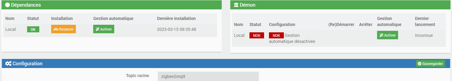

j’ai essayé de relancer le demon pour voir si la vignette de la prise remontait dans jeedom et plus moyen
> node index.js
Zigbee2MQTT:debug 2023-03-06 11:45:38: Loaded state from file /var/www/html/plugins/z2m/data/state.json
Zigbee2MQTT:info  2023-03-06 11:45:38: Logging to console and directory: '/var/www/html/plugins/z2m/data/log/2023-03-06.11-45-38' filename: log.txt
Zigbee2MQTT:debug 2023-03-06 11:45:38: Removing old log directory '/var/www/html/plugins/z2m/data/log/2023-03-03.23-22-11'
Zigbee2MQTT:info  2023-03-06 11:45:38: Starting Zigbee2MQTT version 1.30.1 (commit #eb878d3)
Zigbee2MQTT:info  2023-03-06 11:45:38: Starting zigbee-herdsman (0.14.89)
Zigbee2MQTT:debug 2023-03-06 11:45:38: Using zigbee-herdsman with settings: '{"adapter":{"concurrent":null,"delay":null,"disableLED":false},"backupPath":"/var/www/html/plugins/z2m/data/coordinator_backup.json","databaseBackupPath":"/var/www/html/plugins/z2m/data/database.db.backup","databasePath":"/var/www/html/plugins/z2m/data/database.db","network":{"channelList":[11],"extendedPanID":[221,221,221,221,221,221,221,221],"networkKey":"HIDDEN","panID":6754},"serialPort":{"adapter":"ezsp","path":"/dev/ttyACM0"}}'
Zigbee2MQTT:error 2023-03-06 11:45:44: Error while starting zigbee-herdsman
Zigbee2MQTT:error 2023-03-06 11:45:44: Failed to start zigbee
Zigbee2MQTT:error 2023-03-06 11:45:44: Check https://www.zigbee2mqtt.io/guide/installation/20_zigbee2mqtt-fails-to-start.html for possible solutions
Zigbee2MQTT:error 2023-03-06 11:45:44: Exiting...
Zigbee2MQTT:error 2023-03-06 11:45:44: Error: Failure send getNetworkParameters:{"type":"Buffer","data":[27,0,1,40,0]}
at /var/www/html/plugins/z2m/resources/zigbee2mqtt/node_modules/zigbee-herdsman/src/adapter/ezsp/driver/ezsp.ts:529:23
at Queue.executeNext (/var/www/html/plugins/z2m/resources/zigbee2mqtt/node_modules/zigbee-herdsman/src/utils/queue.ts:32:32)
Edit : j’ai relancé les dépendance et le démon est reparti. Par contre meme lorsque le demon ne tourne pas il reste vert OK
Relancer le demon pour le soucis d’image ne sert absolument a rien c’est pas comme ca que jeedom la recupere.
Pour le status il faut parfois attendre ca peut mettre jusqu’a 5min a remonter c’est normal.
A mon avis ton soucis vient plus de la clef qui ne répondait pas correctement attendre aurait surement suffit.

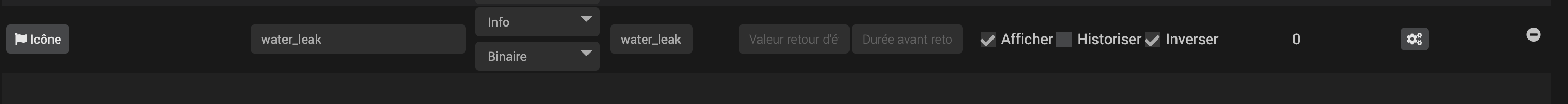

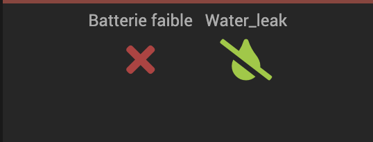

je ne sais pas si ca a une importance pour pour le detecteur d’inondation xiaomi, il faut cliquer sur inverser pour que l’icone corresponde
Ce genre de cas ça sera dans une prochaine version quand on aura mis en place le système de configuration spécifique par module au lieu du système automatique.

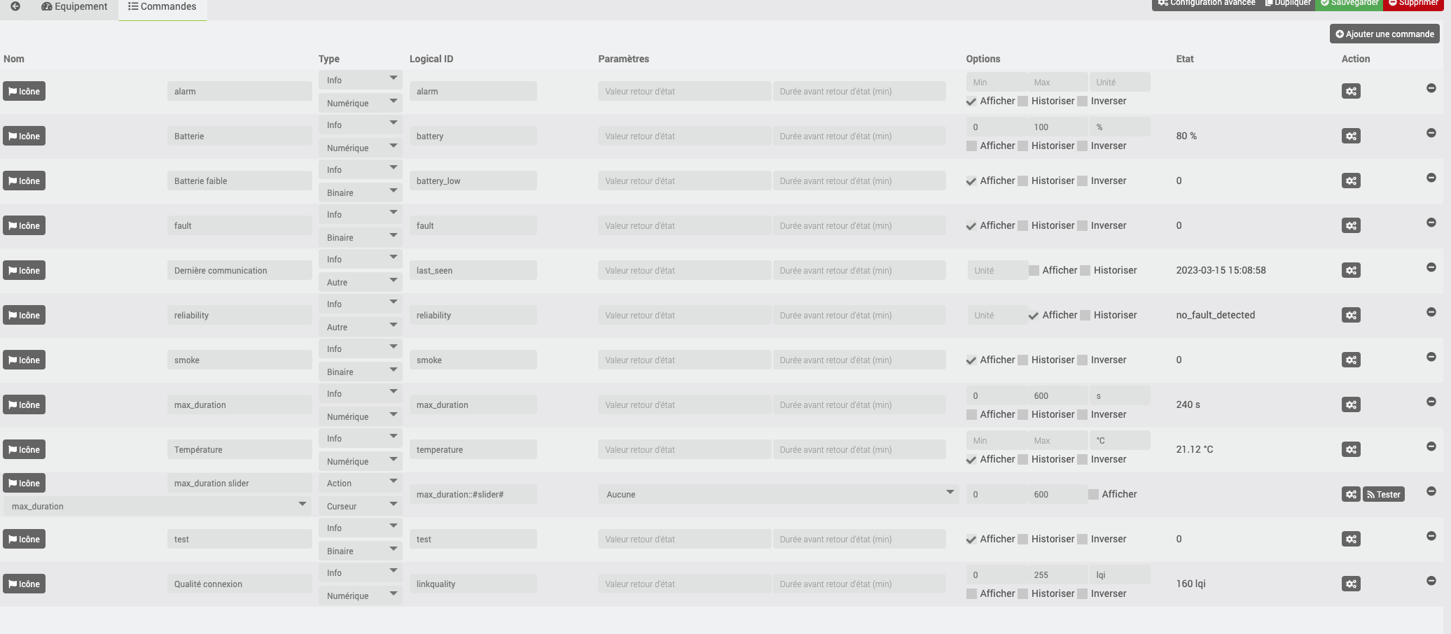

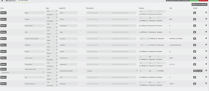

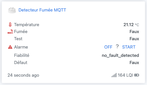

Bonjour Loic,
JE viens d’integrer un detecteur de chaleur Frient, il y a une commande alarme qui remonte en info sur le plug in alors que sur Z2m C’est une action pour déclencher l’alarme et l’arreter.
Les infios dans Z2m
    "battery": 80,
    "battery_low": false,
    "enrolled": true,
    "fault": false,
    "ias_cie_address": "0xdc8e95fffe00b0a0",
    "last_seen": "2023-03-15T14:10:50.704Z",
    "linkquality": 164,
    "max_duration": 240,
    "reliability": "no_fault_detected",
    "restore_reports": true,
    "smoke": false,
    "supervision_reports": true,
    "temperature": 21.12,
    "test": false,
    "voltage": 2900,
    "zone_id": 23,
    "device": {
        "dateCode": "2021-01-26 02:49",
        "friendlyName": "Detecteur Fumée MQTT",
        "hardwareVersion": "5.0.2",
        "ieeeAddr": "0x0015bc0034000c90",
        "manufacturerID": 4117,
        "manufacturerName": "frient A/S",
        "model": "HESZB-120",
        "networkAddress": 50261,
        "powerSource": "Battery",
        "softwareBuildID": "3.4.25",
        "type": "EndDevice",
        "zclVersion": 1
voici les informations brutes dans jeedom

J’ai des alertes de demon z2m ko mais je pense que c’est normal, il n’y a pas de demon de lancé dans ce cas là ?
Est-ce que la conf si dessous est ok ? Je ne sais pas ce que je dois mettre pour les dépendances en gestion auto et pour le démon, pour moi, il ne faut pas l’activer si on utilise mqtt.
