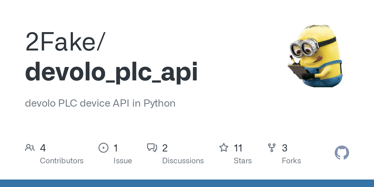

Je viens de voir qu’une version 1 de l’API pour attaquer les prise CPLs Devolo (WIFI) était sortie :
J’ai reussi assez facilement à recuperer des infos de mes Devolos :

Le script que j’ai fait :
import sys
from devolo_plc_api import Device
# IP of the device to query
IP = sys.argv[1]
# Password, if the device has one. It is the same as the Web-UI has. It no password is set, you can remove the password
# parameter or set it to None.
PASSWORD = "None"
def run():
with Device(ip=IP) as dpa:
# Set the password
dpa.password = PASSWORD
network = dpa.plcnet.get_network_overview()
connected_stations = dpa.device.get_wifi_connected_station()
print('----------------------------------------------------------')
print("NB clients WIFI :",len(connected_stations))
for i in range(0, len(connected_stations), 1):
print(' *', connected_stations[i].mac_address)
print("")
print("Prises DEVOLO voisines :",len(network.devices))
for i in range(0, len(network.devices), 1):
print(" *",network.devices[i].user_device_name,"(",network.devices[i].product_name,") --> TX :",round(network.data_rates[i].tx_rate),"Mbits, RX :",round(network.data_rates[i].rx_rate),"Mbits")
if __name__ == "__main__":
run()
