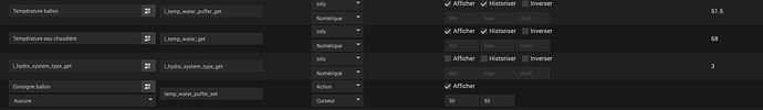

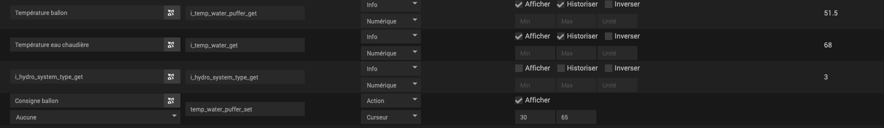

{‹ app_image_name ›: ‹ default ›, ‹ reg_key ›: ‹ temp_water_puffer_enable ›, ‹ reg_name ›: ‹ Abilitazione Temperatura Puffer ›, ‹ reg_name_app ›: ‹ Temp. Puffer Set ›, ‹ reg_key_group ›: ‹ temp_water_puffer ›, ‹ reg_type ›: ‹ ENABLE ›, ‹ offset ›: 32828, ‹ eeprom ›: True, ‹ is_word ›: False, ‹ big_endian ›: False, ‹ formula ›: ‹ # ›, ‹ formula_inverse ›: ‹ # ›, ‹ format_string ›: ‹ {0} ›, ‹ set_min ›: 0, ‹ set_max ›: 3, ‹ readonly ›: False, ‹ mask ›: 65535, ‹ is_hex ›: False, ‹ is_temperature ›: False, ‹ use_app ›: True, ‹ display_dashboard ›: False, ‹ display_manage ›: False, ‹ display_info ›: False, ‹ use_cat ›: True, ‹ display_order ›: 0, ‹ step ›: 1, ‹ use_history ›: True, ‹ use_history_output ›: True, ‹ with_sign ›: False, ‹ from_char_code ›: False, ‹ notify_on_change ›: False, ‹ is_test ›: False, ‹ enable_val ›: [{‹ value ›: 3}]}, {‹ app_image_name ›: ‹ default ›, ‹ reg_key ›: ‹ temp_water_puffer_get ›, ‹ reg_name ›: ‹ Temperatura Puffer ›, ‹ reg_name_app ›: ‹ Temp. puffer ›, ‹ reg_key_group ›: ‹ temp_water_puffer ›, ‹ reg_type ›: ‹ GET ›, ‹ offset ›: 74, ‹ eeprom ›: False, ‹ is_word ›: False, ‹ big_endian ›: False, ‹ formula ›: ‹ #/2 ›, ‹ formula_inverse ›: ‹ #*2 ›, ‹ format_string ›: ‹ {0} °C ›, ‹ set_min ›: 0, ‹ set_max ›: 255, ‹ readonly ›: False, ‹ mask ›: 65535, ‹ is_hex ›: False, ‹ is_temperature ›: False, ‹ use_app ›: True, ‹ display_dashboard ›: True, ‹ display_manage ›: False, ‹ display_info ›: True, ‹ use_cat ›: True, ‹ display_order ›: 0, ‹ step ›: 1, ‹ use_history ›: True, ‹ use_history_output ›: True, ‹ with_sign ›: False, ‹ from_char_code ›: False, ‹ notify_on_change ›: False, ‹ is_test ›: False}, {‹ app_image_name ›: ‹ default ›, ‹ reg_key ›: ‹ temp_water_puffer_set ›, ‹ reg_name ›: ‹ Set Temperatura Puffer ›, ‹ reg_name_app ›: ‹ Temp. Puffer Set ›, ‹ reg_key_group ›: ‹ temp_water_puffer ›, ‹ reg_type ›: ‹ SET ›, ‹ offset ›: 32899, ‹ eeprom ›: True, ‹ is_word ›: False, ‹ big_endian ›: False, ‹ formula ›: ‹ # ›, ‹ formula_inverse ›: ‹ # ›, ‹ format_string ›: ‹ {0} ›, ‹ set_min ›: 40, ‹ set_max ›: 75, ‹ readonly ›: False, ‹ mask ›: 65535, ‹ is_hex ›: False, ‹ is_temperature ›: False, ‹ use_app ›: True, ‹ display_dashboard ›: False, ‹ display_manage ›: True, ‹ display_info ›: False, ‹ use_cat ›: True, ‹ display_order ›: 0, ‹ step ›: 1, ‹ use_history ›: True, ‹ use_history_output ›: True, ‹ with_sign ›: False, ‹ from_char_code ›: False, ‹ notify_on_change ›: False, ‹ is_test ›: False}, {‹ app_image_name ›: ‹ default ›, ‹ reg_key ›: ‹ temp_water_set ›,
Que j’utilise boiler ou puffer, la valeur ne remonte pas :

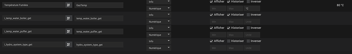

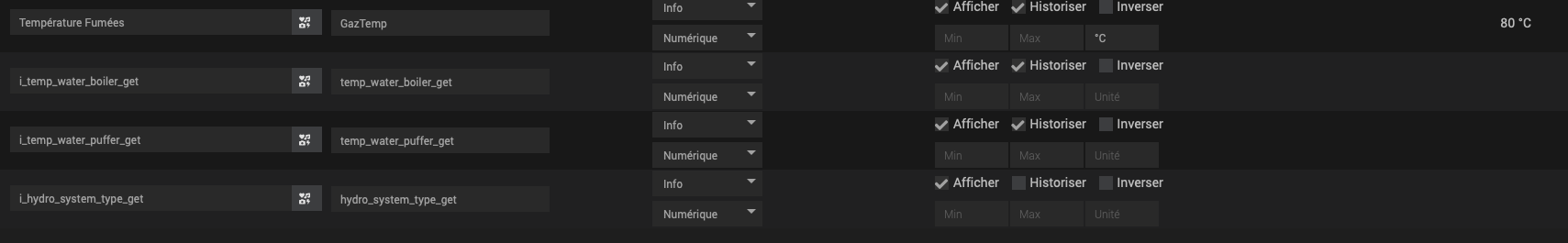

Bonjour, comme écrit dans la doc, il faut mettre « i_ » devant le nom de la commande.
Nom de la commande = le nom que vous souhaitez voir s’afficher dans le plugin. Dans cet exemple : Puissance ventilateur Commande = i_ + le retour d’état de votre poêle identifié précédemment que vous voulez voir.
Cordialement
Je pensais que le nom était libre et que vous mettiez un i par convenance personnelle, ce n’est pas clair clair.
Mais cela ne change rien :frowning_face:
Voila ça remonte !
Il lui fallait un peu de temps…
Merci infiniment
Donc pour le Nom on met ce que l’on veut et pour ce que vous appelez Commande il s’agit de « LogicalID » dans l’interface Jeedom et c’est là qu’il faut mettre le i_

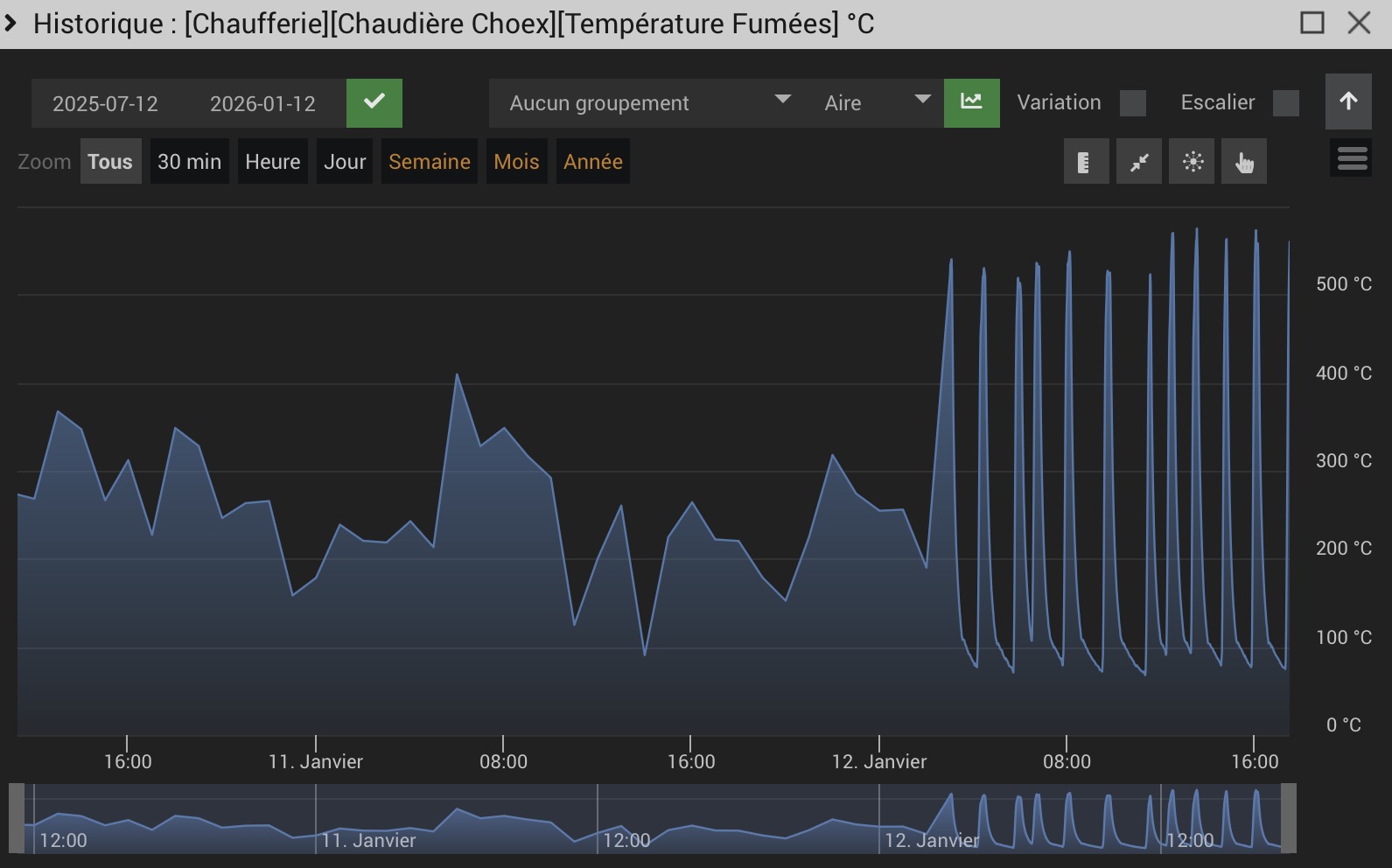

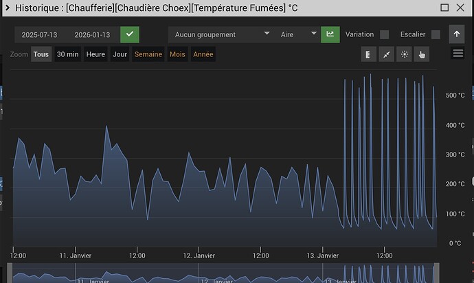

Nouveau truc bizarre, les chiffres de l’historique d’une valeur (température flamme) sont juste le jour même, mais le lendemain ils sont abaissés :
Une idée ?
Problème résolu !
Paramètres de l’historique où par défaut il lisse la courbe avec des moyennes.
En modifiant la courbe c’est OK
