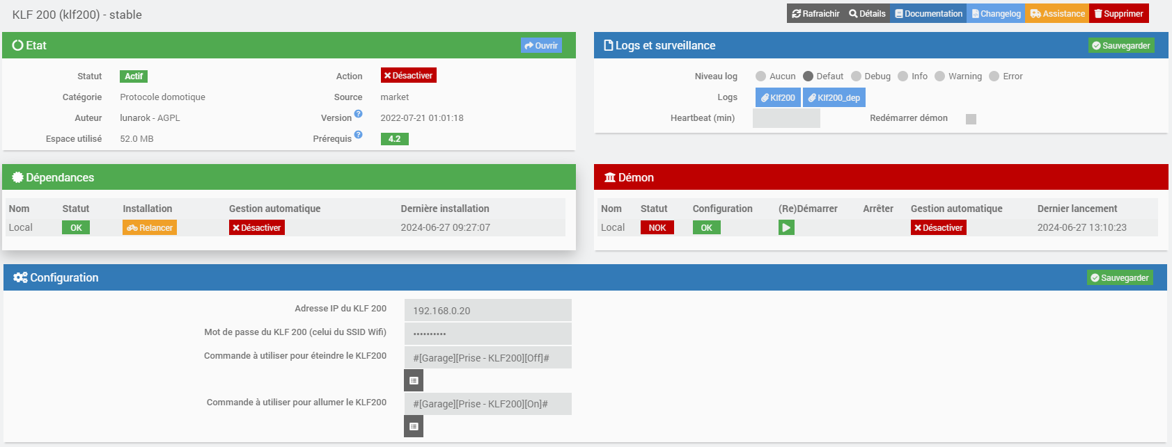

J’ai beaucoup de plugin qui sont apparus en erreur et notamment celui du KLF200 qui pilote mes volets.
Le demon n’arrive pas à se lancer.
J’ai réinstallé le plugin mais ceci n’a rien changé.
Auriez-vous une idée SVP ?
Merci par avance

27/06/2024 09:27:07 Installation des dépendances
Hit:1 http://security.debian.org/debian-security bullseye-security InRelease
Hit:2 http://deb.debian.org/debian bullseye InRelease
Hit:3 http://deb.debian.org/debian bullseye-updates InRelease
Hit:4 https://deb.nodesource.com/node_18.x nodistro InRelease
Reading package lists...
Installation des dépendances apt
Building dependency tree...
Reading state information...
python3-dev is already the newest version (3.9.2-3).
python3-venv is already the newest version (3.9.2-3).
0 upgraded, 0 newly installed, 0 to remove and 0 not upgraded.
WARNING: The directory '/var/www/.cache/pip' or its parent directory is not owned or is not writable by the current user. The cache has been disabled. Check the permissions and owner of that directory. If executing pip with sudo, you may want sudo's -H flag.
Requirement already satisfied: pyvlx in /var/www/html/plugins/klf200/resources/venv/lib/python3.9/site-packages (0.2.20)
Requirement already satisfied: PyYAML in /var/www/html/plugins/klf200/resources/venv/lib/python3.9/site-packages (from pyvlx) (5.4.1)
Requirement already satisfied: aiohttp==3.7.4.post0 in /var/www/html/plugins/klf200/resources/venv/lib/python3.9/site-packages (3.7.4.post0)
Requirement already satisfied: async-timeout<4.0,>=3.0 in /var/www/html/plugins/klf200/resources/venv/lib/python3.9/site-packages (from aiohttp==3.7.4.post0) (3.0.1)
Requirement already satisfied: chardet<5.0,>=2.0 in /var/www/html/plugins/klf200/resources/venv/lib/python3.9/site-packages (from aiohttp==3.7.4.post0) (4.0.0)
Requirement already satisfied: typing-extensions>=3.6.5 in /var/www/html/plugins/klf200/resources/venv/lib/python3.9/site-packages (from aiohttp==3.7.4.post0) (4.12.2)
Requirement already satisfied: yarl<2.0,>=1.0 in /var/www/html/plugins/klf200/resources/venv/lib/python3.9/site-packages (from aiohttp==3.7.4.post0) (1.9.4)
Requirement already satisfied: attrs>=17.3.0 in /var/www/html/plugins/klf200/resources/venv/lib/python3.9/site-packages (from aiohttp==3.7.4.post0) (23.2.0)
Requirement already satisfied: multidict<7.0,>=4.5 in /var/www/html/plugins/klf200/resources/venv/lib/python3.9/site-packages (from aiohttp==3.7.4.post0) (6.0.5)
Requirement already satisfied: idna>=2.0 in /var/www/html/plugins/klf200/resources/venv/lib/python3.9/site-packages (from yarl<2.0,>=1.0->aiohttp==3.7.4.post0) (3.7)
Collecting PyYAML==5.4.1
Downloading PyYAML-5.4.1-cp39-cp39-manylinux1_x86_64.whl (630 kB)
Installing collected packages: PyYAML
Attempting uninstall: PyYAML
Found existing installation: PyYAML 5.4.1
Uninstalling PyYAML-5.4.1:
Successfully uninstalled PyYAML-5.4.1
Successfully installed PyYAML-5.4.1
Requirement already satisfied: bottle in /var/www/html/plugins/klf200/resources/venv/lib/python3.9/site-packages (0.12.25)
27/06/2024 09:27:13 Installation terminée
