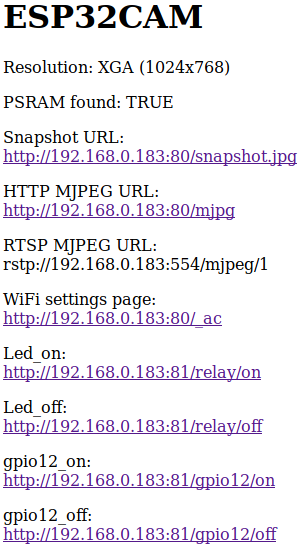

  String reply = F("<!doctype html><html><H1>ESP32CAM</H1>");
  reply += F("<p>Resolution: ");
  switch(RESOLUTION) {
    case FRAMESIZE_QVGA:
     reply += F("QVGA (320x240)");
    break;
    case FRAMESIZE_CIF:
     reply += F("CIF (400x296)");
    break;
    case FRAMESIZE_VGA:
     reply += F("VGA (640x480)");
    break;
    case FRAMESIZE_SVGA:
     reply += F("SVGA (800x600)");
    break;
    case FRAMESIZE_XGA:
     reply += F("XGA (1024x768)");
    break;
    case FRAMESIZE_SXGA:
     reply += F("SXGA (1280x1024)");
    break;
    case FRAMESIZE_UXGA:
     reply += F("UXGA (1600x1200)");
    break;
    default:
     reply += F("Unknown");
    break;
  reply += F("<p>PSRAM found: ");
  if (psramFound()){
   reply += F("TRUE");
  } else {
   reply += F("FALSE");
  String IP = WiFi.localIP().toString();
  String IPH = "http://" + IP + ":" + WSPORT;
  String IPA = "http://" + IP + ":" + ASYNCPORT;
  String IPR = "rstp://" + IP + ":554";
  String url = IPH + "/snapshot.jpg";
  reply += "<p>Snapshot URL:<br> <a href='" + url + "'>" + url + "</a>";
  url = IPH + "/mjpg";
  reply += "<p>HTTP MJPEG URL:<br> <a href='" + url + "'>" + url + "</a>";
  url =  IPR + "/mjpeg/1";
  reply += "<p>RTSP MJPEG URL:<br> " + url;
  url =  IPH + "/_ac";
  reply += "<p>WiFi settings page:<br> <a href='" + url + "'>" + url + "</a>";
  //LED
  url =  IPA + "/relay/on";
  reply += "<p>Led_on:<br> <a href='" + url + "'>" + url + "</a>";
  url =  IPA + "/relay/off";
  reply += "<p>Led_off:<br> <a href='" + url + "'>" + url + "</a>";
  //GPIO12
  url =  IPA + "/gpio12/on";
  reply += "<p>gpio12_on:<br> <a href='" + url + "'>" + url + "</a>";
  url =  IPA + "/gpio12/off";
  reply += "<p>gpio12_off:<br> <a href='" + url + "'>" + url + "</a>";
  reply += F("</body></html>");
  server.send(200, "text/html", reply);

Bon voila la version 1.7 un peut de présentation sur la page … tableau et css …
CODE V1.7

  String reply ="<style>th, td {border: 1px solid black;}table {border-collapse: collapse;}</style>";
  reply +=F("<!doctype html><html><table><tr><td colspan='2'><H1>ESP32CAM</H1></td></tr>");
  reply += F("<tr><td>Resolution</td>");
     reply += F("<td>QVGA (320x240)</td>");
    break;
    case FRAMESIZE_CIF:
     reply += F("<td>CIF (400x296)</td>");
    break;
    case FRAMESIZE_VGA:
     reply += F("<td>VGA (640x480)</td>");
    break;
     reply += F("<td>SVGA (800x600)</td>");
    break;
    case FRAMESIZE_XGA:
     reply += F("<td>XGA (1024x768)</td>");
    break;
     reply += F("<td>SXGA (1280x1024)</td>");
    break;
     reply += F("<td>UXGA (1600x1200)</td>");
    break;
    default:
     reply += F("<td>Unknown</td>");
    break;
  reply += F("</tr><tr><td>PSRAM found</td>");
  if (psramFound()){
   reply += F("<td>TRUE</td></tr>");
  } else {
   reply += F("<td>FALSE</td></tr></tr>");
  reply += "<tr><td>Snapshot URL</td><td><a href='" + url + "'>" + url + "</a></td></tr>";
  reply += "<tr><td>HTTP MJPEG URL</td><td><a href='" + url + "'>" + url + "</a></td></tr>";
  reply += "<tr><td>RTSP MJPEG URL</td><td>" + url;
  url =  IPH + "/_ac";
  reply += "<tr><td>WiFi settings page</td><td><a href='" + url + "'>" + url + "</a></td></tr>";
  //LED
  reply += "<tr><td>Led_on</td><td><a href='" + url + "'>" + url + "</a></td></tr>";
  reply += "<tr><td>Led_off</td><td><a href='" + url + "'>" + url + "</a></td></tr>";
  url =  IPA + "/relay/toggle";
  reply += "<tr><td>Led_toggle</td><td><a href='" + url + "'>" + url + "</a></td></tr>";
  url =  IPA + "/relay";
  reply += "<tr><td>Led_etat</td><td><a href='" + url + "'>" + url + "</a></td></tr>";
  //GPIO12
  reply += "<tr><td>gpio12_on</td><td><a href='" + url + "'>" + url + "</a></td></tr>";
  reply += "<tr><td>gpio12_off</td><td><a href='" + url + "'>" + url + "</a></td></tr>";
  url =  IPA + "/gpio12/toggle";
  reply += "<tr><td>gpio12_toggle</td><td><a href='" + url + "'>" + url + "</a></td></tr>";
  url =  IPA + "/gpio12";
  reply += "<tr><td>gpio12_etat</td><td><a href='" + url + "'>" + url + "</a></td></tr>";
  reply += F("</table></body></html>");

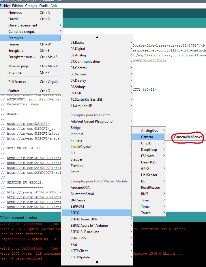

Heuuuu, tant que tu es bien parti… tu arriverais à intégrer les réglages d’image directement dans le serveur comme dans l’exemple présent sur Arduino (juste les paramètres basiques, pas la reconnaissance faciale, bien sûr) ?
ben donne moi les sources de tes exemples arduino que je perde pas trop de temps.
C’est là :
Ha oui j’avais pas vue c’est bien ça …

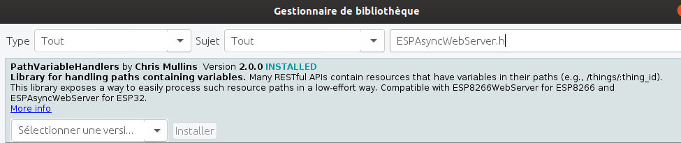

Je mettrai à jour le tuto avec les deux bibliothèques à ajouter.

Pour les futures versions je suggère de renommer « relay » en « led ». Pour éviter les confusions.
Voilà relay remplacé par led

Finalement j’ai pris le temps de remplacer mon .ino d’origine avec votre code.
Je suis sous Linux et arduino ide 1.8.9.
J’ai un pb avec l’include ESPAsyncWebServer.h :
error: ESPAsyncWebServer.h: No such file or directory
J’ai cherché dans le Gestionnaire de bibli et il m’a proposé ça :
que j’ai installé en étant bien sur la carte ESP32 Wrover.
Mais toujours pb de compilation et lorsque je cherche le fichier ESPAsyncWebServer.h via explorateur, il ne le trouve nul part.
Quelqu’un aurait une idée ?
