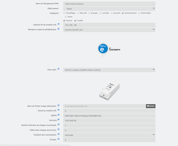

voici ma config :
sonoff2
Merci !
→ création max des commandes pour avoir disco qui devrait le faire sinon revenir vers moi avec les logs :
_cmd quand le plugin envoie les commandes
wifilightV2 quand l’appli ewelink monte/descend/arrête le volet

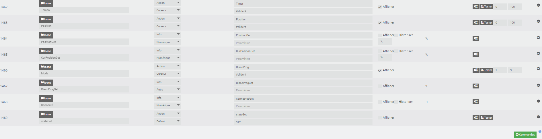

J’ai testé toutes les commandes proposées ci-dessous , aucune n’ouvre ou ferme le volet ( sur l’appli Ewelink ça marche tres bien) .
Pourtant le module semble bien configuré :
sourrire
Voici les logs ( j’ai mis en mode debug dans le gestionnaire de plugin car sinon j’ai pas de log)
0000|[2022-10-24 07:06:37]DEBUG : Cmd : {"switches":[{"outlet":-1,"switch":"on"}]} - full Cmd : {"sequence":"156958807731","deviceid":"10012ba16b","selfApikey":"00000000-0000-0000-0000-000000000000","iv":"OTA0ODgxODA0OTIyNzgwMw==","encrypt":true,"data":"LHiVYhvj0Mu19hnRyhxP0jGFXOpNBaObFlCeoD5Za9vOAfhng3E1TKkMNfm76Db2"} - Rec:{"sequence":"","seq":93,"error":400,"encrypt":true}
0001|[2022-10-24 07:06:42]DEBUG : Cmd : {"switches":[{"outlet":-1,"switch":"off"}]} - full Cmd : {"sequence":"156958807731","deviceid":"10012ba16b","selfApikey":"00000000-0000-0000-0000-000000000000","iv":"OTA0ODgxODA0OTIyNzgwMw==","encrypt":true,"data":"LHiVYhvj0Mu19hnRyhxP0jGFXOpNBaObFlCeoD5Za9uZw68MLdyahHX4PkT/Ql8q"} - Rec:{"sequence":"","seq":93,"error":400,"encrypt":true}
0002|[2022-10-24 07:06:48]DEBUG : Cmd : {"configure":[{"outlet":-1,"startup":"stay"}]} - full Cmd : {"sequence":"156958807731","deviceid":"10012ba16b","selfApikey":"00000000-0000-0000-0000-000000000000","iv":"OTA0ODgxODA0OTIyNzgwMw==","encrypt":true,"data":"sYMoIneZlIIolaCHnrjGZb8yXQ1gTgfylvqN97gLvlyHamwpg/wuaqXRN11N2b7Q"} - Rec:{"sequence":"156958807731","seq":93,"error":400,"encrypt":true}
0003|[2022-10-24 07:06:53]DEBUG : Cmd : {"configure":[{"outlet":-1,"startup":"on"}]} - full Cmd : {"sequence":"156958807731","deviceid":"10012ba16b","selfApikey":"00000000-0000-0000-0000-000000000000","iv":"OTA0ODgxODA0OTIyNzgwMw==","encrypt":true,"data":"sYMoIneZlIIolaCHnrjGZb8yXQ1gTgfylvqN97gLvlxB//hQXfLkz/IFi2vL16zp"} - Rec:{"sequence":"156958807731","seq":93,"error":400,"encrypt":true}
0004|[2022-10-24 07:06:54]DEBUG : Cmd : {"configure":[{"outlet":-1,"startup":"off"}]} - full Cmd : {"sequence":"156958807731","deviceid":"10012ba16b","selfApikey":"00000000-0000-0000-0000-000000000000","iv":"OTA0ODgxODA0OTIyNzgwMw==","encrypt":true,"data":"sYMoIneZlIIolaCHnrjGZb8yXQ1gTgfylvqN97gLvly0+zQFzBLwCyqNnKIIl+Ah"} - Rec:{"sequence":"156958807731","seq":93,"error":400,"encrypt":true}
0005|[2022-10-24 07:06:56]DEBUG : Cmd : {"pulses":[{"outlet":-1,"pulse":"on"}]} - full Cmd : {"sequence":"156958807731","deviceid":"10012ba16b","selfApikey":"00000000-0000-0000-0000-000000000000","iv":"OTA0ODgxODA0OTIyNzgwMw==","encrypt":true,"data":"Vi/UykAqLTdWC/KmHHaQYblajQ/AMCs3NY4mMpmDiMkXp8TwRuwgYhpHGXYj3iQM"} - Rec:{"sequence":"","seq":93,"error":400,"encrypt":true}
0006|[2022-10-24 07:06:58]DEBUG : Cmd : {"pulses":[{"outlet":-1,"pulse":"off"}]} - full Cmd : {"sequence":"156958807731","deviceid":"10012ba16b","selfApikey":"00000000-0000-0000-0000-000000000000","iv":"OTA0ODgxODA0OTIyNzgwMw==","encrypt":true,"data":"Vi/UykAqLTdWC/KmHHaQYblajQ/AMCs3NY4mMpmDiMnzWoT/1CdASQjyy6kjVuxU"} - Rec:{"sequence":"","seq":93,"error":400,"encrypt":true}
0007|[2022-10-24 07:07:07]DEBUG : Cmd : {"pulses":[{"outlet":-1,"pulse":"on","pulseWidth":25000}]} - full Cmd : {"sequence":"156958807731","deviceid":"10012ba16b","selfApikey":"00000000-0000-0000-0000-000000000000","iv":"OTA0ODgxODA0OTIyNzgwMw==","encrypt":true,"data":"Vi/UykAqLTdWC/KmHHaQYblajQ/AMCs3NY4mMpmDiMkOyQijZUx+GUE6Plq8F5VjEdUZscW0JmXFL0nH56VNAw=="} - Rec:{"sequence":"","seq":93,"error":400,"encrypt":true}
0008|[2022-10-24 07:07:12]DEBUG : Cmd : {"pulses":{"location":50}} - full Cmd : {"sequence":"156958807731","deviceid":"10012ba16b","selfApikey":"00000000-0000-0000-0000-000000000000","iv":"OTA0ODgxODA0OTIyNzgwMw==","encrypt":true,"data":"hV5LDkPEGt098lw0qaNLSZSqs2hrEccy2Upwpj44CH8="} - Rec:{"sequence":"","seq":93,"error":400,"encrypt":true}
0009|[2022-10-24 07:07:15]DEBUG : Cmd : {"pulses":{"motorSwMode":2}} - full Cmd : {"sequence":"156958807731","deviceid":"10012ba16b","selfApikey":"00000000-0000-0000-0000-000000000000","iv":"OTA0ODgxODA0OTIyNzgwMw==","encrypt":true,"data":"GpLUEmSMWbzxIc8vvGK5p5JeX7CsbXpK1e8VgL2N0vI="} - Rec:{"sequence":"","seq":93,"error":400,"encrypt":true}

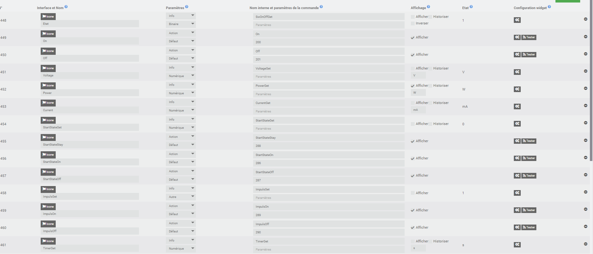

J’ai installé la version beta comme demandé , tous effacés et inclusion de nouveau avec commande MAX.

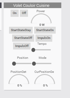

La commande " DiscoProg" , un slider , permet maintenant de commander le volet.
Voici le log WifilightV2_CMD
Slider « DiscoProg » , bas max , puis milieux , puis haut max
0000|[2022-10-25 07:22:22]DEBUG : Cmd : {"motorTurn":1} - full Cmd : {"sequence":"156958807731","deviceid":"10012ba16b","selfApikey":"00000000-0000-0000-0000-000000000000","iv":"OTA0ODgxODA0OTIyNzgwMw==","encrypt":true,"data":"IE7R/5T/bjUWbpSYtXVuqQ=="} - Rec:{"sequence":"156958807731","seq":425,"error":0,"encrypt":true}
0001|[2022-10-25 07:22:32]DEBUG : Cmd : {"motorTurn":0} - full Cmd : {"sequence":"156958807731","deviceid":"10012ba16b","selfApikey":"00000000-0000-0000-0000-000000000000","iv":"OTA0ODgxODA0OTIyNzgwMw==","encrypt":true,"data":"O0KTBR1p3g9ZB+IF/OVoOw=="} - Rec:{"sequence":"156958807731","seq":428,"error":0,"encrypt":true}
0002|[2022-10-25 07:22:37]DEBUG : Cmd : {"motorTurn":2} - full Cmd : {"sequence":"156958807731","deviceid":"10012ba16b","selfApikey":"00000000-0000-0000-0000-000000000000","iv":"OTA0ODgxODA0OTIyNzgwMw==","encrypt":true,"data":"OIkBLGRTQmgfcBURQcp9jw=="} - Rec:{"sequence":"156958807731","seq":430,"error":0,"encrypt":true}
Du coup comment transformer la commande Discoprog de Slider , en commande Ouverture /Fermerture / Stop ?

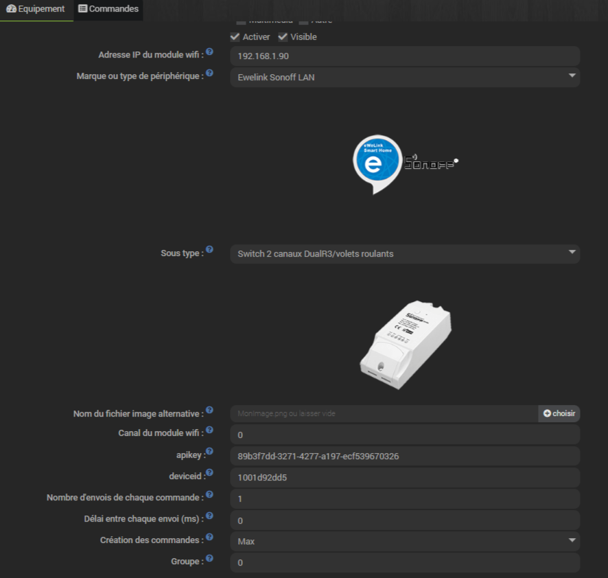

J’ai la dernière version de ton plugin, tout le reste fonctionne et justement avec eWelink je n’ai jamais de soucis majeur, sauf là avec ce module qui n’est pas un Sonoff car pas trouvé (ou mal cherché) mais avec ceci qui est compatible ewelink et qui fonctionne très bien avec l’appli https://fr.aliexpress.com/item/1005002194298862.html?spm=a2g0o.order_list.order_list_main.88.4ed85e5b4EJihP&gatewayAdapt=glo2fra
J’ai bien lu et relu tes explications faites sur ce sujet mais ça ne veut pas, en fait il ne se connecte pas.
Exception:cURL error 7: Failed to connect to 192.168.1.90 port 8081: Connection refused
[2023-02-22 15:11:12]DEBUG : No Ewelink device @http://192.168.1.90:8081/zeroconf/motorTurn
[2023-02-22 15:11:12]DEBUG : Cmd : {« motorTurn »:1} - full Cmd : {« sequence »:« 10 »,« deviceid »:« 1001d92dd5 »,« selfApikey »:« 00000000-0000-0000-0000-000000000000 »,« iv »:« OTA0ODgxODA0OTIyNzgwMw== »,« encrypt »:true,« data »:« Axe+NVq3DQ9m2bEV1QCHnw== »}
[2023-02-22 15:11:13]DEBUG : Start Hello:0.06467300 1677075073
[2023-02-22 15:11:13]DEBUG : token:4baf4a398dd9addfff0ce83b6923649a
Du coup je t’envoie ma page de configuration si c’est bien ok?
J’ai même recherché l’apikey avec l’ancienne méthode et c’est bien la bonne
D’avance merci pour ton aide

Edit: Je viens de voir que pour ce module je n’ai pas Contrôle sur réseau local, ça doit être ça le soucis. Les boules!
je vois canal 0 , ça peut pas marché il faut 1 ou 2
maintenant s’'il est pur cloud le plugin ne peut rien faire
j’avais essayé aussi 1 et 2 et ça ne fonctionne pas non plus. c’est dommage.
