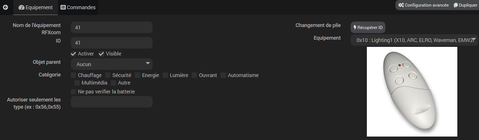

Voici avec plusieurs tlcmd en appuyant sur on/off

[2021-02-27 17:37:37][DEBUG] : Message: 082000005415500289
[2021-02-27 17:37:37][DEBUG] : Decode : 082000005415500289
[2021-02-27 17:37:37][DEBUG] : Test message: 082000005415500289
[2021-02-27 17:37:37][DEBUG] : PacketType: 0x20
[2021-02-27 17:37:37][DEBUG] : Length: 9
[2021-02-27 17:37:37][DEBUG] : Start decoding packet type 0x20
[2021-02-27 17:37:37][DEBUG] : Subtype = X10 security door/window sensor
[2021-02-27 17:37:37][DEBUG] : Data : {'packetlen': '0x08', 'packettype': '0x20', 'subtype': '0x00', 'seqnbr': '0x00', 'id1': '0x54', 'id2': '0x15', 'id3': '0x50', 'status': 2, 'battery': 9, 'rssi': 8}
[2021-02-27 17:37:37][DEBUG] : Decoded info : {'packettype': '0x20', 'subtype': '0x00', 'id': '541550', 'status': 2, 'battery': 9, 'rssi': 8}
[2021-02-27 17:37:37][DEBUG] : unknown device id : 541550
[2021-02-27 17:37:38][DEBUG] : Message: 082000015415500b79
[2021-02-27 17:37:38][DEBUG] : Decode : 082000015415500b79
[2021-02-27 17:37:38][DEBUG] : Test message: 082000015415500b79
[2021-02-27 17:37:38][DEBUG] : PacketType: 0x20
[2021-02-27 17:37:38][DEBUG] : Length: 9
[2021-02-27 17:37:38][DEBUG] : Start decoding packet type 0x20
[2021-02-27 17:37:38][DEBUG] : Subtype = X10 security door/window sensor
[2021-02-27 17:37:38][DEBUG] : Data : {'packetlen': '0x08', 'packettype': '0x20', 'subtype': '0x00', 'seqnbr': '0x01', 'id1': '0x54', 'id2': '0x15', 'id3': '0x50', 'status': 11, 'battery': 9, 'rssi': 7}
[2021-02-27 17:37:38][DEBUG] : Decoded info : {'packettype': '0x20', 'subtype': '0x00', 'id': '541550', 'status': 11, 'battery': 9, 'rssi': 7}
[2021-02-27 17:37:38][DEBUG] : unknown device id : 541550
[2021-02-27 17:37:39][DEBUG] : Message: 082000025455500279
