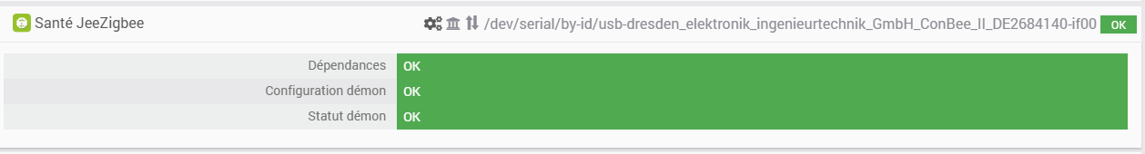

J’ai installer Jeedom sur un PI5 avec debian 12 en stable. Après upload du baccukup en 4.4.19 RFXCOM OK, ZWAVE OK, seul zigbee ne fonctionne pas. Le demon démarre puis génère des itérations jusqu’à stopper : Les modules ne communiquent pas. Je tourne en rond si quelqu’un a une solution je suis preneur.

> zigbee2mqtt@1.41.0 start > node index.js Starting Zigbee2MQTT without watchdog. [2024-11-27 17:17:14] e[32minfoe[39m: z2m: Logging to console, file (filename: log.log) [2024-11-27 17:17:14] e[31merrore[39m: z2m: Failed to load external converter file '/var/www/html/plugins/z2m/core/class/../config/converters/Danfoss/icon.js' (Cannot find module 'zigbee-herdsman-converters/lib/extend' Require stack: - /var/www/html/plugins/z2m/resources/zigbee2mqtt/dist/util/utils.js - /var/www/html/plugins/z2m/resources/zigbee2mqtt/dist/util/settings.js - /var/www/html/plugins/z2m/resources/zigbee2mqtt/index.js) [2024-11-27 17:17:14] e[31merrore[39m: z2m: Probably there is a syntax error in the file or the external converter is not compatible with the current Zigbee2MQTT version [2024-11-27 17:17:14] e[31merrore[39m: z2m: Note that external converters are not meant for long term usage, it's meant for local testing after which a pull request should be created to add out-of-the-box support for the device [2024-11-27 17:17:14] e[34mdebuge[39m: z2m: Loaded state from file /var/www/html/plugins/z2m/data/state.json [2024-11-27 17:17:14] e[32minfoe[39m: z2m: Starting Zigbee2MQTT version 1.41.0 (commit #cc31ceab) [2024-11-27 17:17:14] e[34mdebuge[39m: z2m: sd-notify loaded [2024-11-27 17:17:14] e[32minfoe[39m: z2m: Starting zigbee-herdsman (2.1.7) [2024-11-27 17:17:14] e[34mdebuge[39m: z2m: Using zigbee-herdsman with settings: '"{\"network\":{\"panID\":6754,\"extendedPanID\":[221,221,221,221,221,221,221,221],\"channelList\":[11],\"networkKey\":\"HIDDEN\"},\"databasePath\":\"/var/www/html/plugins/z2m/data/database.db\",\"databaseBackupPath\":\"/var/www/html/plugins/z2m/data/database.db.backup\",\"backupPath\":\"/var/www/html/plugins/z2m/data/coordinator_backup.json\",\"serialPort\":{\"path\":\"/dev/serial/by-id/usb-dresden_elektronik_ingenieurtechnik_GmbH_ConBee_II_DE2684140-if00\",\"adapter\":\"deconz\"},\"adapter\":{\"disableLED\":false}}"' [2024-11-27 17:17:14] e[34mdebuge[39m: zh:deconz:driver: Set delay to 0 [2024-11-27 17:17:14] e[34mdebuge[39m: zh:controller: Starting with options '{"network":{"networkKeyDistribute":false,"networkKey":"HIDDEN","panID":6754,"extendedPanID":[221,221,221,221,221,221,221,221],"channelList":[11]},"serialPort":{"path":"/dev/serial/by-id/usb-dresden_elektronik_ingenieurtechnik_GmbH_ConBee_II_DE2684140-if00","adapter":"deconz"},"adapter":{"disableLED":false},"databasePath":"/var/www/html/plugins/z2m/data/database.db","databaseBackupPath":"/var/www/html/plugins/z2m/data/database.db.backup","backupPath":"/var/www/html/plugins/z2m/data/coordinator_backup.json"}' [2024-11-27 17:17:14] e[34mdebuge[39m: zh:deconz:driver: Opening with /dev/serial/by-id/usb-dresden_elektronik_ingenieurtechnik_GmbH_ConBee_II_DE2684140-if00 [2024-11-27 17:17:14] e[34mdebuge[39m: zh:deconz:driver: Serialport opened [2024-11-27 17:17:14] e[34mdebuge[39m: zh:deconz:driver: send read parameter request from queue. seqNr: 1 paramId: 5 [2024-11-27 17:17:14] e[34mdebuge[39m: zh:deconz:frameparser: PANID: 1a62 [2024-11-27 17:17:14] e[34mdebuge[39m: zh:deconz:driver: send read parameter request from queue. seqNr: 2 paramId: 11 [2024-11-27 17:17:14] e[34mdebuge[39m: zh:deconz:frameparser: APS_EXT_PANID: 0xdddddddddddddddd [2024-11-27 17:17:14] e[34mdebuge[39m: zh:deconz:driver: send read parameter request from queue. seqNr: 3 paramId: 28 [2024-11-27 17:17:14] e[34mdebuge[39m: zh:deconz:frameparser: CHANNEL: 11 [2024-11-27 17:17:14] e[34mdebuge[39m: zh:deconz:driver: send read parameter request from queue. seqNr: 4 paramId: 24 [2024-11-27 17:17:14] e[34mdebuge[39m: zh:deconz:frameparser: NETWORK_KEY: hidden [2024-11-27 17:17:14] e[34mdebuge[39m: zh:deconz:driver: send write parameter request from queue. seqNr: 5 paramId: 19 param: 5,2,5,0,0,32,0,1,4,5,1,0,25,0,10,6,0,0,0,5,1,0,5,1,4,1,0 [2024-11-27 17:17:14] e[34mdebuge[39m: zh:deconz:frameparser: write parameter response - parameter id: 19 - status: 0 [2024-11-27 17:17:14] e[34mdebuge[39m: zh:controller: Started with result 'resumed' [2024-11-27 17:17:14] e[34mdebuge[39m: zh:deconz:driver: send read parameter request from queue. seqNr: 6 paramId: 5 [2024-11-27 17:17:14] e[34mdebuge[39m: zh:deconz:frameparser: PANID: 1a62 [2024-11-27 17:17:14] e[34mdebuge[39m: zh:deconz:driver: send read parameter request from queue. seqNr: 7 paramId: 11 [2024-11-27 17:17:14] e[34mdebuge[39m: zh:deconz:frameparser:
(/var/www/html/plugins/z2m/resources/zigbee2mqtt/node_modules/zigbee-herdsman/src/controller/helpers/request.ts:82:20) at Endpoint.sendRequest (/var/www/html/plugins/z2m/resources/zigbee2mqtt/node_modules/zigbee-herdsman/src/controller/model/endpoint.ts:325:20) at Endpoint.zclCommand (/var/www/html/plugins/z2m/resources/zigbee2mqtt/node_modules/zigbee-herdsman/src/controller/model/endpoint.ts:951:28) at Endpoint.read (/var/www/html/plugins/z2m/resources/zigbee2mqtt/node_modules/zigbee-herdsman/src/controller/model/endpoint.ts:446:29) [2024-11-27 17:17:25] e[33mwarninge[39m: zhc:lixee: Failed to read zigbee attributes: Error: ZCL command 0x00158d000638dfda/1 liXeePrivate.read(["linkyMode","currentTarif"], {"timeout":10000,"disableResponse":false,"disableRecovery":false,"disableDefaultResponse":true,"direction":0,"reservedBits":0,"manufacturerCode":null,"writeUndiv":false}) failed (no response received (3) Error: waiting for response TIMEOUT) [2024-11-27 17:17:34] e[34mdebuge[39m: zh:deconz:driver: send read device

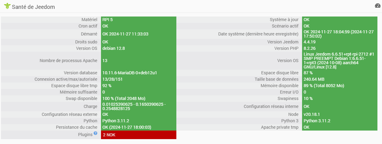

Il manque la page santé Jeedom
Vos logs sont illisibles car non copiés entre balises.
Enfin vous êtes en debian 12…
Désolé je n’avais pas mis les balises au bon endroit c’est rectifié yc la page santé .
