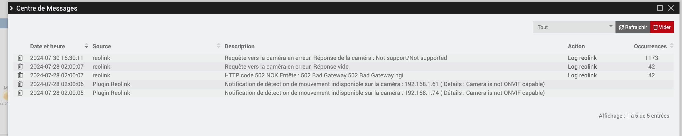

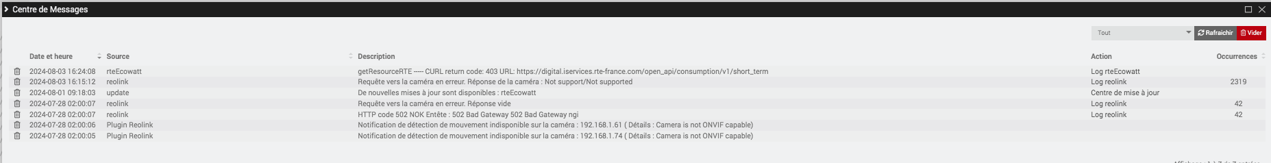

J’ai une erreur permanente qui remonte sur une caméra reolink E1 zoom parmi les deux installées, celle qui est en wifi (ip 61), pas de pb avec celle connectée en filaire (ip 74).voir log:
[2024-07-20 15:45:07] DEBUG : Payload => [{"cmd":"GetAudioCfg","action":0,"param":{"channel":0}},{"cmd":"GetIsp","action":0,"param":{"channel":0}}]
[2024-07-20 15:45:07] DEBUG : HTTP code 200 OK
[2024-07-20 15:45:07] DEBUG : Réponse caméra >> [{"cmd":"Unknown","code":1,"error":{"detail":"notsupport","rspCode":-9}},{"cmd":"GetIsp","code":0,"value":{"Isp":{"antiFlicker":"50HZ","backLight":"Off","bd_day":{"bright":128,"dark":128,"mode":"Auto"},"bd_night":{"bright":128,"dark":128,"mode":"Auto"},"blc":128,"blueGain":128,"channel":0,"dayNight":"Auto","dayNightThreshold":50,"drc":128,"exposure":"Auto","gain":{"max":62,"min":1},"mirroring":1,"nr3d":1,"redGain":128,"rotation":1,"shutter":{"max":125,"min":0},"whiteBalance":"Auto"}}}]
[2024-07-20 15:45:07] ERROR : Requête vers la caméra en erreur. Réponse de la caméra : Not support/Not supported

Avez vous une idée du problème?
