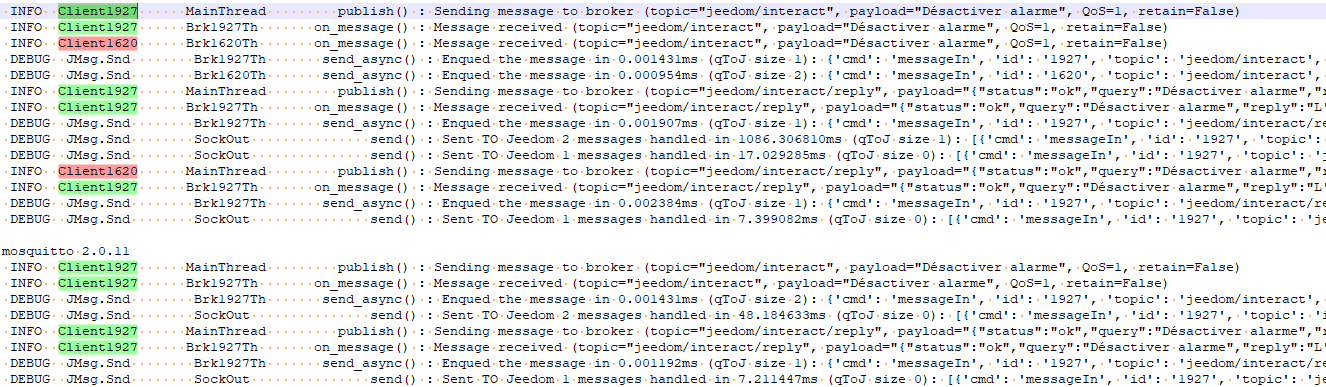

Voici les logs quand je reproduit le problème.
Avec mosquitto 2.0.22 (avec plusieurs broker qui ont l’option « Topic des interactions de Jeedom » de coché)
[2025-10-30 07:08:43,234] INFO  Client1927      MainThread         publish() : Sending message to broker (topic="jeedom/interact", payload="Désactiver alarme", QoS=1, retain=False)
[2025-10-30 07:08:43,236] INFO  Client1927      Brk1927Th       on_message() : Message received (topic="jeedom/interact", payload="Désactiver alarme", QoS=1, retain=False)
[2025-10-30 07:08:43,236] INFO  Client1620      Brk1620Th       on_message() : Message received (topic="jeedom/interact", payload="Désactiver alarme", QoS=1, retain=False)
[2025-10-30 07:08:43,236] DEBUG  JMsg.Snd        Brk1927Th       send_async() : Enqued the message in 0.001431ms (qToJ size 1): {'cmd': 'messageIn', 'id': '1927', 'topic': 'jeedom/interact', 'payload': 'Désactiver alarme', 'qos': 1, 'retain': False}
[2025-10-30 07:08:43,236] DEBUG  JMsg.Snd        Brk1620Th       send_async() : Enqued the message in 0.000954ms (qToJ size 2): {'cmd': 'messageIn', 'id': '1620', 'topic': 'jeedom/interact', 'payload': 'Désactiver alarme', 'qos': 1, 'retain': False}
[2025-10-30 07:08:43,335] INFO  Client1927      MainThread         publish() : Sending message to broker (topic="jeedom/interact/reply", payload="{"status":"ok","query":"Désactiver alarme","reply":"L'alarme est désactivée"}", QoS=1, retain=False)
[2025-10-30 07:08:43,336] INFO  Client1927      Brk1927Th       on_message() : Message received (topic="jeedom/interact/reply", payload="{"status":"ok","query":"Désactiver alarme","reply":"L'alarme est désactivée"}", QoS=1, retain=False)
[2025-10-30 07:08:43,336] DEBUG  JMsg.Snd        Brk1927Th       send_async() : Enqued the message in 0.001907ms (qToJ size 1): {'cmd': 'messageIn', 'id': '1927', 'topic': 'jeedom/interact/reply', 'payload': '{"status":"ok","query":"Désactiver alarme","reply":"L\'alarme est désactivée"}', 'qos': 1, 'retain': False}
[2025-10-30 07:08:44,363] DEBUG  JMsg.Snd        SockOut               send() : Sent TO Jeedom 2 messages handled in 1086.306810ms (qToJ size 1): [{'cmd': 'messageIn', 'id': '1927', 'topic': 'jeedom/interact', 'payload': 'Désactiver alarme', 'qos': 1, 'retain': False}, {'cmd': 'messageIn', 'id': '1620', 'topic': 'jeedom/interact', 'payload': 'Désactiver alarme', 'qos': 1, 'retain': False}]
[2025-10-30 07:08:44,380] DEBUG  JMsg.Snd        SockOut               send() : Sent TO Jeedom 1 messages handled in 17.029285ms (qToJ size 0): [{'cmd': 'messageIn', 'id': '1927', 'topic': 'jeedom/interact/reply', 'payload': '{"status":"ok","query":"Désactiver alarme","reply":"L\'alarme est désactivée"}', 'qos': 1, 'retain': False}]
[2025-10-30 07:08:44,437] INFO  Client1620      MainThread         publish() : Sending message to broker (topic="jeedom/interact/reply", payload="{"status":"ok","query":"Désactiver alarme","reply":"L'alarme est désactivée"}", QoS=1, retain=False)
[2025-10-30 07:08:44,438] INFO  Client1927      Brk1927Th       on_message() : Message received (topic="jeedom/interact/reply", payload="{"status":"ok","query":"Désactiver alarme","reply":"L'alarme est désactivée"}", QoS=1, retain=False)
[2025-10-30 07:08:44,438] DEBUG  JMsg.Snd        Brk1927Th       send_async() : Enqued the message in 0.002384ms (qToJ size 1): {'cmd': 'messageIn', 'id': '1927', 'topic': 'jeedom/interact/reply', 'payload': '{"status":"ok","query":"Désactiver alarme","reply":"L\'alarme est désactivée"}', 'qos': 1, 'retain': False}
[2025-10-30 07:08:44,488] DEBUG  JMsg.Snd        SockOut               send() : Sent TO Jeedom 1 messages handled in 7.399082ms (qToJ size 0): [{'cmd': 'messageIn', 'id': '1927', 'topic': 'jeedom/interact/reply', 'payload': '{"status":"ok","query":"Désactiver alarme","reply":"L\'alarme est désactivée"}', 'qos': 1, 'retain': False}]
les logs avec mosquitto 2.0.11
[2025-10-30 07:15:02,740] INFO  Client1927      MainThread         publish() : Sending message to broker (topic="jeedom/interact", payload="Désactiver alarme", QoS=1, retain=False)
[2025-10-30 07:15:02,740] INFO  Client1927      Brk1927Th       on_message() : Message received (topic="jeedom/interact", payload="Désactiver alarme", QoS=1, retain=False)
[2025-10-30 07:15:02,740] DEBUG  JMsg.Snd        Brk1927Th       send_async() : Enqued the message in 0.001431ms (qToJ size 2): {'cmd': 'messageIn', 'id': '1927', 'topic': 'jeedom/interact', 'payload': 'Désactiver alarme', 'qos': 1, 'retain': False}
[2025-10-30 07:15:02,805] DEBUG  JMsg.Snd        SockOut               send() : Sent TO Jeedom 2 messages handled in 48.184633ms (qToJ size 0): [{'cmd': 'messageIn', 'id': '1927', 'topic': 'iobroker2mqtt/system/adapter/yeelight-2/0/connected', 'payload': 'true', 'qos': 0, 'retain': False}, {'cmd': 'messageIn', 'id': '1927', 'topic': 'jeedom/interact', 'payload': 'Désactiver alarme', 'qos': 1, 'retain': False}]
[2025-10-30 07:15:02,840] INFO  Client1927      MainThread         publish() : Sending message to broker (topic="jeedom/interact/reply", payload="{"status":"ok","query":"Désactiver alarme","reply":"L'alarme est désactivée"}", QoS=1, retain=False)
[2025-10-30 07:15:02,840] INFO  Client1927      Brk1927Th       on_message() : Message received (topic="jeedom/interact/reply", payload="{"status":"ok","query":"Désactiver alarme","reply":"L'alarme est désactivée"}", QoS=1, retain=False)
[2025-10-30 07:15:02,841] DEBUG  JMsg.Snd        Brk1927Th       send_async() : Enqued the message in 0.001192ms (qToJ size 1): {'cmd': 'messageIn', 'id': '1927', 'topic': 'jeedom/interact/reply', 'payload': '{"status":"ok","query":"Désactiver alarme","reply":"L\'alarme est désactivée"}', 'qos': 1, 'retain': False}
[2025-10-30 07:15:02,913] DEBUG  JMsg.Snd        SockOut               send() : Sent TO Jeedom 1 messages handled in 7.211447ms (qToJ size 0): [{'cmd': 'messageIn', 'id': '1927', 'topic': 'jeedom/interact/reply', 'payload': '{"status":"ok","query":"Désactiver alarme","reply":"L\'alarme est désactivée"}', 'qos': 1, 'retain': False}]
Ca donne l’impression que les dernières versions de mosquitto n’esquivent pas des messages qui arrivent pile poil à la millisecondes près, la ou la 2.0.11 les droppe apparemment.
A dispo si je dois fournir plus de logs ou autre.
Merci d’avance.

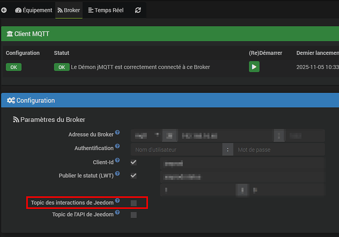

Hello @znation,
Mon impression est différente, je pense que les interactions sont activées sur les 2 équipements Brokers déclaré dans jMQTT :
Peux-tu vérifier que seul l’un des deux est actif ? Cf :
Bad
Mais oui entièrement d’accord avec toi.
Yen avait 2 actifs en décochant 1 c’est ok mais pourquoi en mosquitto 2.0.11 embarqué ça posait pas de soucis avec 2 de cochés et en 2.0.22 ça coince ?
C’était probablement un bug dans Mosquitto, je te laisse regarder les changelogs entre les versions : Version 2.0.22 released. | Eclipse Mosquitto
Il y a plusieurs cas de problème de queue, publication quand il y a plusieurs subscribers, etc
Normalement, si le topic d’interaction est actif, il doit être pris en compte sur le/les brokers déclarés.
