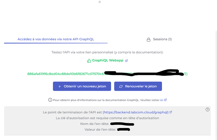

Voici le script fourni par le fabricant et modifié pour fonctionner sur jeedom :
#!/bin/bash
# Requirements:
# This script uses jq for JSON parsing.
# apt install jq
# Description:
# This script fetches measurement data from the LabCom GraphQL API and displays it in a formatted table.
# The measurement records will be grouped by parameter and prints only the latest result each.
# Usage:
# ./labcom_api.sh
#Langue
export LANG=C.UTF-8
# Ensure to replace YOUR-API-TOKEN with your actual API token before use
API_TOKEN="VOTRE TOKEN EN LAISSANT LES GUILLEMETS"
