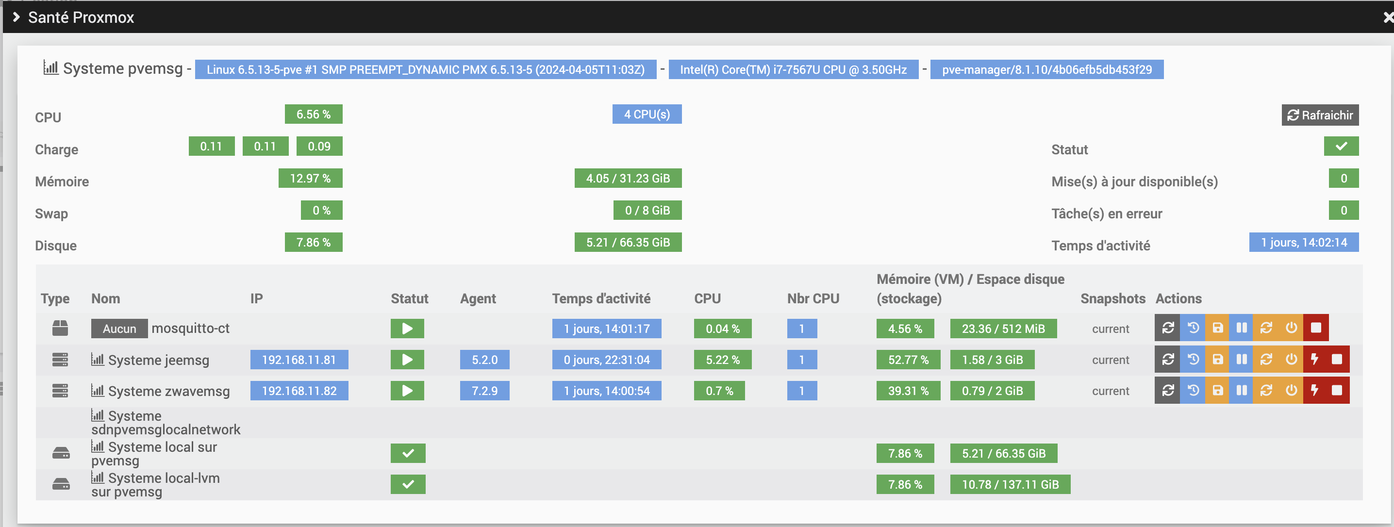

16381|[2024-04-18 13:54:07]WARNING : Cannot create commands for unknown deviceType: sdn / sdnpvemsglocalnetwork
