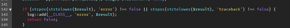

Process PAC Modbus:
File « /var/www/html/jeedom/plugins/pyenv/resources/pyenv/versions/3.11.8/lib/python3.11/multiprocessing/process.py », line 314, in _bootstrap
self.run()
File « /var/www/html/jeedom/plugins/pyenv/resources/pyenv/versions/3.11.8/lib/python3.11/multiprocessing/process.py », line 108, in run
self._target(*self._args, **self._kwargs)
File « /var/www/html/jeedom/plugins/mymodbus/ressources/mymodbusd/mymodbus.py », line 334, in run
self.loop.run_until_complete(self.run_polling())
File « /var/www/html/jeedom/plugins/pyenv/resources/pyenv/versions/3.11.8/lib/python3.11/asyncio/base_events.py », line 654, in run_until_complete
return future.result()
File « /var/www/html/jeedom/plugins/mymodbus/ressources/mymodbusd/mymodbus.py », line 361, in run_polling
await self.read_all()
File « /var/www/html/jeedom/plugins/mymodbus/ressources/mymodbusd/mymodbus.py », line 602, in read_all
logging.debug('PyModbusClient: ’ + self.eqConfig[‹ name ›] + ’ read value for ’ + request[‹ name ›] + ’ (command id ’ + cmd_id + '): ’ + str(read_results[cmd_id]))
TypeError: can only concatenate str (not "int") to str
