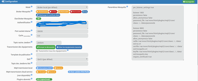

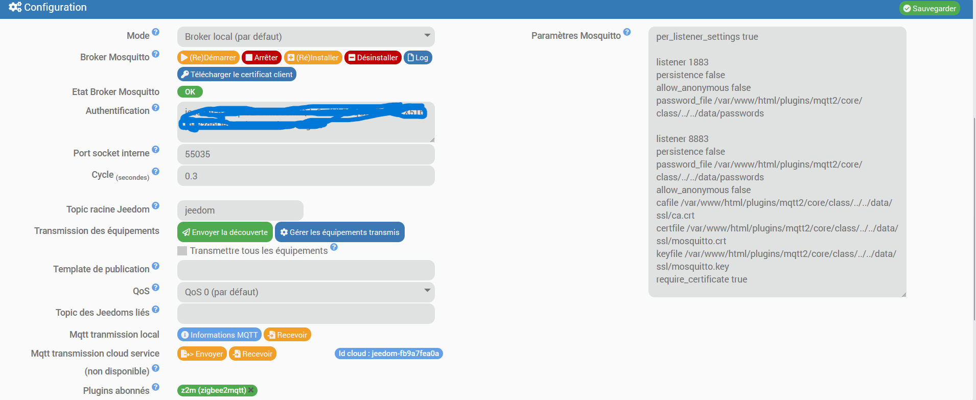

Le demon arrive pas a joindre ton jeedom, malheureusement sans la log complete je peux pas t’en dire plus.

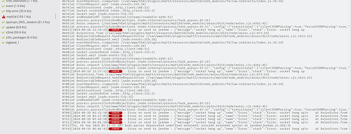

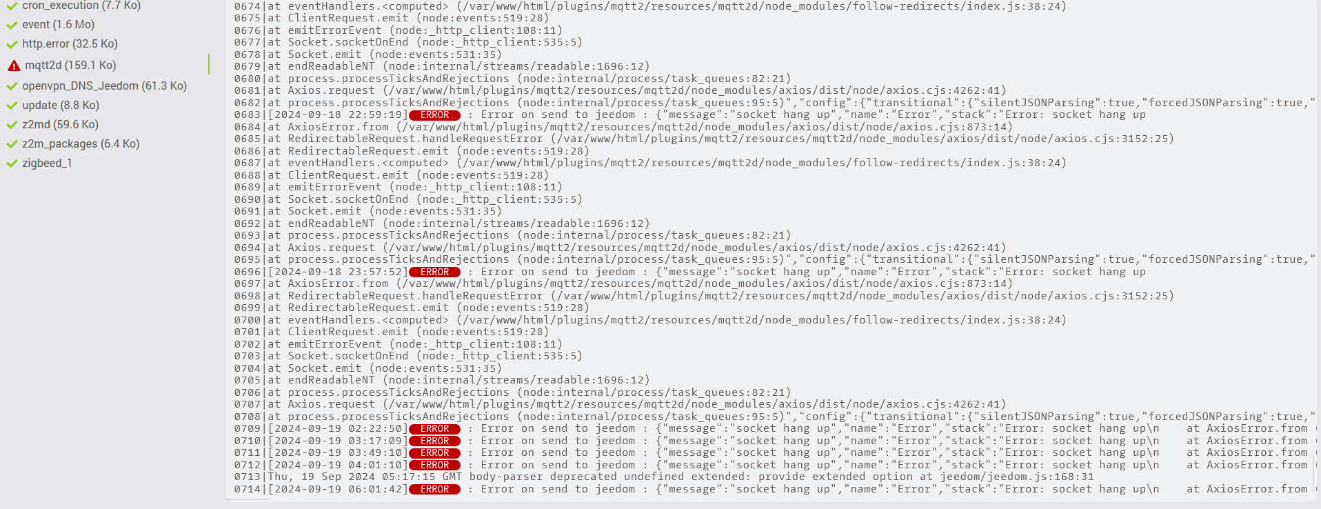

[2024-09-19 02:22:50] ERROR  : Error on send to jeedom : {"message":"socket hang up","name":"Error","stack":"Error: socket hang up\n    at AxiosError.from (/var/www/html/plugins/mqtt2/resources/mqtt2d/node_modules/axios/dist/node/axios.cjs:873:14)\n    at RedirectableRequest.handleRequestError (/var/www/html/plugins/mqtt2/resources/mqtt2d/node_modules/axios/dist/node/axios.cjs:3152:25)\n    at RedirectableRequest.emit (node:events:519:28)\n    at eventHandlers.<computed> (/var/www/html/plugins/mqtt2/resources/mqtt2d/node_modules/follow-redirects/index.js:38:24)\n    at ClientRequest.emit (node:events:519:28)\n    at emitErrorEvent (node:_http_client:108:11)\n    at Socket.socketOnEnd (node:_http_client:535:5)\n    at Socket.emit (node:events:531:35)\n    at endReadableNT (node:internal/streams/readable:1696:12)\n    at process.processTicksAndRejections (node:internal/process/task_queues:82:21)\n    at Axios.request (/var/www/html/plugins/mqtt2/resources/mqtt2d/node_modules/axios/dist/node/axios.cjs:4262:41)\n    at process.processTicksAndRejections (node:internal/process/task_queues:95:5)","config":{"transitional":{"silentJSONParsing":true,"forcedJSONParsing":true,"clarifyTimeoutError":false},"adapter":["xhr","http","fetch"],"transformRequest":[null],"transformResponse":[null],"timeout":0,"xsrfCookieName":"XSRF-TOKEN","xsrfHeaderName":"X-XSRF-TOKEN","maxContentLength":-1,"maxBodyLength":-1,"env":{},"headers":{"Accept":"application/json, text/plain, */*","Content-Type":"application/x-www-form-urlencoded","User-Agent":"axios/1.7.3","Content-Length":"1249","Accept-Encoding":"gzip, compress, deflate, br"},"method":"post","url":"http://127.0.0.1:80/plugins/mqtt2/core/php/jeeMqtt2.php?apikey=hzF0rNon192HZq3AFuYd21W5V4t9yug3ExXkU6OWeAc7fjmvea7CC5DcVtokz3RZ","data":"{\"zigbee2mqtt\":{\"0xbc026efffead3f86\":{\"device\":{\"applicationVersion\":3,\"dateCode\":\"2020\",\"friendlyName\":\"0xbc026efffead3f86\",\"hardwareVersion\":50,\"ieeeAddr\":\"0xbc026efffead3f86\",\"manufacturerID\":4747,\"manufacturerName\":\"NodOn\",\"model\":\"SIN-4-RS-20\",\"networkAddress\":2666,\"powerSource\":\"Mains (single phase)\",\"softwareBuildID\":\"3.0.0-1.3.0\",\"stackVersion\":103,\"type\":\"Router\",\"zclVersion\":8},\"last_seen\":\"2024-09-19T02:22:49.092Z\",\"linkquality\":120,\"position\":0,\"state\":\"CLOSE\",\"tilt\":100,\"update\":{\"installed_version\":768,\"latest_version\":771,\"state\":\"available\"},\"update_available\":true}},\"$SYS\":{\"broker\":{\"uptime\":\"3668241 seconds\",\"load\":{\"messages\":{\"received\":{\"1min\":19.15,\"5min\":22.57,\"15min\":23.18},\"sent\":{\"1min\":77.03,\"5min\":85.04,\"15min\":86.28}},\"publish\":{\"received\":{\"1min\":17.01,\"5min\":20.54,\"15min\":21.16},\"sent\":{\"1min\":65.36,\"5min\":72.95,\"15min\":74.13}},\"bytes\":{\"received\":{\"1min\":10342.44,\"5min\":12441.79,\"15min\":12998.27},\"sent\":{\"1min\":21514.21,\"5min\":25738.67,\"15min\":26855.57}}},\"store\":{\"messages\":{\"bytes\":182347}},\"messages\":{\"received\":2141373,\"sent\":6017318},\"publish\":{\"messages\":{\"received\":2016932,\"sent\":5895350},\"bytes\":{\"received\":1215106193,\"sent\":2451869519}},\"bytes\":{\"received\":1285991241,\"sent\":2662431732}}}}"},"code":"ECONNRESET","status":null}
[2024-09-19 03:17:09] ERROR  : Error on send to jeedom : {"message":"socket hang up","name":"Error","stack":"Error: socket hang up\n    at AxiosError.from (/var/www/html/plugins/mqtt2/resources/mqtt2d/node_modules/axios/dist/node/axios.cjs:873:14)\n    at RedirectableRequest.handleRequestError (/var/www/html/plugins/mqtt2/resources/mqtt2d/node_modules/axios/dist/node/axios.cjs:3152:25)\n    at RedirectableRequest.emit (node:events:519:28)\n    at eventHandlers.<computed> (/var/www/html/plugins/mqtt2/resources/mqtt2d/node_modules/follow-redirects/index.js:38:24)\n    at ClientRequest.emit (node:events:519:28)\n    at emitErrorEvent (node:_http_client:108:11)\n    at Socket.socketOnEnd (node:_http_client:535:5)\n    at Socket.emit (node:events:531:35)\n    at endReadableNT (node:internal/streams/readable:1696:12)\n    at process.processTicksAndRejections (node:internal/process/task_queues:82:21)\n    at Axios.request (/var/www/html/plugins/mqtt2/resources/mqtt2d/node_modules/axios/dist/node/axios.cjs:4262:41)\n    at process.processTicksAndRejections (node:internal/process/task_queues:95:5)","config":{"transitional":{"silentJSONParsing":true,"forcedJSONParsing":true,"clarifyTimeoutError":false},"adapter":["xhr","http","fetch"],"transformRequest":[null],"transformResponse":[null],"timeout":0,"xsrfCookieName":"XSRF-TOKEN","xsrfHeaderName":"X-XSRF-TOKEN","maxContentLength":-1,"maxBodyLength":-1,"env":{},"headers":{"Accept":"application/json, text/plain, */*","Content-Type":"application/x-www-form-urlencoded","User-Agent":"axios/1.7.3","Content-Length":"324","Accept-Encoding":"gzip, compress, deflate, br"},"method":"post","url":"http://127.0.0.1:80/plugins/mqtt2/core/php/jeeMqtt2.php?apikey=hzF0rNon192HZq3AFuYd21W5V4t9yug3ExXkU6OWeAc7fjmvea7CC5DcVtokz3RZ","data":"{\"$SYS\":{\"broker\":{\"uptime\":\"3671500 seconds\",\"load\":{\"messages\":{\"received\":{\"1min\":20.93,\"5min\":21.49},\"sent\":{\"1min\":82.69,\"5min\":83.09}},\"publish\":{\"received\":{\"1min\":19.4,\"5min\":19.58},\"sent\":{\"1min\":70.62,\"5min\":70.8}},\"bytes\":{\"received\":{\"1min\":12089.59,\"5min\":12177.51},\"sent\":{\"1min\":25052.57,\"5min\":25224.71}}}}}}"},"code":"ECONNRESET","status":null}
[2024-09-19 03:49:10] ERROR  : Error on send to jeedom : {"message":"socket hang up","name":"Error","stack":"Error: socket hang up\n    at AxiosError.from (/var/www/html/plugins/mqtt2/resources/mqtt2d/node_modules/axios/dist/node/axios.cjs:873:14)\n    at RedirectableRequest.handleRequestError (/var/www/html/plugins/mqtt2/resources/mqtt2d/node_modules/axios/dist/node/axios.cjs:3152:25)\n    at RedirectableRequest.emit (node:events:519:28)\n    at eventHandlers.<computed> (/var/www/html/plugins/mqtt2/resources/mqtt2d/node_modules/follow-redirects/index.js:38:24)\n    at ClientRequest.emit (node:events:519:28)\n    at emitErrorEvent (node:_http_client:108:11)\n    at Socket.socketOnEnd (node:_http_client:535:5)\n    at Socket.emit (node:events:531:35)\n    at endReadableNT (node:internal/streams/readable:1696:12)\n    at process.processTicksAndRejections (node:internal/process/task_queues:82:21)\n    at Axios.request (/var/www/html/plugins/mqtt2/resources/mqtt2d/node_modules/axios/dist/node/axios.cjs:4262:41)\n    at process.processTicksAndRejections (node:internal/process/task_queues:95:5)","config":{"transitional":{"silentJSONParsing":true,"forcedJSONParsing":true,"clarifyTimeoutError":false},"adapter":["xhr","http","fetch"],"transformRequest":[null],"transformResponse":[null],"timeout":0,"xsrfCookieName":"XSRF-TOKEN","xsrfHeaderName":"X-XSRF-TOKEN","maxContentLength":-1,"maxBodyLength":-1,"env":{},"headers":{"Accept":"application/json, text/plain, */*","Content-Type":"application/x-www-form-urlencoded","User-Agent":"axios/1.7.3","Content-Length":"627","Accept-Encoding":"gzip, compress, deflate, br"},"method":"post","url":"http://127.0.0.1:80/plugins/mqtt2/core/php/jeeMqtt2.php?apikey=hzF0rNon192HZq3AFuYd21W5V4t9yug3ExXkU6OWeAc7fjmvea7CC5DcVtokz3RZ","data":"{\"zigbee2mqtt\":{\"0x286847fffe2e0518\":{\"calibration_vertical_run_time_up\":0,\"device\":{\"applicationVersion\":3,\"dateCode\":\"2020\",\"friendlyName\":\"0x286847fffe2e0518\",\"hardwareVersion\":50,\"ieeeAddr\":\"0x286847fffe2e0518\",\"manufacturerID\":4747,\"manufacturerName\":\"NodOn\",\"model\":\"SIN-4-RS-20\",\"networkAddress\":4359,\"powerSource\":\"Mains (single phase)\",\"softwareBuildID\":\"3.0.0-1.3.0\",\"stackVersion\":103,\"type\":\"Router\",\"zclVersion\":8},\"last_seen\":\"2024-09-19T03:49:09.946Z\",\"linkquality\":200,\"position\":0,\"state\":\"CLOSE\",\"tilt\":100,\"update\":{\"installed_version\":768,\"latest_version\":771,\"state\":\"available\"},\"update_available\":true}}}"},"code":"ECONNRESET","status":null}
[2024-09-19 04:01:10] ERROR  : Error on send to jeedom : {"message":"socket hang up","name":"Error","stack":"Error: socket hang up\n    at AxiosError.from (/var/www/html/plugins/mqtt2/resources/mqtt2d/node_modules/axios/dist/node/axios.cjs:873:14)\n    at RedirectableRequest.handleRequestError (/var/www/html/plugins/mqtt2/resources/mqtt2d/node_modules/axios/dist/node/axios.cjs:3152:25)\n    at RedirectableRequest.emit (node:events:519:28)\n    at eventHandlers.<computed> (/var/www/html/plugins/mqtt2/resources/mqtt2d/node_modules/follow-redirects/index.js:38:24)\n    at ClientRequest.emit (node:events:519:28)\n    at emitErrorEvent (node:_http_client:108:11)\n    at Socket.socketOnEnd (node:_http_client:535:5)\n    at Socket.emit (node:events:531:35)\n    at endReadableNT (node:internal/streams/readable:1696:12)\n    at process.processTicksAndRejections (node:internal/process/task_queues:82:21)\n    at Axios.request (/var/www/html/plugins/mqtt2/resources/mqtt2d/node_modules/axios/dist/node/axios.cjs:4262:41)\n    at process.processTicksAndRejections (node:internal/process/task_queues:95:5)","config":{"transitional":{"silentJSONParsing":true,"forcedJSONParsing":true,"clarifyTimeoutError":false},"adapter":["xhr","http","fetch"],"transformRequest":[null],"transformResponse":[null],"timeout":0,"xsrfCookieName":"XSRF-TOKEN","xsrfHeaderName":"X-XSRF-TOKEN","maxContentLength":-1,"maxBodyLength":-1,"env":{},"headers":{"Accept":"application/json, text/plain, */*","Content-Type":"application/x-www-form-urlencoded","User-Agent":"axios/1.7.3","Content-Length":"883","Accept-Encoding":"gzip, compress, deflate, br"},"method":"post","url":"http://127.0.0.1:80/plugins/mqtt2/core/php/jeeMqtt2.php?apikey=hzF0rNon192HZq3AFuYd21W5V4t9yug3ExXkU6OWeAc7fjmvea7CC5DcVtokz3RZ","data":"{\"zigbee2mqtt\":{\"0x84b4dbfffe08d238\":{\"device\":{\"applicationVersion\":3,\"dateCode\":\"2020\",\"friendlyName\":\"0x84b4dbfffe08d238\",\"hardwareVersion\":50,\"ieeeAddr\":\"0x84b4dbfffe08d238\",\"manufacturerID\":4747,\"manufacturerName\":\"NodOn\",\"model\":\"SIN-4-RS-20\",\"networkAddress\":56405,\"powerSource\":\"Mains (single phase)\",\"softwareBuildID\":\"3.0.0-1.3.0\",\"stackVersion\":103,\"type\":\"Router\",\"zclVersion\":8},\"last_seen\":\"2024-09-19T04:01:09.906Z\",\"linkquality\":128,\"position\":0,\"state\":\"CLOSE\",\"tilt\":100,\"update\":{\"installed_version\":66304,\"latest_version\":65794,\"state\":\"idle\"},\"update_available\":true}},\"$SYS\":{\"broker\":{\"uptime\":\"3674141 seconds\",\"load\":{\"messages\":{\"received\":{\"1min\":31.22,\"5min\":26.3},\"sent\":{\"1min\":104.51,\"5min\":94.17}},\"publish\":{\"received\":{\"1min\":29.66,\"5min\":24.39},\"sent\":{\"1min\":92.05,\"5min\":81.41}},\"bytes\":{\"received\":{\"1min\":18302.72},\"sent\":{\"1min\":37502.32}}}}}}"},"code":"ECONNRESET","status":null}
Thu, 19 Sep 2024 05:17:15 GMT body-parser deprecated undefined extended: provide extended option at jeedom/jeedom.js:168:31
[2024-09-19 06:01:42] ERROR  : Error on send to jeedom : {"message":"socket hang up","name":"Error","stack":"Error: socket hang up\n    at AxiosError.from (/var/www/html/plugins/mqtt2/resources/mqtt2d/node_modules/axios/dist/node/axios.cjs:873:14)\n    at RedirectableRequest.handleRequestError (/var/www/html/plugins/mqtt2/resources/mqtt2d/node_modules/axios/dist/node/axios.cjs:3152:25)\n    at RedirectableRequest.emit (node:events:519:28)\n    at eventHandlers.<computed> (/var/www/html/plugins/mqtt2/resources/mqtt2d/node_modules/follow-redirects/index.js:38:24)\n    at ClientRequest.emit (node:events:519:28)\n    at emitErrorEvent (node:_http_client:108:11)\n    at Socket.socketOnEnd (node:_http_client:535:5)\n    at Socket.emit (node:events:531:35)\n    at endReadableNT (node:internal/streams/readable:1696:12)\n    at process.processTicksAndRejections (node:internal/process/task_queues:82:21)\n    at Axios.request (/var/www/html/plugins/mqtt2/resources/mqtt2d/node_modules/axios/dist/node/axios.cjs:4262:41)\n    at process.processTicksAndRejections (node:internal/process/task_queues:95:5)","config":{"transitional":{"silentJSONParsing":true,"forcedJSONParsing":true,"clarifyTimeoutError":false},"adapter":["xhr","http","fetch"],"transformRequest":[null],"transformResponse":[null],"timeout":0,"xsrfCookieName":"XSRF-TOKEN","xsrfHeaderName":"X-XSRF-TOKEN","maxContentLength":-1,"maxBodyLength":-1,"env":{},"headers":{"Accept":"application/json, text/plain, */*","Content-Type":"application/x-www-form-urlencoded","User-Agent":"axios/1.7.3","Content-Length":"350","Accept-Encoding":"gzip, compress, deflate, br"},"method":"post","url":"http://127.0.0.1:80/plugins/mqtt2/core/php/jeeMqtt2.php?apikey=hzF0rNon192HZq3AFuYd21W5V4t9yug3ExXkU6OWeAc7fjmvea7CC5DcVtokz3RZ","data":"{\"$SYS\":{\"broker\":{\"uptime\":\"3681372 seconds\",\"load\":{\"messages\":{\"received\":{\"1min\":30.69,\"5min\":33.73,\"15min\":34.96},\"sent\":{\"1min\":102.57,\"5min\":109,\"15min\":111.66}},\"publish\":{\"received\":{\"1min\":28.24,\"5min\":31.64},\"sent\":{\"1min\":89.2,\"5min\":96}},\"bytes\":{\"received\":{\"1min\":17409.02,\"5min\":19519.34},\"sent\":{\"1min\":35713.14,\"5min\":39944.41}}}}}}"},"code":"ECONNRESET","status":null}
Thu, 19 Sep 2024 07:45:06 GMT body-parser deprecated undefined extended: provide extended option at jeedom/jeedom.js:168:31
[2024-09-19 07:54:33] ERROR  : Reconnection to mqtt server
Ce sont les dernières lignes du log mqtt2d qui m’indiquent des messages d’erreurs

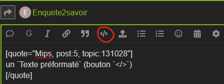

Veuillez utiliser un Texte préformaté (bouton </>) pour coller un log:
saisissez ou collez du code ici
message corrigé
Merci c’est nettement mieux

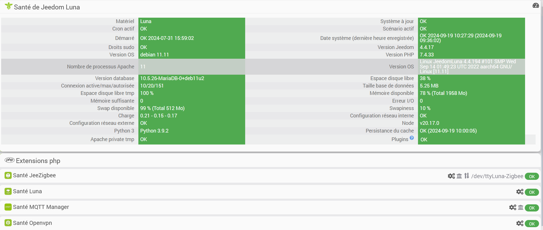

Fournissez la page santé jeedom également (capture écran)
Comment faites-vous pour mettre un texte de log préformaté pour le rendre plus agréable à la lecture pour la team jeedom ?
Pourrais tu relire mon message pour me fournir ce dont j’ai besoin sinon je vais vraiment pas pouvoir t’aider et ca serait dommage.

0341|at process.processTicksAndRejections (node:internal/process/task_queues:82:21)
0342|at Axios.request (/var/www/html/plugins/mqtt2/resources/mqtt2d/node_modules/axios/dist/node/axios.cjs:4262:41)
0343|at process.processTicksAndRejections (node:internal/process/task_queues:95:5)","config":{"transitional":{"silentJSONParsing":true,"forcedJSONParsing":true,"clarifyTimeoutError":false},"adapter":["xhr","http","fetch"],"transformRequest":[null],"transformResponse":[null],"timeout":0,"xsrfCookieName":"XSRF-TOKEN","xsrfHeaderName":"X-XSRF-TOKEN","maxContentLength":-1,"maxBodyLength":-1,"env":{},"headers":{"Accept":"application/json, text/plain, */*","Content-Type":"application/x-www-form-urlencoded","User-Agent":"axios/1.7.3","Content-Length":"663","Accept-Encoding":"gzip, compress, deflate, br"},"method":"post","url":"http://127.0.0.1:80/plugins/mqtt2/core/php/jeeMqtt2.php?apikey=hzF0rNon192HZq3AFuYd21W5V4t9yug3ExXkU6OWeAc7fjmvea7CC5DcVtokz3RZ","data":"{\"$SYS\":{\"broker\":{\"uptime\":\"3548761 seconds\",\"load\":{\"messages\":{\"received\":{\"1min\":36.88,\"5min\":35.08,\"15min\":35.6},\"sent\":{\"1min\":115.83,\"5min\":111.87,\"15min\":112.81}},\"publish\":{\"received\":{\"1min\":35.32,\"5min\":33.16,\"15min\":33.63},\"sent\":{\"1min\":103.36,\"5min\":99.05,\"15min\":99.94}},\"bytes\":{\"received\":{\"1min\":21817.26,\"5min\":20534.76,\"15min\":20824.45},\"sent\":{\"1min\":44531.39,\"5min\":41965.49,\"15min\":42543.87}}},\"store\":{\"messages\":{\"bytes\":182351}},\"messages\":{\"received\":2075444,\"sent\":5590111},\"publish\":{\"messages\":{\"received\":1955009,\"sent\":5472121},\"bytes\":{\"received\":1178565283,\"sent\":2375368076}},\"bytes\":{\"received\":1247274412,\"sent\":2570444591}}}}"},"code":"ECONNRESET","status":null}
0344|[2024-09-17 17:23:48] ERROR  : Error on send to jeedom : {"message":"socket hang up","name":"Error","stack":"Error: socket hang up
0345|at AxiosError.from (/var/www/html/plugins/mqtt2/resources/mqtt2d/node_modules/axios/dist/node/axios.cjs:873:14)
0346|at RedirectableRequest.handleRequestError (/var/www/html/plugins/mqtt2/resources/mqtt2d/node_modules/axios/dist/node/axios.cjs:3152:25)
0347|at RedirectableRequest.emit (node:events:519:28)
0348|at eventHandlers.<computed> (/var/www/html/plugins/mqtt2/resources/mqtt2d/node_modules/follow-redirects/index.js:38:24)
0349|at ClientRequest.emit (node:events:519:28)
0350|at emitErrorEvent (node:_http_client:108:11)
0351|at Socket.socketOnEnd (node:_http_client:535:5)
0352|at Socket.emit (node:events:531:35)
0353|at endReadableNT (node:internal/streams/readable:1696:12)
0354|at process.processTicksAndRejections (node:internal/process/task_queues:82:21)
0355|at Axios.request (/var/www/html/plugins/mqtt2/resources/mqtt2d/node_modules/axios/dist/node/axios.cjs:4262:41)
0356|at process.processTicksAndRejections (node:internal/process/task_queues:95:5)","config":{"transitional":{"silentJSONParsing":true,"forcedJSONParsing":true,"clarifyTimeoutError":false},"adapter":["xhr","http","fetch"],"transformRequest":[null],"transformResponse":[null],"timeout":0,"xsrfCookieName":"XSRF-TOKEN","xsrfHeaderName":"X-XSRF-TOKEN","maxContentLength":-1,"maxBodyLength":-1,"env":{},"headers":{"Accept":"application/json, text/plain, */*","Content-Type":"application/x-www-form-urlencoded","User-Agent":"axios/1.7.3","Content-Length":"628","Accept-Encoding":"gzip, compress, deflate, br"},"method":"post","url":"http://127.0.0.1:80/plugins/mqtt2/core/php/jeeMqtt2.php?apikey=hzF0rNon192HZq3AFuYd21W5V4t9yug3ExXkU6OWeAc7fjmvea7CC5DcVtokz3RZ","data":"{\"$SYS\":{\"broker\":{\"uptime\":\"3549498 seconds\",\"load\":{\"messages\":{\"received\":{\"1min\":38.65,\"5min\":37.17,\"15min\":36.48},\"sent\":{\"1min\":118.86,\"5min\":115.96,\"15min\":114.57}},\"publish\":{\"received\":{\"1min\":36.57,\"5min\":35.16,\"15min\":34.48},\"sent\":{\"1min\":105.87,\"5min\":103.05,\"15min\":101.66}},\"bytes\":{\"received\":{\"1min\":22686.96,\"5min\":21733.98,\"15min\":21291.83},\"sent\":{\"1min\":46269.77,\"5min\":44363.93,\"15min\":43479.17}}},\"messages\":{\"received\":2075902,\"sent\":5592829},\"publish\":{\"messages\":{\"received\":1955442,\"sent\":5474814},\"bytes\":{\"received\":1178816363,\"sent\":2375883499}},\"bytes\":{\"received\":1247540679,\"sent\":2571058656}}}}"},"code":"ECONNRESET","status":null}
0357|[2024-09-17 17:28:11] ERROR  : Error on send to jeedom : {"message":"socket hang up","name":"Error","stack":"Error: socket hang up
0358|at AxiosError.from (/var/www/html/plugins/mqtt2/resources/mqtt2d/node_modules/axios/dist/node/axios.cjs:873:14)
0359|at RedirectableRequest.handleRequestError (/var/www/html/plugins/mqtt2/resources/mqtt2d/node_modules/axios/dist/node/axios.cjs:3152:25)
0360|at RedirectableRequest.emit (node:events:519:28)
0361|at eventHandlers.<computed> (/var/www/html/plugins/mqtt2/resources/mqtt2d/node_modules/follow-redirects/index.js:38:24)
0362|at ClientRequest.emit (node:events:519:28)
0363|at emitErrorEvent (node:_http_client:108:11)
0364|at Socket.socketOnEnd (node:_http_client:535:5)
0365|at Socket.emit (node:events:531:35)
0366|at endReadableNT (node:internal/streams/readable:1696:12)
0367|at process.processTicksAndRejections (node:internal/process/task_queues:82:21)
0368|at Axios.request (/var/www/html/plugins/mqtt2/resources/mqtt2d/node_modules/axios/dist/node/axios.cjs:4262:41)
0369|at process.processTicksAndRejections (node:internal/process/task_queues:95:5)","config":{"transitional":{"silentJSONParsing":true,"forcedJSONParsing":true,"clarifyTimeoutError":false},"adapter":["xhr","http","fetch"],"transformRequest":[null],"transformResponse":[null],"timeout":0,"xsrfCookieName":"XSRF-TOKEN","xsrfHeaderName":"X-XSRF-TOKEN","maxContentLength":-1,"maxBodyLength":-1,"env":{},"headers":{"Accept":"application/json, text/plain, */*","Content-Type":"application/x-www-form-urlencoded","User-Agent":"axios/1.7.3","Content-Length":"917","Accept-Encoding":"gzip, compress, deflate, br"},"method":"post","url":"http://127.0.0.1:80/plugins/mqtt2/core/php/jeeMqtt2.php?apikey=hzF0rNon192HZq3AFuYd21W5V4t9yug3ExXkU6OWeAc7fjmvea7CC5DcVtokz3RZ","data":"{\"zigbee2mqtt\":{\"0xbc026efffead3f86\":{\"device\":{\"applicationVersion\":3,\"dateCode\":\"2020\",\"friendlyName\":\"0xbc026efffead3f86\",\"hardwareVersion\":50,\"ieeeAddr\":\"0xbc026efffead3f86\",\"manufacturerID\":4747,\"manufacturerName\":\"NodOn\",\"model\":\"SIN-4-RS-20\",\"networkAddress\":2666,\"powerSource\":\"Mains (single phase)\",\"softwareBuildID\":\"3.0.0-1.3.0\",\"stackVersion\":103,\"type\":\"Router\",\"zclVersion\":8},\"last_seen\":\"2024-09-17T17:28:10.873Z\",\"linkquality\":132,\"position\":100,\"state\":\"OPEN\",\"tilt\":0,\"update\":{\"installed_version\":66304,\"latest_version\":65794,\"state\":\"idle\"},\"update_available\":true}},\"$SYS\":{\"broker\":{\"uptime\":\"3549762 seconds\",\"load\":{\"messages\":{\"received\":{\"1min\":36.86,\"5min\":36.69},\"sent\":{\"1min\":115.17,\"5min\":114.98}},\"publish\":{\"received\":{\"1min\":34.67,\"5min\":34.65},\"sent\":{\"1min\":102.07,\"5min\":102.03}},\"bytes\":{\"received\":{\"1min\":21548.87,\"5min\":21453.89},\"sent\":{\"1min\":43993.36,\"5min\":43803.69}}}}}}"},"code":"ECONNRESET","status":null}
0370|[2024-09-17 18:11:26] ERROR  : Error on send to jeedom : {"message":"socket hang up","name":"Error","stack":"Error: socket hang up
0371|at AxiosError.from (/var/www/html/plugins/mqtt2/resources/mqtt2d/node_modules/axios/dist/node/axios.cjs:873:14)
0372|at RedirectableRequest.handleRequestError (/var/www/html/plugins/mqtt2/resources/mqtt2d/node_modules/axios/dist/node/axios.cjs:3152:25)
0373|at RedirectableRequest.emit (node:events:519:28)
0374|at eventHandlers.<computed> (/var/www/html/plugins/mqtt2/resources/mqtt2d/node_modules/follow-redirects/index.js:38:24)
0375|at ClientRequest.emit (node:events:519:28)
0376|at emitErrorEvent (node:_http_client:108:11)
0377|at Socket.socketOnEnd (node:_http_client:535:5)
0378|at Socket.emit (node:events:531:35)
0379|at endReadableNT (node:internal/streams/readable:1696:12)
0380|at process.processTicksAndRejections (node:internal/process/task_queues:82:21)
0381|at Axios.request (/var/www/html/plugins/mqtt2/resources/mqtt2d/node_modules/axios/dist/node/axios.cjs:4262:41)
0382|at process.processTicksAndRejections (node:internal/process/task_queues:95:5)","config":{"transitional":{"silentJSONParsing":true,"forcedJSONParsing":true,"clarifyTimeoutError":false},"adapter":["xhr","http","fetch"],"transformRequest":[null],"transformResponse":[null],"timeout":0,"xsrfCookieName":"XSRF-TOKEN","xsrfHeaderName":"X-XSRF-TOKEN","maxContentLength":-1,"maxBodyLength":-1,"env":{},"headers":{"Accept":"application/json, text/plain, */*","Content-Type":"application/x-www-form-urlencoded","User-Agent":"axios/1.7.3","Content-Length":"589","Accept-Encoding":"gzip, compress, deflate, br"},"method":"post","url":"http://127.0.0.1:80/plugins/mqtt2/core/php/jeeMqtt2.php?apikey=hzF0rNon192HZq3AFuYd21W5V4t9yug3ExXkU6OWeAc7fjmvea7CC5DcVtokz3RZ","data":"{\"zigbee2mqtt\":{\"0xbc026efffead3fe8\":{\"device\":{\"applicationVersion\":3,\"dateCode\":\"2020\",\"friendlyName\":\"0xbc026efffead3fe8\",\"hardwareVersion\":50,\"ieeeAddr\":\"0xbc026efffead3fe8\",\"manufacturerID\":4747,\"manufacturerName\":\"NodOn\",\"model\":\"SIN-4-RS-20\",\"networkAddress\":50606,\"powerSource\":\"Mains (single phase)\",\"softwareBuildID\":\"3.0.0-1.3.0\",\"stackVersion\":103,\"type\":\"Router\",\"zclVersion\":8},\"last_seen\":\"2024-09-17T18:11:25.304Z\",\"linkquality\":220,\"position\":100,\"state\":\"OPEN\",\"tilt\":0,\"update\":{\"installed_version\":66304,\"latest_version\":65794,\"state\":\"idle\"},\"update_available\":true}}}"},"code":"ECONNRESET","status":null}
0383|[2024-09-17 22:41:02] ERROR  : Error on send to jeedom : {"message":"socket hang up","name":"Error","stack":"Error: socket hang up
0384|at AxiosError.from (/var/www/html/plugins/mqtt2/resources/mqtt2d/node_modules/axios/dist/node/axios.cjs:873:14)
0385|at RedirectableRequest.handleRequestError (/var/www/html/plugins/mqtt2/resources/mqtt2d/node_modules/axios/dist/node/axios.cjs:3152:25)
0386|at RedirectableRequest.emit (node:events:519:28)
0387|at eventHandlers.<computed> (/var/www/html/plugins/mqtt2/resources/mqtt2d/node_modules/follow-redirects/index.js:38:24)
0388|at ClientRequest.emit (node:events:519:28)
0389|at emitErrorEvent (node:_http_client:108:11)
0390|at Socket.socketOnEnd (node:_http_client:535:5)
0391|at Socket.emit (node:events:531:35)
0392|at endReadableNT (node:internal/streams/readable:1696:12)
0393|at process.processTicksAndRejections (node:internal/process/task_queues:82:21)
0394|at Axios.request (/var/www/html/plugins/mqtt2/resources/mqtt2d/node_modules/axios/dist/node/axios.cjs:4262:41)
0395|at process.processTicksAndRejections (node:internal/process/task_queues:95:5)","config":{"transitional":{"silentJSONParsing":true,"forcedJSONParsing":true,"clarifyTimeoutError":false},"adapter":["xhr","http","fetch"],"transformRequest":[null],"transformResponse":[null],"timeout":0,"xsrfCookieName":"XSRF-TOKEN","xsrfHeaderName":"X-XSRF-TOKEN","maxContentLength":-1,"maxBodyLength":-1,"env":{},"headers":{"Accept":"application/json, text/plain, */*","Content-Type":"application/x-www-form-urlencoded","User-Agent":"axios/1.7.3","Content-Length":"628","Accept-Encoding":"gzip, compress, deflate, br"},"method":"post","url":"http://127.0.0.1:80/plugins/mqtt2/core/php/jeeMqtt2.php?apikey=hzF0rNon192HZq3AFuYd21W5V4t9yug3ExXkU6OWeAc7fjmvea7CC5DcVtokz3RZ","data":"{\"$SYS\":{\"broker\":{\"uptime\":\"3568533 seconds\",\"load\":{\"messages\":{\"received\":{\"1min\":36.85,\"5min\":36.83,\"15min\":36.36},\"sent\":{\"1min\":115.73,\"5min\":115.38,\"15min\":114.37}},\"publish\":{\"received\":{\"1min\":35.24,\"5min\":34.91,\"15min\":34.39},\"sent\":{\"1min\":103.21,\"5min\":102.55,\"15min\":101.49}},\"bytes\":{\"received\":{\"1min\":21581.41,\"5min\":21535.74,\"15min\":21233.41},\"sent\":{\"1min\":44059.59,\"5min\":43967.57,\"15min\":43362.39}}},\"messages\":{\"received\":2087594,\"sent\":5662855},\"publish\":{\"messages\":{\"received\":1966505,\"sent\":5544211},\"bytes\":{\"received\":1185206931,\"sent\":2389007319}},\"bytes\":{\"received\":1254319498,\"sent\":2586724704}}}}"},"code":"ECONNRESET","status":null}
0396|Tue, 17 Sep 2024 22:54:33 GMT body-parser deprecated undefined extended: provide extended option at jeedom/jeedom.js:168:31
0397|Tue, 17 Sep 2024 22:56:36 GMT body-parser deprecated undefined extended: provide extended option at jeedom/jeedom.js:168:31
0398|Tue, 17 Sep 2024 23:04:08 GMT body-parser deprecated undefined extended: provide extended option at jeedom/jeedom.js:168:31
0399|[2024-09-17 23:13:43] ERROR  : Error on send to jeedom : {"message":"socket hang up","name":"Error","stack":"Error: socket hang up
0400|at AxiosError.from (/var/www/html/plugins/mqtt2/resources/mqtt2d/node_modules/axios/dist/node/axios.cjs:873:14)
0401|at RedirectableRequest.handleRequestError (/var/www/html/plugins/mqtt2/resources/mqtt2d/node_modules/axios/dist/node/axios.cjs:3152:25)
0402|at RedirectableRequest.emit (node:events:519:28)
0403|at eventHandlers.<computed> (/var/www/html/plugins/mqtt2/resources/mqtt2d/node_modules/follow-redirects/index.js:38:24)
0404|at ClientRequest.emit (node:events:519:28)
0405|at emitErrorEvent (node:_http_client:108:11)
0406|at Socket.socketOnEnd (node:_http_client:535:5)
0407|at Socket.emit (node:events:531:35)
0408|at endReadableNT (node:internal/streams/readable:1696:12)
0409|at process.processTicksAndRejections (node:internal/process/task_queues:82:21)
0410|at Axios.request (/var/www/html/plugins/mqtt2/resources/mqtt2d/node_modules/axios/dist/node/axios.cjs:4262:41)
0411|at process.processTicksAndRejections (node:internal/process/task_queues:95:5)","config":{"transitional":{"silentJSONParsing":true,"forcedJSONParsing":true,"clarifyTimeoutError":false},"adapter":["xhr","http","fetch"],"transformRequest":[null],"transformResponse":[null],"timeout":0,"xsrfCookieName":"XSRF-TOKEN","xsrfHeaderName":"X-XSRF-TOKEN","maxContentLength":-1,"maxBodyLength":-1,"env":{},"headers":{"Accept":"application/json, text/plain, */*","Content-Type":"application/x-www-form-urlencoded","User-Agent":"axios/1.7.3","Content-Length":"688","Accept-Encoding":"gzip, compress, deflate, br"},"method":"post","url":"http://127.0.0.1:80/plugins/mqtt2/core/php/jeeMqtt2.php?apikey=hzF0rNon192HZq3AFuYd21W5V4t9yug3ExXkU6OWeAc7fjmvea7CC5DcVtokz3RZ","data":"{\"$SYS\":{\"broker\":{\"uptime\":\"3570494 seconds\",\"load\":{\"messages\":{\"received\":{\"1min\":33.76,\"5min\":37.44,\"15min\":38},\"sent\":{\"1min\":109.73,\"5min\":118.36,\"15min\":120.57}},\"publish\":{\"received\":{\"1min\":32.34,\"5min\":35.33,\"15min\":35.48},\"sent\":{\"1min\":97.41,\"5min\":105.71,\"15min\":107.78}},\"bytes\":{\"received\":{\"1min\":20114.82,\"5min\":27704.81,\"15min\":31472.38},\"sent\":{\"1min\":41150.55,\"5min\":69657.66,\"15min\":87246.49}}},\"store\":{\"messages\":{\"bytes\":182352}},\"heap\":{\"current\":238448},\"messages\":{\"received\":2088836,\"sent\":5670483},\"publish\":{\"messages\":{\"received\":1967659,\"sent\":5551770},\"bytes\":{\"received\":1186236094,\"sent\":2392009976}},\"bytes\":{\"received\":1255390503,\"sent\":2590003073}}}}"},"code":"ECONNRESET","status":null}
0412|[2024-09-17 23:30:59] ERROR  : Error on send to jeedom : {"message":"socket hang up","name":"Error","stack":"Error: socket hang up
0413|at AxiosError.from (/var/www/html/plugins/mqtt2/resources/mqtt2d/node_modules/axios/dist/node/axios.cjs:873:14)
0414|at RedirectableRequest.handleRequestError (/var/www/html/plugins/mqtt2/resources/mqtt2d/node_modules/axios/dist/node/axios.cjs:3152:25)
0415|at RedirectableRequest.emit (node:events:519:28)
0416|at eventHandlers.<computed> (/var/www/html/plugins/mqtt2/resources/mqtt2d/node_modules/follow-redirects/index.js:38:24)
0417|at ClientRequest.emit (node:events:519:28)
0418|at emitErrorEvent (node:_http_client:108:11)
0419|at Socket.socketOnEnd (node:_http_client:535:5)
0420|at Socket.emit (node:events:531:35)
0421|at endReadableNT (node:internal/streams/readable:1696:12)
0422|at process.processTicksAndRejections (node:internal/process/task_queues:82:21)
0423|at Axios.request (/var/www/html/plugins/mqtt2/resources/mqtt2d/node_modules/axios/dist/node/axios.cjs:4262:41)
0424|at process.processTicksAndRejections (node:internal/process/task_queues:95:5)","config":{"transitional":{"silentJSONParsing":true,"forcedJSONParsing":true,"clarifyTimeoutError":false},"adapter":["xhr","http","fetch"],"transformRequest":[null],"transformResponse":[null],"timeout":0,"xsrfCookieName":"XSRF-TOKEN","xsrfHeaderName":"X-XSRF-TOKEN","maxContentLength":-1,"maxBodyLength":-1,"env":{},"headers":{"Accept":"application/json, text/plain, */*","Content-Type":"application/x-www-form-urlencoded","User-Agent":"axios/1.7.3","Content-Length":"689","Accept-Encoding":"gzip, compress, deflate, br"},"method":"post","url":"http://127.0.0.1:80/plugins/mqtt2/core/php/jeeMqtt2.php?apikey=hzF0rNon192HZq3AFuYd21W5V4t9yug3ExXkU6OWeAc7fjmvea7CC5DcVtokz3RZ","data":"{\"$SYS\":{\"broker\":{\"uptime\":\"3571529 seconds\",\"load\":{\"messages\":{\"received\":{\"1min\":32.6,\"5min\":35.74,\"15min\":36.77},\"sent\":{\"1min\":106.74,\"5min\":113.1,\"15min\":116.05}},\"publish\":{\"received\":{\"1min\":30.52,\"5min\":33.73,\"15min\":34.59},\"sent\":{\"1min\":93.76,\"5min\":100.21,\"15min\":103.18}},\"bytes\":{\"received\":{\"1min\":19021.15,\"5min\":21025.74,\"15min\":24399.68},\"sent\":{\"1min\":38937.79,\"5min\":43369.93,\"15min\":57105.68}}},\"store\":{\"messages\":{\"bytes\":182352}},\"heap\":{\"current\":238432},\"messages\":{\"received\":2089465,\"sent\":5674347},\"publish\":{\"messages\":{\"received\":1968253,\"sent\":5555599},\"bytes\":{\"received\":1186582301,\"sent\":2392721478}},\"bytes\":{\"received\":1255757573,\"sent\":2590854340}}}}"},"code":"ECONNRESET","status":null}
0425|[2024-09-17 23:31:19] ERROR  : Error on send to jeedom : {"message":"socket hang up","name":"Error","stack":"Error: socket hang up
0426|at AxiosError.from (/var/www/html/plugins/mqtt2/resources/mqtt2d/node_modules/axios/dist/node/axios.cjs:873:14)
0427|at RedirectableRequest.handleRequestError (/var/www/html/plugins/mqtt2/resources/mqtt2d/node_modules/axios/dist/node/axios.cjs:3152:25)
0428|at RedirectableRequest.emit (node:events:519:28)
0429|at eventHandlers.<computed> (/var/www/html/plugins/mqtt2/resources/mqtt2d/node_modules/follow-redirects/index.js:38:24)
0430|at ClientRequest.emit (node:events:519:28)
0431|at emitErrorEvent (node:_http_client:108:11)
0432|at Socket.socketOnEnd (node:_http_client:535:5)
0433|at Socket.emit (node:events:531:35)
0434|at endReadableNT (node:internal/streams/readable:1696:12)
0435|at process.processTicksAndRejections (node:internal/process/task_queues:82:21)
0436|at Axios.request (/var/www/html/plugins/mqtt2/resources/mqtt2d/node_modules/axios/dist/node/axios.cjs:4262:41)
0437|at process.processTicksAndRejections (node:internal/process/task_queues:95:5)","config":{"transitional":{"silentJSONParsing":true,"forcedJSONParsing":true,"clarifyTimeoutError":false},"adapter":["xhr","http","fetch"],"transformRequest":[null],"transformResponse":[null],"timeout":0,"xsrfCookieName":"XSRF-TOKEN","xsrfHeaderName":"X-XSRF-TOKEN","maxContentLength":-1,"maxBodyLength":-1,"env":{},"headers":{"Accept":"application/json, text/plain, */*","Content-Type":"application/x-www-form-urlencoded","User-Agent":"axios/1.7.3","Content-Length":"1275","Accept-Encoding":"gzip, compress, deflate, br"},"method":"post","url":"http://127.0.0.1:80/plugins/mqtt2/core/php/jeeMqtt2.php?apikey=hzF0rNon192HZq3AFuYd21W5V4t9yug3ExXkU6OWeAc7fjmvea7CC5DcVtokz3RZ","data":"{\"zigbee2mqtt\":{\"0xbc026efffead442c\":{\"calibration_rotation_run_time_down\":0,\"calibration_vertical_run_time_down\":0,\"calibration_vertical_run_time_up\":0,\"device\":{\"applicationVersion\":3,\"dateCode\":\"2020\",\"friendlyName\":\"0xbc026efffead442c\",\"hardwareVersion\":50,\"ieeeAddr\":\"0xbc026efffead442c\",\"manufacturerID\":4747,\"manufacturerName\":\"NodOn\",\"model\":\"SIN-4-RS-20\",\"networkAddress\":58808,\"powerSource\":\"Mains (single phase)\",\"softwareBuildID\":\"3.0.0-1.3.0\",\"stackVersion\":103,\"type\":\"Router\",\"zclVersion\":8},\"last_seen\":\"2024-09-17T23:31:19.170Z\",\"linkquality\":112,\"position\":63,\"state\":\"OPEN\",\"tilt\":0,\"update\":{\"installed_version\":66304,\"latest_version\":65794,\"state\":\"idle\"},\"update_available\":true},\"0xbc026efffead3f86\":{\"device\":{\"applicationVersion\":3,\"dateCode\":\"2020\",\"friendlyName\":\"0xbc026efffead3f86\",\"hardwareVersion\":50,\"ieeeAddr\":\"0xbc026efffead3f86\",\"manufacturerID\":4747,\"manufacturerName\":\"NodOn\",\"model\":\"SIN-4-RS-20\",\"networkAddress\":2666,\"powerSource\":\"Mains (single phase)\",\"softwareBuildID\":\"3.0.0-1.3.0\",\"stackVersion\":103,\"type\":\"Router\",\"zclVersion\":8},\"last_seen\":\"2024-09-17T23:31:19.429Z\",\"linkquality\":112,\"position\":51,\"state\":\"OPEN\",\"tilt\":100,\"update\":{\"installed_version\":66304,\"latest_version\":65794,\"state\":\"idle\"},\"update_available\":true}}}"},"code":"ECONNRESET","status":null}
0438|[2024-09-17 23:37:58] ERROR  : Error on send to jeedom : {"message":"socket hang up","name":"Error","stack":"Error: socket hang up
0439|at AxiosError.from (/var/www/html/plugins/mqtt2/resources/mqtt2d/node_modules/axios/dist/node/axios.cjs:873:14)
0440|at RedirectableRequest.handleRequestError (/var/www/html/plugins/mqtt2/resources/mqtt2d/node_modules/axios/dist/node/axios.cjs:3152:25)
0441|at RedirectableRequest.emit (node:events:519:28)
0442|at eventHandlers.<computed> (/var/www/html/plugins/mqtt2/resources/mqtt2d/node_modules/follow-redirects/index.js:38:24)
0443|at ClientRequest.emit (node:events:519:28)
0444|at emitErrorEvent (node:_http_client:108:11)
0445|at Socket.socketOnEnd (node:_http_client:535:5)
0446|at Socket.emit (node:events:531:35)
0447|at endReadableNT (node:internal/streams/readable:1696:12)
0448|at process.processTicksAndRejections (node:internal/process/task_queues:82:21)
0449|at Axios.request (/var/www/html/plugins/mqtt2/resources/mqtt2d/node_modules/axios/dist/node/axios.cjs:4262:41)
0450|at process.processTicksAndRejections (node:internal/process/task_queues:95:5)","config":{"transitional":{"silentJSONParsing":true,"forcedJSONParsing":true,"clarifyTimeoutError":false},"adapter":["xhr","http","fetch"],"transformRequest":[null],"transformResponse":[null],"timeout":0,"xsrfCookieName":"XSRF-TOKEN","xsrfHeaderName":"X-XSRF-TOKEN","maxContentLength":-1,"maxBodyLength":-1,"env":{},"headers":{"Accept":"application/json, text/plain, */*","Content-Type":"application/x-www-form-urlencoded","User-Agent":"axios/1.7.3","Content-Length":"690","Accept-Encoding":"gzip, compress, deflate, br"},"method":"post","url":"http://127.0.0.1:80/plugins/mqtt2/core/php/jeeMqtt2.php?apikey=hzF0rNon192HZq3AFuYd21W5V4t9yug3ExXkU6OWeAc7fjmvea7CC5DcVtokz3RZ","data":"{\"$SYS\":{\"broker\":{\"uptime\":\"3571948 seconds\",\"load\":{\"messages\":{\"received\":{\"1min\":36.6,\"5min\":36.78,\"15min\":36.82},\"sent\":{\"1min\":114.66,\"5min\":115.13,\"15min\":115.8}},\"publish\":{\"received\":{\"1min\":34.42,\"5min\":34.75,\"15min\":34.71},\"sent\":{\"1min\":101.57,\"5min\":102.21,\"15min\":102.92}},\"bytes\":{\"received\":{\"1min\":21501.59,\"5min\":21588.77,\"15min\":23377.91},\"sent\":{\"1min\":43898.81,\"5min\":44177.26,\"15min\":52303.28}}},\"store\":{\"messages\":{\"bytes\":182353}},\"heap\":{\"current\":238448},\"messages\":{\"received\":2089722,\"sent\":5675913},\"publish\":{\"messages\":{\"received\":1968496,\"sent\":5557151},\"bytes\":{\"received\":1186724526,\"sent\":2393013618}},\"bytes\":{\"received\":1255908331,\"sent\":2591203127}}}}"},"code":"ECONNRESET","status":null}
0451|[2024-09-18 00:21:48] ERROR  : Error on send to jeedom : {"message":"socket hang up","name":"Error","stack":"Error: socket hang up
0452|at AxiosError.from (/var/www/html/plugins/mqtt2/resources/mqtt2d/node_modules/axios/dist/node/axios.cjs:873:14)
0453|at RedirectableRequest.handleRequestError (/var/www/html/plugins/mqtt2/resources/mqtt2d/node_modules/axios/dist/node/axios.cjs:3152:25)
0454|at RedirectableRequest.emit (node:events:519:28)
0455|at eventHandlers.<computed> (/var/www/html/plugins/mqtt2/resources/mqtt2d/node_modules/follow-redirects/index.js:38:24)
0456|at ClientRequest.emit (node:events:519:28)
0457|at emitErrorEvent (node:_http_client:108:11)
0458|at Socket.socketOnEnd (node:_http_client:535:5)
0459|at Socket.emit (node:events:531:35)
0460|at endReadableNT (node:internal/streams/readable:1696:12)
0461|at process.processTicksAndRejections (node:internal/process/task_queues:82:21)
0462|at Axios.request (/var/www/html/plugins/mqtt2/resources/mqtt2d/node_modules/axios/dist/node/axios.cjs:4262:41)
0463|at process.processTicksAndRejections (node:internal/process/task_queues:95:5)","config":{"transitional":{"silentJSONParsing":true,"forcedJSONParsing":true,"clarifyTimeoutError":false},"adapter":["xhr","http","fetch"],"transformRequest":[null],"transformResponse":[null],"timeout":0,"xsrfCookieName":"XSRF-TOKEN","xsrfHeaderName":"X-XSRF-TOKEN","maxContentLength":-1,"maxBodyLength":-1,"env":{},"headers":{"Accept":"application/json, text/plain, */*","Content-Type":"application/x-www-form-urlencoded","User-Agent":"axios/1.7.3","Content-Length":"385","Accept-Encoding":"gzip, compress, deflate, br"},"method":"post","url":"http://127.0.0.1:80/plugins/mqtt2/core/php/jeeMqtt2.php?apikey=hzF0rNon192HZq3AFuYd21W5V4t9yug3ExXkU6OWeAc7fjmvea7CC5DcVtokz3RZ","data":"{\"$SYS\":{\"broker\":{\"uptime\":\"3574579 seconds\",\"load\":{\"messages\":{\"received\":{\"1min\":33.15,\"5min\":35.7,\"15min\":36.1},\"sent\":{\"1min\":107.89,\"5min\":113.03,\"15min\":113.87}},\"publish\":{\"received\":{\"1min\":31.76,\"5min\":33.83,\"15min\":34.15},\"sent\":{\"1min\":95.76,\"5min\":100.29,\"15min\":101.02}},\"bytes\":{\"received\":{\"1min\":19687.64,\"5min\":20904.96},\"sent\":{\"1min\":40258.93,\"5min\":42703.25}}}}}}"},"code":"ECONNRESET","status":null}
0464|[2024-09-18 00:30:34] ERROR  : Error on send to jeedom : {"message":"socket hang up","name":"Error","stack":"Error: socket hang up
0465|at AxiosError.from (/var/www/html/plugins/mqtt2/resources/mqtt2d/node_modules/axios/dist/node/axios.cjs:873:14)
0466|at RedirectableRequest.handleRequestError (/var/www/html/plugins/mqtt2/resources/mqtt2d/node_modules/axios/dist/node/axios.cjs:3152:25)
0467|at RedirectableRequest.emit (node:events:519:28)
0468|at eventHandlers.<computed> (/var/www/html/plugins/mqtt2/resources/mqtt2d/node_modules/follow-redirects/index.js:38:24)
0469|at ClientRequest.emit (node:events:519:28)
0470|at emitErrorEvent (node:_http_client:108:11)
0471|at Socket.socketOnEnd (node:_http_client:535:5)
0472|at Socket.emit (node:events:531:35)
0473|at endReadableNT (node:internal/streams/readable:1696:12)
0474|at process.processTicksAndRejections (node:internal/process/task_queues:82:21)
0475|at Axios.request (/var/www/html/plugins/mqtt2/resources/mqtt2d/node_modules/axios/dist/node/axios.cjs:4262:41)
0476|at process.processTicksAndRejections (node:internal/process/task_queues:95:5)","config":{"transitional":{"silentJSONParsing":true,"forcedJSONParsing":true,"clarifyTimeoutError":false},"adapter":["xhr","http","fetch"],"transformRequest":[null],"transformResponse":[null],"timeout":0,"xsrfCookieName":"XSRF-TOKEN","xsrfHeaderName":"X-XSRF-TOKEN","maxContentLength":-1,"maxBodyLength":-1,"env":{},"headers":{"Accept":"application/json, text/plain, */*","Content-Type":"application/x-www-form-urlencoded","User-Agent":"axios/1.7.3","Content-Length":"703","Accept-Encoding":"gzip, compress, deflate, br"},"method":"post","url":"http://127.0.0.1:80/plugins/mqtt2/core/php/jeeMqtt2.php?apikey=hzF0rNon192HZq3AFuYd21W5V4t9yug3ExXkU6OWeAc7fjmvea7CC5DcVtokz3RZ","data":"{\"zigbee2mqtt\":{\"0xbc026efffead442c\":{\"calibration_rotation_run_time_down\":0,\"calibration_vertical_run_time_down\":0,\"calibration_vertical_run_time_up\":0,\"device\":{\"applicationVersion\":3,\"dateCode\":\"2020\",\"friendlyName\":\"0xbc026efffead442c\",\"hardwareVersion\":50,\"ieeeAddr\":\"0xbc026efffead442c\",\"manufacturerID\":4747,\"manufacturerName\":\"NodOn\",\"model\":\"SIN-4-RS-20\",\"networkAddress\":58808,\"powerSource\":\"Mains (single phase)\",\"softwareBuildID\":\"3.0.0-1.3.0\",\"stackVersion\":103,\"type\":\"Router\",\"zclVersion\":8},\"last_seen\":\"2024-09-18T00:30:34.143Z\",\"linkquality\":148,\"position\":63,\"state\":\"OPEN\",\"tilt\":0,\"update\":{\"installed_version\":66304,\"latest_version\":65794,\"state\":\"idle\"},\"update_available\":true}}}"},"code":"ECONNRESET","status":null}
0477|[2024-09-18 01:40:15] ERROR  : Error on send to jeedom : {"message":"socket hang up","name":"Error","stack":"Error: socket hang up
0478|at AxiosError.from (/var/www/html/plugins/mqtt2/resources/mqtt2d/node_modules/axios/dist/node/axios.cjs:873:14)
0479|at RedirectableRequest.handleRequestError (/var/www/html/plugins/mqtt2/resources/mqtt2d/node_modules/axios/dist/node/axios.cjs:3152:25)
0480|at RedirectableRequest.emit (node:events:519:28)
0481|at eventHandlers.<computed> (/var/www/html/plugins/mqtt2/resources/mqtt2d/node_modules/follow-redirects/index.js:38:24)
0482|at ClientRequest.emit (node:events:519:28)
0483|at emitErrorEvent (node:_http_client:108:11)
0484|at Socket.socketOnEnd (node:_http_client:535:5)
0485|at Socket.emit (node:events:531:35)
0486|at endReadableNT (node:internal/streams/readable:1696:12)
0487|at process.processTicksAndRejections (node:internal/process/task_queues:82:21)
0488|at Axios.request (/var/www/html/plugins/mqtt2/resources/mqtt2d/node_modules/axios/dist/node/axios.cjs:4262:41)
0489|at process.processTicksAndRejections (node:internal/process/task_queues:95:5)","config":{"transitional":{"silentJSONParsing":true,"forcedJSONParsing":true,"clarifyTimeoutError":false},"adapter":["xhr","http","fetch"],"transformRequest":[null],"transformResponse":[null],"timeout":0,"xsrfCookieName":"XSRF-TOKEN","xsrfHeaderName":"X-XSRF-TOKEN","maxContentLength":-1,"maxBodyLength":-1,"env":{},"headers":{"Accept":"application/json, text/plain, */*","Content-Type":"application/x-www-form-urlencoded","User-Agent":"axios/1.7.3","Content-Length":"628","Accept-Encoding":"gzip, compress, deflate, br"},"method":"post","url":"http://127.0.0.1:80/plugins/mqtt2/core/php/jeeMqtt2.php?apikey=hzF0rNon192HZq3AFuYd21W5V4t9yug3ExXkU6OWeAc7fjmvea7CC5DcVtokz3RZ","data":"{\"zigbee2mqtt\":{\"0xbc026efffeadfed7\":{\"calibration_vertical_run_time_down\":0,\"device\":{\"applicationVersion\":3,\"dateCode\":\"2020\",\"friendlyName\":\"0xbc026efffeadfed7\",\"hardwareVersion\":50,\"ieeeAddr\":\"0xbc026efffeadfed7\",\"manufacturerID\":4747,\"manufacturerName\":\"NodOn\",\"model\":\"SIN-4-RS-20\",\"networkAddress\":4074,\"powerSource\":\"Mains (single phase)\",\"softwareBuildID\":\"3.0.0-1.3.0\",\"stackVersion\":103,\"type\":\"Router\",\"zclVersion\":8},\"last_seen\":\"2024-09-18T01:40:14.785Z\",\"linkquality\":200,\"position\":0,\"state\":\"CLOSE\",\"tilt\":100,\"update\":{\"installed_version\":66304,\"latest_version\":65794,\"state\":\"idle\"},\"update_available\":true}}}"},"code":"ECONNRESET","status":null}
0490|[2024-09-18 03:02:09] ERROR  : Error on send to jeedom : {"message":"socket hang up","name":"Error","stack":"Error: socket hang up
0491|at AxiosError.from (/var/www/html/plugins/mqtt2/resources/mqtt2d/node_modules/axios/dist/node/axios.cjs:873:14)
0492|at RedirectableRequest.handleRequestError (/var/www/html/plugins/mqtt2/resources/mqtt2d/node_modules/axios/dist/node/axios.cjs:3152:25)
0493|at RedirectableRequest.emit (node:events:519:28)
0494|at eventHandlers.<computed> (/var/www/html/plugins/mqtt2/resources/mqtt2d/node_modules/follow-redirects/index.js:38:24)
0495|at ClientRequest.emit (node:events:519:28)
0496|at emitErrorEvent (node:_http_client:108:11)
0497|at Socket.socketOnEnd (node:_http_client:535:5)
0498|at Socket.emit (node:events:531:35)
0499|at endReadableNT (node:internal/streams/readable:1696:12)
0500|at process.processTicksAndRejections (node:internal/process/task_queues:82:21)
0501|at Axios.request (/var/www/html/plugins/mqtt2/resources/mqtt2d/node_modules/axios/dist/node/axios.cjs:4262:41)
0502|at process.processTicksAndRejections (node:internal/process/task_queues:95:5)","config":{"transitional":{"silentJSONParsing":true,"forcedJSONParsing":true,"clarifyTimeoutError":false},"adapter":["xhr","http","fetch"],"transformRequest":[null],"transformResponse":[null],"timeout":0,"xsrfCookieName":"XSRF-TOKEN","xsrfHeaderName":"X-XSRF-TOKEN","maxContentLength":-1,"maxBodyLength":-1,"env":{},"headers":{"Accept":"application/json, text/plain, */*","Content-Type":"application/x-www-form-urlencoded","User-Agent":"axios/1.7.3","Content-Length":"626","Accept-Encoding":"gzip, compress, deflate, br"},"method":"post","url":"http://127.0.0.1:80/plugins/mqtt2/core/php/jeeMqtt2.php?apikey=hzF0rNon192HZq3AFuYd21W5V4t9yug3ExXkU6OWeAc7fjmvea7CC5DcVtokz3RZ","data":"{\"$SYS\":{\"broker\":{\"uptime\":\"3584199 seconds\",\"load\":{\"messages\":{\"received\":{\"1min\":37.5,\"5min\":37.06,\"15min\":36.48},\"sent\":{\"1min\":116.74,\"5min\":115.77,\"15min\":114.55}},\"publish\":{\"received\":{\"1min\":35.6,\"5min\":35.08,\"15min\":34.48},\"sent\":{\"1min\":103.92,\"5min\":102.89,\"15min\":101.66}},\"bytes\":{\"received\":{\"1min\":22143.29,\"5min\":21733.13,\"15min\":21301.35},\"sent\":{\"1min\":45182.78,\"5min\":44362.17,\"15min\":43497.78}}},\"messages\":{\"received\":2097094,\"sent\":5721432},\"publish\":{\"messages\":{\"received\":1975461,\"sent\":5602263},\"bytes\":{\"received\":1190787650,\"sent\":2401364884}},\"bytes\":{\"received\":1260215977,\"sent\":2601201169}}}}"},"code":"ECONNRESET","status":null}
0503|[2024-09-18 05:10:59] ERROR  : Error on send to jeedom : {"message":"socket hang up","name":"Error","stack":"Error: socket hang up
0504|at AxiosError.from (/var/www/html/plugins/mqtt2/resources/mqtt2d/node_modules/axios/dist/node/axios.cjs:873:14)
0505|at RedirectableRequest.handleRequestError (/var/www/html/plugins/mqtt2/resources/mqtt2d/node_modules/axios/dist/node/axios.cjs:3152:25)
0506|at RedirectableRequest.emit (node:events:519:28)
0507|at eventHandlers.<computed> (/var/www/html/plugins/mqtt2/resources/mqtt2d/node_modules/follow-redirects/index.js:38:24)
0508|at ClientRequest.emit (node:events:519:28)
0509|at emitErrorEvent (node:_http_client:108:11)
0510|at Socket.socketOnEnd (node:_http_client:535:5)
0511|at Socket.emit (node:events:531:35)
0512|at endReadableNT (node:internal/streams/readable:1696:12)
0513|at process.processTicksAndRejections (node:internal/process/task_queues:82:21)
0514|at Axios.request (/var/www/html/plugins/mqtt2/resources/mqtt2d/node_modules/axios/dist/node/axios.cjs:4262:41)
0515|at process.processTicksAndRejections (node:internal/process/task_queues:95:5)","config":{"transitional":{"silentJSONParsing":true,"forcedJSONParsing":true,"clarifyTimeoutError":false},"adapter":["xhr","http","fetch"],"transformRequest":[null],"transformResponse":[null],"timeout":0,"xsrfCookieName":"XSRF-TOKEN","xsrfHeaderName":"X-XSRF-TOKEN","maxContentLength":-1,"maxBodyLength":-1,"env":{},"headers":{"Accept":"application/json, text/plain, */*","Content-Type":"application/x-www-form-urlencoded","User-Agent":"axios/1.7.3","Content-Length":"1199","Accept-Encoding":"gzip, compress, deflate, br"},"method":"post","url":"http://127.0.0.1:80/plugins/mqtt2/core/php/jeeMqtt2.php?apikey=hzF0rNon192HZq3AFuYd21W5V4t9yug3ExXkU6OWeAc7fjmvea7CC5DcVtokz3RZ","data":"{\"zigbee2mqtt\":{\"0x286847fffe2e0518\":{\"calibration_vertical_run_time_up\":0,\"device\":{\"applicationVersion\":3,\"dateCode\":\"2020\",\"friendlyName\":\"0x286847fffe2e0518\",\"hardwareVersion\":50,\"ieeeAddr\":\"0x286847fffe2e0518\",\"manufacturerID\":4747,\"manufacturerName\":\"NodOn\",\"model\":\"SIN-4-RS-20\",\"networkAddress\":4359,\"powerSource\":\"Mains (single phase)\",\"softwareBuildID\":\"3.0.0-1.3.0\",\"stackVersion\":103,\"type\":\"Router\",\"zclVersion\":8},\"last_seen\":\"2024-09-18T05:10:57.658Z\",\"linkquality\":176,\"position\":0,\"state\":\"CLOSE\",\"tilt\":100,\"update\":{\"installed_version\":66304,\"latest_version\":65794,\"state\":\"idle\"},\"update_available\":true},\"0xbc026efffeadfeda\":{\"device\":{\"applicationVersion\":3,\"dateCode\":\"2020\",\"friendlyName\":\"0xbc026efffeadfeda\",\"hardwareVersion\":50,\"ieeeAddr\":\"0xbc026efffeadfeda\",\"manufacturerID\":4747,\"manufacturerName\":\"NodOn\",\"model\":\"SIN-4-RS-20\",\"networkAddress\":36528,\"powerSource\":\"Mains (single phase)\",\"softwareBuildID\":\"3.0.0-1.3.0\",\"stackVersion\":103,\"type\":\"Router\",\"zclVersion\":8},\"last_seen\":\"2024-09-18T05:10:57.667Z\",\"linkquality\":148,\"position\":0,\"state\":\"CLOSE\",\"tilt\":100,\"update\":{\"installed_version\":66304,\"latest_version\":65794,\"state\":\"idle\"},\"update_available\":true}}}"},"code":"ECONNRESET","status":null}
0516|[2024-09-18 06:57:24] ERROR  : Error on send to jeedom : {"message":"Request failed with status code 500","name":"AxiosError","stack":"AxiosError: Request failed with status code 500
0517|at settle (/var/www/html/plugins/mqtt2/resources/mqtt2d/node_modules/axios/dist/node/axios.cjs:2015:12)
0518|at IncomingMessage.handleStreamEnd (/var/www/html/plugins/mqtt2/resources/mqtt2d/node_modules/axios/dist/node/axios.cjs:3131:11)
0519|at IncomingMessage.emit (node:events:531:35)
0520|at endReadableNT (node:internal/streams/readable:1696:12)
0521|at process.processTicksAndRejections (node:internal/process/task_queues:82:21)
0522|at Axios.request (/var/www/html/plugins/mqtt2/resources/mqtt2d/node_modules/axios/dist/node/axios.cjs:4262:41)

0697|at AxiosError.from (/var/www/html/plugins/mqtt2/resources/mqtt2d/node_modules/axios/dist/node/axios.cjs:873:14)
0698|at RedirectableRequest.handleRequestError (/var/www/html/plugins/mqtt2/resources/mqtt2d/node_modules/axios/dist/node/axios.cjs:3152:25)
0699|at RedirectableRequest.emit (node:events:519:28)
0700|at eventHandlers.<computed> (/var/www/html/plugins/mqtt2/resources/mqtt2d/node_modules/follow-redirects/index.js:38:24)
0701|at ClientRequest.emit (node:events:519:28)
0702|at emitErrorEvent (node:_http_client:108:11)
0703|at Socket.socketOnEnd (node:_http_client:535:5)
0704|at Socket.emit (node:events:531:35)
0705|at endReadableNT (node:internal/streams/readable:1696:12)
0706|at process.processTicksAndRejections (node:internal/process/task_queues:82:21)
0707|at Axios.request (/var/www/html/plugins/mqtt2/resources/mqtt2d/node_modules/axios/dist/node/axios.cjs:4262:41)
0708|at process.processTicksAndRejections (node:internal/process/task_queues:95:5)","config":{"transitional":{"silentJSONParsing":true,"forcedJSONParsing":true,"clarifyTimeoutError":false},"adapter":["xhr","http","fetch"],"transformRequest":[null],"transformResponse":[null],"timeout":0,"xsrfCookieName":"XSRF-TOKEN","xsrfHeaderName":"X-XSRF-TOKEN","maxContentLength":-1,"maxBodyLength":-1,"env":{},"headers":{"Accept":"application/json, text/plain, */*","Content-Type":"application/x-www-form-urlencoded","User-Agent":"axios/1.7.3","Content-Length":"657","Accept-Encoding":"gzip, compress, deflate, br"},"method":"post","url":"http://127.0.0.1:80/plugins/mqtt2/core/php/jeeMqtt2.php?apikey=hzF0rNon192HZq3AFuYd21W5V4t9yug3ExXkU6OWeAc7fjmvea7CC5DcVtokz3RZ","data":"{\"$SYS\":{\"broker\":{\"uptime\":\"3659543 seconds\",\"load\":{\"messages\":{\"received\":{\"1min\":16.48,\"5min\":21.8,\"15min\":22.23},\"sent\":{\"1min\":72.49,\"5min\":84.19,\"15min\":85.16}},\"publish\":{\"received\":{\"1min\":14.46,\"5min\":19.79,\"15min\":20.23},\"sent\":{\"1min\":60.6,\"5min\":71.77,\"15min\":72.67}},\"bytes\":{\"received\":{\"1min\":8963.65,\"5min\":12328.55,\"15min\":12603.41},\"sent\":{\"1min\":18773.42,\"5min\":25528.49,\"15min\":26081.86}}},\"store\":{\"messages\":{\"bytes\":182346}},\"messages\":{\"received\":2138018,\"sent\":5989821},\"publish\":{\"messages\":{\"received\":2013867,\"sent\":5868143},\"bytes\":{\"received\":1213317286,\"sent\":2448142775}},\"bytes\":{\"received\":1284094593,\"sent\":2657703165}}}}"},"code":"ECONNRESET","status":null}
0709|[2024-09-19 02:22:50] ERROR  : Error on send to jeedom : {"message":"socket hang up","name":"Error","stack":"Error: socket hang up\n    at AxiosError.from (/var/www/html/plugins/mqtt2/resources/mqtt2d/node_modules/axios/dist/node/axios.cjs:873:14)\n    at RedirectableRequest.handleRequestError (/var/www/html/plugins/mqtt2/resources/mqtt2d/node_modules/axios/dist/node/axios.cjs:3152:25)\n    at RedirectableRequest.emit (node:events:519:28)\n    at eventHandlers.<computed> (/var/www/html/plugins/mqtt2/resources/mqtt2d/node_modules/follow-redirects/index.js:38:24)\n    at ClientRequest.emit (node:events:519:28)\n    at emitErrorEvent (node:_http_client:108:11)\n    at Socket.socketOnEnd (node:_http_client:535:5)\n    at Socket.emit (node:events:531:35)\n    at endReadableNT (node:internal/streams/readable:1696:12)\n    at process.processTicksAndRejections (node:internal/process/task_queues:82:21)\n    at Axios.request (/var/www/html/plugins/mqtt2/resources/mqtt2d/node_modules/axios/dist/node/axios.cjs:4262:41)\n    at process.processTicksAndRejections (node:internal/process/task_queues:95:5)","config":{"transitional":{"silentJSONParsing":true,"forcedJSONParsing":true,"clarifyTimeoutError":false},"adapter":["xhr","http","fetch"],"transformRequest":[null],"transformResponse":[null],"timeout":0,"xsrfCookieName":"XSRF-TOKEN","xsrfHeaderName":"X-XSRF-TOKEN","maxContentLength":-1,"maxBodyLength":-1,"env":{},"headers":{"Accept":"application/json, text/plain, */*","Content-Type":"application/x-www-form-urlencoded","User-Agent":"axios/1.7.3","Content-Length":"1249","Accept-Encoding":"gzip, compress, deflate, br"},"method":"post","url":"http://127.0.0.1:80/plugins/mqtt2/core/php/jeeMqtt2.php?apikey=hzF0rNon192HZq3AFuYd21W5V4t9yug3ExXkU6OWeAc7fjmvea7CC5DcVtokz3RZ","data":"{\"zigbee2mqtt\":{\"0xbc026efffead3f86\":{\"device\":{\"applicationVersion\":3,\"dateCode\":\"2020\",\"friendlyName\":\"0xbc026efffead3f86\",\"hardwareVersion\":50,\"ieeeAddr\":\"0xbc026efffead3f86\",\"manufacturerID\":4747,\"manufacturerName\":\"NodOn\",\"model\":\"SIN-4-RS-20\",\"networkAddress\":2666,\"powerSource\":\"Mains (single phase)\",\"softwareBuildID\":\"3.0.0-1.3.0\",\"stackVersion\":103,\"type\":\"Router\",\"zclVersion\":8},\"last_seen\":\"2024-09-19T02:22:49.092Z\",\"linkquality\":120,\"position\":0,\"state\":\"CLOSE\",\"tilt\":100,\"update\":{\"installed_version\":768,\"latest_version\":771,\"state\":\"available\"},\"update_available\":true}},\"$SYS\":{\"broker\":{\"uptime\":\"3668241 seconds\",\"load\":{\"messages\":{\"received\":{\"1min\":19.15,\"5min\":22.57,\"15min\":23.18},\"sent\":{\"1min\":77.03,\"5min\":85.04,\"15min\":86.28}},\"publish\":{\"received\":{\"1min\":17.01,\"5min\":20.54,\"15min\":21.16},\"sent\":{\"1min\":65.36,\"5min\":72.95,\"15min\":74.13}},\"bytes\":{\"received\":{\"1min\":10342.44,\"5min\":12441.79,\"15min\":12998.27},\"sent\":{\"1min\":21514.21,\"5min\":25738.67,\"15min\":26855.57}}},\"store\":{\"messages\":{\"bytes\":182347}},\"messages\":{\"received\":2141373,\"sent\":6017318},\"publish\":{\"messages\":{\"received\":2016932,\"sent\":5895350},\"bytes\":{\"received\":1215106193,\"sent\":2451869519}},\"bytes\":{\"received\":1285991241,\"sent\":2662431732}}}}"},"code":"ECONNRESET","status":null}
0710|[2024-09-19 03:17:09] ERROR  : Error on send to jeedom : {"message":"socket hang up","name":"Error","stack":"Error: socket hang up\n    at AxiosError.from (/var/www/html/plugins/mqtt2/resources/mqtt2d/node_modules/axios/dist/node/axios.cjs:873:14)\n    at RedirectableRequest.handleRequestError (/var/www/html/plugins/mqtt2/resources/mqtt2d/node_modules/axios/dist/node/axios.cjs:3152:25)\n    at RedirectableRequest.emit (node:events:519:28)\n    at eventHandlers.<computed> (/var/www/html/plugins/mqtt2/resources/mqtt2d/node_modules/follow-redirects/index.js:38:24)\n    at ClientRequest.emit (node:events:519:28)\n    at emitErrorEvent (node:_http_client:108:11)\n    at Socket.socketOnEnd (node:_http_client:535:5)\n    at Socket.emit (node:events:531:35)\n    at endReadableNT (node:internal/streams/readable:1696:12)\n    at process.processTicksAndRejections (node:internal/process/task_queues:82:21)\n    at Axios.request (/var/www/html/plugins/mqtt2/resources/mqtt2d/node_modules/axios/dist/node/axios.cjs:4262:41)\n    at process.processTicksAndRejections (node:internal/process/task_queues:95:5)","config":{"transitional":{"silentJSONParsing":true,"forcedJSONParsing":true,"clarifyTimeoutError":false},"adapter":["xhr","http","fetch"],"transformRequest":[null],"transformResponse":[null],"timeout":0,"xsrfCookieName":"XSRF-TOKEN","xsrfHeaderName":"X-XSRF-TOKEN","maxContentLength":-1,"maxBodyLength":-1,"env":{},"headers":{"Accept":"application/json, text/plain, */*","Content-Type":"application/x-www-form-urlencoded","User-Agent":"axios/1.7.3","Content-Length":"324","Accept-Encoding":"gzip, compress, deflate, br"},"method":"post","url":"http://127.0.0.1:80/plugins/mqtt2/core/php/jeeMqtt2.php?apikey=hzF0rNon192HZq3AFuYd21W5V4t9yug3ExXkU6OWeAc7fjmvea7CC5DcVtokz3RZ","data":"{\"$SYS\":{\"broker\":{\"uptime\":\"3671500 seconds\",\"load\":{\"messages\":{\"received\":{\"1min\":20.93,\"5min\":21.49},\"sent\":{\"1min\":82.69,\"5min\":83.09}},\"publish\":{\"received\":{\"1min\":19.4,\"5min\":19.58},\"sent\":{\"1min\":70.62,\"5min\":70.8}},\"bytes\":{\"received\":{\"1min\":12089.59,\"5min\":12177.51},\"sent\":{\"1min\":25052.57,\"5min\":25224.71}}}}}}"},"code":"ECONNRESET","status":null}
0711|[2024-09-19 03:49:10] ERROR  : Error on send to jeedom : {"message":"socket hang up","name":"Error","stack":"Error: socket hang up\n    at AxiosError.from (/var/www/html/plugins/mqtt2/resources/mqtt2d/node_modules/axios/dist/node/axios.cjs:873:14)\n    at RedirectableRequest.handleRequestError (/var/www/html/plugins/mqtt2/resources/mqtt2d/node_modules/axios/dist/node/axios.cjs:3152:25)\n    at RedirectableRequest.emit (node:events:519:28)\n    at eventHandlers.<computed> (/var/www/html/plugins/mqtt2/resources/mqtt2d/node_modules/follow-redirects/index.js:38:24)\n    at ClientRequest.emit (node:events:519:28)\n    at emitErrorEvent (node:_http_client:108:11)\n    at Socket.socketOnEnd (node:_http_client:535:5)\n    at Socket.emit (node:events:531:35)\n    at endReadableNT (node:internal/streams/readable:1696:12)\n    at process.processTicksAndRejections (node:internal/process/task_queues:82:21)\n    at Axios.request (/var/www/html/plugins/mqtt2/resources/mqtt2d/node_modules/axios/dist/node/axios.cjs:4262:41)\n    at process.processTicksAndRejections (node:internal/process/task_queues:95:5)","config":{"transitional":{"silentJSONParsing":true,"forcedJSONParsing":true,"clarifyTimeoutError":false},"adapter":["xhr","http","fetch"],"transformRequest":[null],"transformResponse":[null],"timeout":0,"xsrfCookieName":"XSRF-TOKEN","xsrfHeaderName":"X-XSRF-TOKEN","maxContentLength":-1,"maxBodyLength":-1,"env":{},"headers":{"Accept":"application/json, text/plain, */*","Content-Type":"application/x-www-form-urlencoded","User-Agent":"axios/1.7.3","Content-Length":"627","Accept-Encoding":"gzip, compress, deflate, br"},"method":"post","url":"http://127.0.0.1:80/plugins/mqtt2/core/php/jeeMqtt2.php?apikey=hzF0rNon192HZq3AFuYd21W5V4t9yug3ExXkU6OWeAc7fjmvea7CC5DcVtokz3RZ","data":"{\"zigbee2mqtt\":{\"0x286847fffe2e0518\":{\"calibration_vertical_run_time_up\":0,\"device\":{\"applicationVersion\":3,\"dateCode\":\"2020\",\"friendlyName\":\"0x286847fffe2e0518\",\"hardwareVersion\":50,\"ieeeAddr\":\"0x286847fffe2e0518\",\"manufacturerID\":4747,\"manufacturerName\":\"NodOn\",\"model\":\"SIN-4-RS-20\",\"networkAddress\":4359,\"powerSource\":\"Mains (single phase)\",\"softwareBuildID\":\"3.0.0-1.3.0\",\"stackVersion\":103,\"type\":\"Router\",\"zclVersion\":8},\"last_seen\":\"2024-09-19T03:49:09.946Z\",\"linkquality\":200,\"position\":0,\"state\":\"CLOSE\",\"tilt\":100,\"update\":{\"installed_version\":768,\"latest_version\":771,\"state\":\"available\"},\"update_available\":true}}}"},"code":"ECONNRESET","status":null}
0712|[2024-09-19 04:01:10] ERROR  : Error on send to jeedom : {"message":"socket hang up","name":"Error","stack":"Error: socket hang up\n    at AxiosError.from (/var/www/html/plugins/mqtt2/resources/mqtt2d/node_modules/axios/dist/node/axios.cjs:873:14)\n    at RedirectableRequest.handleRequestError (/var/www/html/plugins/mqtt2/resources/mqtt2d/node_modules/axios/dist/node/axios.cjs:3152:25)\n    at RedirectableRequest.emit (node:events:519:28)\n    at eventHandlers.<computed> (/var/www/html/plugins/mqtt2/resources/mqtt2d/node_modules/follow-redirects/index.js:38:24)\n    at ClientRequest.emit (node:events:519:28)\n    at emitErrorEvent (node:_http_client:108:11)\n    at Socket.socketOnEnd (node:_http_client:535:5)\n    at Socket.emit (node:events:531:35)\n    at endReadableNT (node:internal/streams/readable:1696:12)\n    at process.processTicksAndRejections (node:internal/process/task_queues:82:21)\n    at Axios.request (/var/www/html/plugins/mqtt2/resources/mqtt2d/node_modules/axios/dist/node/axios.cjs:4262:41)\n    at process.processTicksAndRejections (node:internal/process/task_queues:95:5)","config":{"transitional":{"silentJSONParsing":true,"forcedJSONParsing":true,"clarifyTimeoutError":false},"adapter":["xhr","http","fetch"],"transformRequest":[null],"transformResponse":[null],"timeout":0,"xsrfCookieName":"XSRF-TOKEN","xsrfHeaderName":"X-XSRF-TOKEN","maxContentLength":-1,"maxBodyLength":-1,"env":{},"headers":{"Accept":"application/json, text/plain, */*","Content-Type":"application/x-www-form-urlencoded","User-Agent":"axios/1.7.3","Content-Length":"883","Accept-Encoding":"gzip, compress, deflate, br"},"method":"post","url":"http://127.0.0.1:80/plugins/mqtt2/core/php/jeeMqtt2.php?apikey=hzF0rNon192HZq3AFuYd21W5V4t9yug3ExXkU6OWeAc7fjmvea7CC5DcVtokz3RZ","data":"{\"zigbee2mqtt\":{\"0x84b4dbfffe08d238\":{\"device\":{\"applicationVersion\":3,\"dateCode\":\"2020\",\"friendlyName\":\"0x84b4dbfffe08d238\",\"hardwareVersion\":50,\"ieeeAddr\":\"0x84b4dbfffe08d238\",\"manufacturerID\":4747,\"manufacturerName\":\"NodOn\",\"model\":\"SIN-4-RS-20\",\"networkAddress\":56405,\"powerSource\":\"Mains (single phase)\",\"softwareBuildID\":\"3.0.0-1.3.0\",\"stackVersion\":103,\"type\":\"Router\",\"zclVersion\":8},\"last_seen\":\"2024-09-19T04:01:09.906Z\",\"linkquality\":128,\"position\":0,\"state\":\"CLOSE\",\"tilt\":100,\"update\":{\"installed_version\":66304,\"latest_version\":65794,\"state\":\"idle\"},\"update_available\":true}},\"$SYS\":{\"broker\":{\"uptime\":\"3674141 seconds\",\"load\":{\"messages\":{\"received\":{\"1min\":31.22,\"5min\":26.3},\"sent\":{\"1min\":104.51,\"5min\":94.17}},\"publish\":{\"received\":{\"1min\":29.66,\"5min\":24.39},\"sent\":{\"1min\":92.05,\"5min\":81.41}},\"bytes\":{\"received\":{\"1min\":18302.72},\"sent\":{\"1min\":37502.32}}}}}}"},"code":"ECONNRESET","status":null}
0713|Thu, 19 Sep 2024 05:17:15 GMT body-parser deprecated undefined extended: provide extended option at jeedom/jeedom.js:168:31
0714|[2024-09-19 06:01:42] ERROR  : Error on send to jeedom : {"message":"socket hang up","name":"Error","stack":"Error: socket hang up\n    at AxiosError.from (/var/www/html/plugins/mqtt2/resources/mqtt2d/node_modules/axios/dist/node/axios.cjs:873:14)\n    at RedirectableRequest.handleRequestError (/var/www/html/plugins/mqtt2/resources/mqtt2d/node_modules/axios/dist/node/axios.cjs:3152:25)\n    at RedirectableRequest.emit (node:events:519:28)\n    at eventHandlers.<computed> (/var/www/html/plugins/mqtt2/resources/mqtt2d/node_modules/follow-redirects/index.js:38:24)\n    at ClientRequest.emit (node:events:519:28)\n    at emitErrorEvent (node:_http_client:108:11)\n    at Socket.socketOnEnd (node:_http_client:535:5)\n    at Socket.emit (node:events:531:35)\n    at endReadableNT (node:internal/streams/readable:1696:12)\n    at process.processTicksAndRejections (node:internal/process/task_queues:82:21)\n    at Axios.request (/var/www/html/plugins/mqtt2/resources/mqtt2d/node_modules/axios/dist/node/axios.cjs:4262:41)\n    at process.processTicksAndRejections (node:internal/process/task_queues:95:5)","config":{"transitional":{"silentJSONParsing":true,"forcedJSONParsing":true,"clarifyTimeoutError":false},"adapter":["xhr","http","fetch"],"transformRequest":[null],"transformResponse":[null],"timeout":0,"xsrfCookieName":"XSRF-TOKEN","xsrfHeaderName":"X-XSRF-TOKEN","maxContentLength":-1,"maxBodyLength":-1,"env":{},"headers":{"Accept":"application/json, text/plain, */*","Content-Type":"application/x-www-form-urlencoded","User-Agent":"axios/1.7.3","Content-Length":"350","Accept-Encoding":"gzip, compress, deflate, br"},"method":"post","url":"http://127.0.0.1:80/plugins/mqtt2/core/php/jeeMqtt2.php?apikey=hzF0rNon192HZq3AFuYd21W5V4t9yug3ExXkU6OWeAc7fjmvea7CC5DcVtokz3RZ","data":"{\"$SYS\":{\"broker\":{\"uptime\":\"3681372 seconds\",\"load\":{\"messages\":{\"received\":{\"1min\":30.69,\"5min\":33.73,\"15min\":34.96},\"sent\":{\"1min\":102.57,\"5min\":109,\"15min\":111.66}},\"publish\":{\"received\":{\"1min\":28.24,\"5min\":31.64},\"sent\":{\"1min\":89.2,\"5min\":96}},\"bytes\":{\"received\":{\"1min\":17409.02,\"5min\":19519.34},\"sent\":{\"1min\":35713.14,\"5min\":39944.41}}}}}}"},"code":"ECONNRESET","status":null}
0715|Thu, 19 Sep 2024 07:45:06 GMT body-parser deprecated undefined extended: provide extended option at jeedom/jeedom.js:168:31
0716|[2024-09-19 07:54:33] ERROR  : Reconnection to mqtt server
J’ai mis tous les logs du mqtt2d en mémoire. Est-ce que ça vous suffira ou il vous faut encore autre chose ?
Pourrais tu vider la log relancer le démon et remettre la log la je verrais plus d’où ça vient (a mon avis un soucis de configuration réseau interne)
