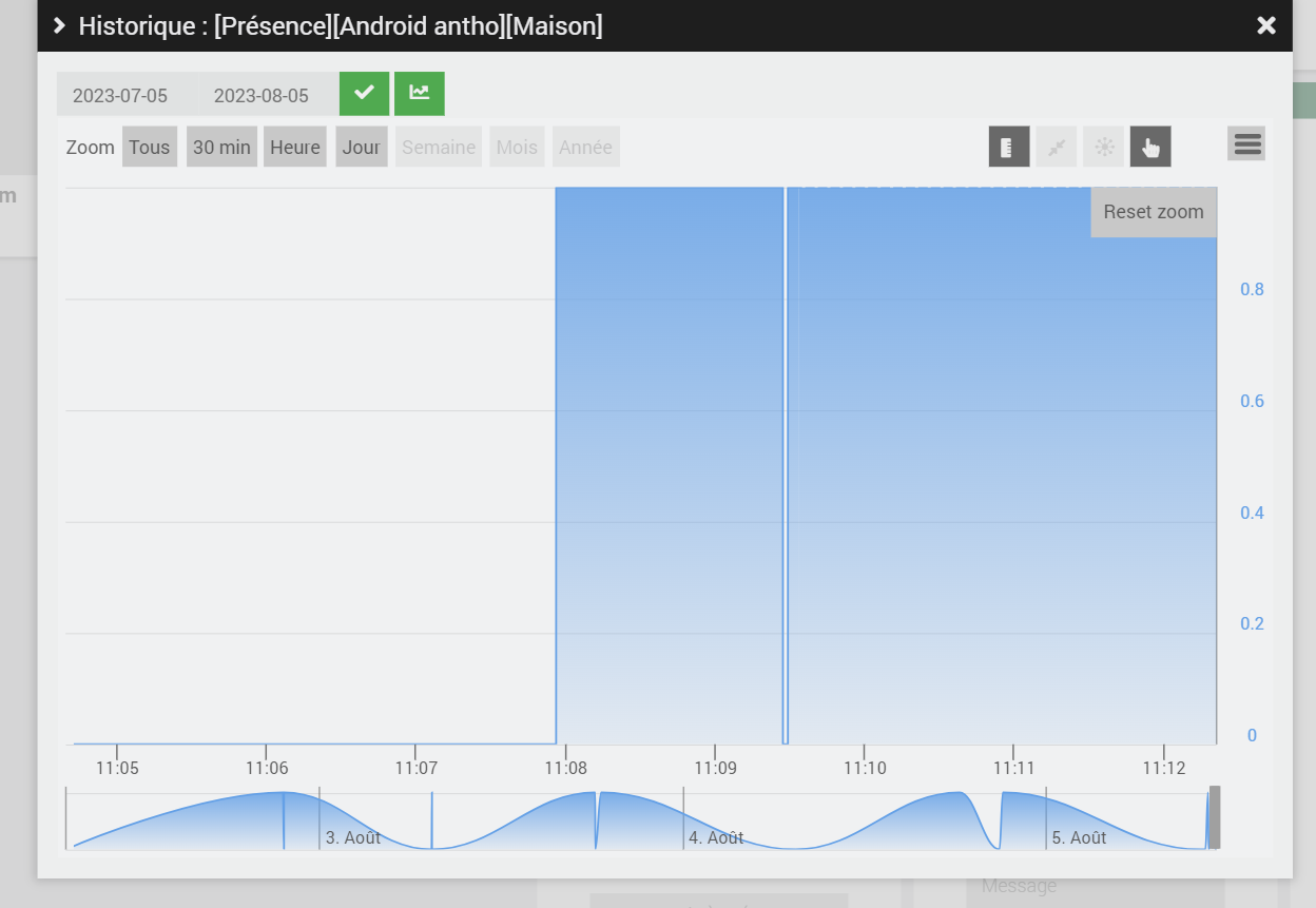

j’ouvre ce sujet car depuis le mois de juin où je suis passé sur un oneplus, je rencontre des problémes de localisation.
je m’explique :
il me localise bien où je suis mais par exemple quand je suis chez moi, il me voit de temps en temps plus chez moi alors que je ne bouge pas. du coup tout mes scénario d’absence démarre
Exemple :
on voit bien qu’entre 11h09 et 11h10 j’ai une une absence de ma position.

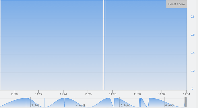

Rebelotte au jourd’hui à 11h27
[2023-08-06 11:27:20][DEBUG] : [API] Request Received {"params":{"is_moving":true,"uuid":"3dceaf05-67a2-4a74-a26b-5b9662f4f50b","timestamp":"2023-08-06T08:28:02.611Z","timestampMeta":{"time":1691310482611,"systemTime":1691314033810,"systemClockElaspsedRealtime":547922743,"elapsedRealtime":544371545},"odometer":4726884,"coords":{"latitude":43.5957608,"longitude":1.5683434,"accuracy":30,"speed":14.44,"speed_accuracy":1.71,"heading":337.72,"heading_accuracy":4.7,"altitude":249.1,"ellipsoidal_altitude":249.1,"altitude_accuracy":21.4},"activity":{"type":"still","confidence":100},"battery":{"is_charging":false,"level":0.58},"extras":{}},"id":"f59ab30a7ce88af58d3e13ec6d88b076","method":"GEOLOC","jsonrpc":"2.0"}
[2023-08-06 11:27:20][DEBUG] : [setGeofencesByCoordinates] 43.5957608 -- 1.5683434
[2023-08-06 11:27:20][DEBUG] : Set 0 for geofence Maison
[2023-08-06 11:27:20][DEBUG] : [API] Send GEOLOC -> null
[2023-08-06 11:27:20][DEBUG] : [API] Request Received {"params":{"is_moving":true,"uuid":"88dc46b4-edf6-403b-ad7b-1dbfadc70ca3","timestamp":"2023-08-06T08:28:13.612Z","timestampMeta":{"time":1691310493612,"systemTime":1691314033844,"systemClockElaspsedRealtime":547922777,"elapsedRealtime":544382545},"odometer":4726999.5,"coords":{"latitude":43.596246,"longitude":1.5670802,"accuracy":7.1,"speed":18.96,"speed_accuracy":3.48,"heading":298.52,"heading_accuracy":5.88,"altitude":249.1,"ellipsoidal_altitude":249.1,"altitude_accuracy":21.5},"activity":{"type":"still","confidence":100},"battery":{"is_charging":false,"level":0.58},"extras":{}},"id":"f59ab30a7ce88af58d3e13ec6d88b076","method":"GEOLOC","jsonrpc":"2.0"}
[2023-08-06 11:27:20][DEBUG] : [setGeofencesByCoordinates] 43.596246 -- 1.5670802
[2023-08-06 11:27:20][DEBUG] : [API] Request Received {"params":{"is_moving":true,"uuid":"b2efd6b7-3cc6-4ca5-bd55-1d6b318684a2","timestamp":"2023-08-06T08:28:21.612Z","timestampMeta":{"time":1691310501612,"systemTime":1691314033891,"systemClockElaspsedRealtime":547922825,"elapsedRealtime":544390545},"odometer":4727130,"coords":{"latitude":43.5969584,"longitude":1.5657949,"accuracy":6.6,"speed":11.95,"speed_accuracy":2.93,"heading":308.31,"heading_accuracy":8.07,"altitude":249.1,"ellipsoidal_altitude":249.1,"altitude_accuracy":21.6},"activity":{"type":"still","confidence":100},"battery":{"is_charging":false,"level":0.58},"extras":{}},"id":"f59ab30a7ce88af58d3e13ec6d88b076","method":"GEOLOC","jsonrpc":"2.0"}
[2023-08-06 11:27:21][DEBUG] : [setGeofencesByCoordinates] 43.5969584 -- 1.5657949
[2023-08-06 11:27:21][DEBUG] : [API] Send GEOLOC -> null
[2023-08-06 11:27:21][DEBUG] : [API] Request Received {"params":{"is_moving":true,"uuid":"372dbe69-6d30-44b8-a31f-faea228e2fdc","timestamp":"2023-08-06T08:28:29.611Z","timestampMeta":{"time":1691310509611,"systemTime":1691314033927,"systemClockElaspsedRealtime":547922860,"elapsedRealtime":544398544},"odometer":4727208.5,"coords":{"latitude":43.5967483,"longitude":1.5648693,"accuracy":9.7,"speed":14.93,"speed_accuracy":0.81,"heading":232.01,"heading_accuracy":1.44,"altitude":249.1,"ellipsoidal_altitude":249.1,"altitude_accuracy":21.7},"activity":{"type":"still","confidence":100},"battery":{"is_charging":false,"level":0.58},"extras":{}},"id":"f59ab30a7ce88af58d3e13ec6d88b076","method":"GEOLOC","jsonrpc":"2.0"}
[2023-08-06 11:27:21][DEBUG] : [setGeofencesByCoordinates] 43.5967483 -- 1.5648693
[2023-08-06 11:27:21][DEBUG] : [API] Request Received {"params":{"is_moving":true,"uuid":"653d00ff-a7b2-4b6a-86c7-9d95b1c35267","timestamp":"2023-08-06T08:28:35.612Z","timestampMeta":{"time":1691310515612,"systemTime":1691314033963,"systemClockElaspsedRealtime":547922896,"elapsedRealtime":544404545},"odometer":4727312,"coords":{"latitude":43.5961088,"longitude":1.5639396,"accuracy":6.5,"speed":15.28,"speed_accuracy":2.87,"heading":227.33,"heading_accuracy":6.16,"altitude":249.1,"ellipsoidal_altitude":249.1,"altitude_accuracy":21.7},"activity":{"type":"still","confidence":100},"battery":{"is_charging":false,"level":0.58},"extras":{}},"id":"f59ab30a7ce88af58d3e13ec6d88b076","method":"GEOLOC","jsonrpc":"2.0"}
[2023-08-06 11:27:21][DEBUG] : [setGeofencesByCoordinates] 43.5961088 -- 1.5639396
[2023-08-06 11:27:21][DEBUG] : [API] Request Received {"params":{"is_moving":true,"uuid":"b47c1647-82c1-4ab9-8279-8c5559a998cc","timestamp":"2023-08-06T08:28:43.612Z","timestampMeta":{"time":1691310523612,"systemTime":1691314033977,"systemClockElaspsedRealtime":547922911,"elapsedRealtime":544412545},"odometer":4727424,"coords":{"latitude":43.5953471,"longitude":1.563029,"accuracy":4.8,"speed":14.43,"speed_accuracy":1.21,"heading":218.06,"heading_accuracy":3.68,"altitude":249.1,"ellipsoidal_altitude":249.1,"altitude_accuracy":21.8},"activity":{"type":"still","confidence":100},"battery":{"is_charging":false,"level":0.58},"extras":{}},"id":"f59ab30a7ce88af58d3e13ec6d88b076","method":"GEOLOC","jsonrpc":"2.0"}
[2023-08-06 11:27:21][DEBUG] : [setGeofencesByCoordinates] 43.5953471 -- 1.563029
[2023-08-06 11:27:41][DEBUG] : [API] Request Received {"params":{"is_moving":true,"uuid":"b3368661-0a57-4246-a181-402944873563","timestamp":"2023-08-06T09:05:38.604Z","timestampMeta":{"time":1691312738604,"systemTime":1691314037598,"systemClockElaspsedRealtime":547926531,"elapsedRealtime":546627537},"odometer":4739435,"coords":{"latitude":43.5920319,"longitude":1.4991622,"accuracy":10.6,"speed":5.24,"speed_accuracy":1.9,"heading":343.08,"heading_accuracy":21.47,"altitude":190.5,"ellipsoidal_altitude":190.5,"altitude_accuracy":18.5},"activity":{"type":"still","confidence":100},"battery":{"is_charging":false,"level":0.58},"extras":{}},"id":"f59ab30a7ce88af58d3e13ec6d88b076","method":"GEOLOC","jsonrpc":"2.0"}
[2023-08-06 11:27:41][DEBUG] : [setGeofencesByCoordinates] 43.5920319 -- 1.4991622
[2023-08-06 11:27:41][DEBUG] : [API] Send GEOLOC -> null
les logs sont coupé du au nombre de caractéres. mais j’ai d’énorme log environ 250000 caratéres entre 11h27:21 et 11h27:41.

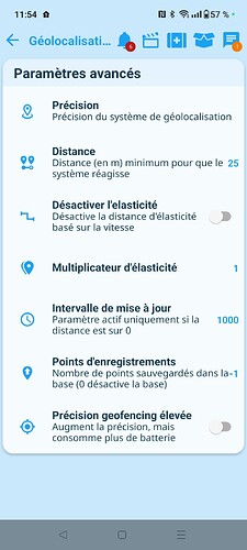

le paramétrage de mon appli
je pense que le probléme ne vient pas du plugin mais plius de la configuration de mpon téléphone, mais je n’arrive pas à trouver.
