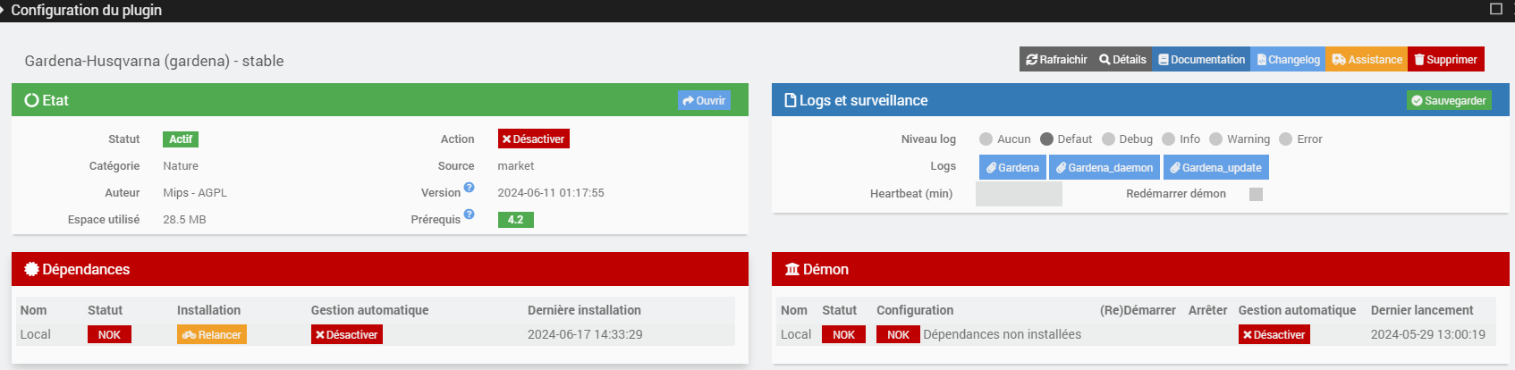

Bonjour à tous, et surtout à @Mips
J’ai un problème avec le pluging Gardena dont les dépendances ne démarrent plus.
Page santé :
Impossible de démarrer les dépendances :

Collecting typing-extensions>=4.1 (from anyio->httpx==0.27.0->-r /var/www/html/plugins/gardena/resources/requirements.txt (line 5))
Using cached typing_extensions-4.12.2-py3-none-any.whl.metadata (3.0 kB)
Collecting cffi>=1.12 (from cryptography->Authlib==1.3.1->-r /var/www/html/plugins/gardena/resources/requirements.txt (line 4))
Using cached cffi-1.16.0-cp39-cp39-linux_armv7l.whl
Collecting pycparser (from cffi>=1.12->cryptography->Authlib==1.3.1->-r /var/www/html/plugins/gardena/resources/requirements.txt (line 4))
Using cached pycparser-2.22-py3-none-any.whl.metadata (943 bytes)
Using cached Authlib-1.3.1-py2.py3-none-any.whl (223 kB)
Using cached httpx-0.27.0-py3-none-any.whl (75 kB)
Using cached httpcore-1.0.5-py3-none-any.whl (77 kB)
Using cached oauthlib-3.2.2-py3-none-any.whl (151 kB)
Using cached websockets-12.0-py3-none-any.whl (118 kB)
Using cached jeedomdaemon-0.9.8-py3-none-any.whl (12 kB)
Using cached anyio-4.4.0-py3-none-any.whl (86 kB)
Using cached idna-3.7-py3-none-any.whl (66 kB)
Using cached sniffio-1.3.1-py3-none-any.whl (10 kB)
Using cached certifi-2024.6.2-py3-none-any.whl (164 kB)
Using cached aiosignal-1.3.1-py3-none-any.whl (7.6 kB)
Using cached async_timeout-4.0.3-py3-none-any.whl (5.7 kB)
Using cached attrs-23.2.0-py3-none-any.whl (60 kB)
Using cached exceptiongroup-1.2.1-py3-none-any.whl (16 kB)
Using cached frozenlist-1.4.1-py3-none-any.whl (11 kB)
Using cached h11-0.14.0-py3-none-any.whl (58 kB)
Using cached multidict-6.0.5-py3-none-any.whl (9.7 kB)
Using cached typing_extensions-4.12.2-py3-none-any.whl (37 kB)
Using cached yarl-1.9.4-py3-none-any.whl (31 kB)
Using cached pycparser-2.22-py3-none-any.whl (117 kB)
Building wheels for collected packages: cryptography
Building wheel for cryptography (pyproject.toml): started
Building wheel for cryptography (pyproject.toml): finished with status 'error'
error: subprocess-exited-with-error
× Building wheel for cryptography (pyproject.toml) did not run successfully.
│ exit code: 1
╰─> [139 lines of output]
running bdist_wheel
running build
running build_py
creating build
creating build/lib.linux-armv7l-cpython-39
creating build/lib.linux-armv7l-cpython-39/cryptography
copying src/cryptography/exceptions.py -> build/lib.linux-armv7l-cpython-39/cryptography
copying src/cryptography/fernet.py -> build/lib.linux-armv7l-cpython-39/cryptography
copying src/cryptography/utils.py -> build/lib.linux-armv7l-cpython-39/cryptography
copying src/cryptography/__init__.py -> build/lib.linux-armv7l-cpython-39/cryptography
copying src/cryptography/__about__.py -> build/lib.linux-armv7l-cpython-39/cryptography
creating build/lib.linux-armv7l-cpython-39/cryptography/x509
copying src/cryptography/x509/oid.py -> build/lib.linux-armv7l-cpython-39/cryptography/x509
copying src/cryptography/x509/ocsp.py -> build/lib.linux-armv7l-cpython-39/cryptography/x509
copying src/cryptography/x509/verification.py -> build/lib.linux-armv7l-cpython-39/cryptography/x509
copying src/cryptography/x509/certificate_transparency.py -> build/lib.linux-armv7l-cpython-39/cryptography/x509
copying src/cryptography/x509/base.py -> build/lib.linux-armv7l-cpython-39/cryptography/x509
copying src/cryptography/x509/name.py -> build/lib.linux-armv7l-cpython-39/cryptography/x509
copying src/cryptography/x509/general_name.py -> build/lib.linux-armv7l-cpython-39/cryptography/x509
copying src/cryptography/x509/extensions.py -> build/lib.linux-armv7l-cpython-39/cryptography/x509
copying src/cryptography/x509/__init__.py -> build/lib.linux-armv7l-cpython-39/cryptography/x509
creating build/lib.linux-armv7l-cpython-39/cryptography/hazmat
copying src/cryptography/hazmat/_oid.py -> build/lib.linux-armv7l-cpython-39/cryptography/hazmat
copying src/cryptography/hazmat/__init__.py -> build/lib.linux-armv7l-cpython-39/cryptography/hazmat
creating build/lib.linux-armv7l-cpython-39/cryptography/hazmat/bindings
copying src/cryptography/hazmat/bindings/__init__.py -> build/lib.linux-armv7l-cpython-39/cryptography/hazmat/bindings
creating build/lib.linux-armv7l-cpython-39/cryptography/hazmat/backends
copying src/cryptography/hazmat/backends/__init__.py -> build/lib.linux-armv7l-cpython-39/cryptography/hazmat/backends
creating build/lib.linux-armv7l-cpython-39/cryptography/hazmat/primitives
copying src/cryptography/hazmat/primitives/poly1305.py -> build/lib.linux-armv7l-cpython-39/cryptography/hazmat/primitives
copying src/cryptography/hazmat/primitives/hashes.py -> build/lib.linux-armv7l-cpython-39/cryptography/hazmat/primitives
copying src/cryptography/hazmat/primitives/_serialization.py -> build/lib.linux-armv7l-cpython-39/cryptography/hazmat/primitives
copying src/cryptography/hazmat/primitives/keywrap.py -> build/lib.linux-armv7l-cpython-39/cryptography/hazmat/primitives
copying src/cryptography/hazmat/primitives/_cipheralgorithm.py -> build/lib.linux-armv7l-cpython-39/cryptography/hazmat/primitives
copying src/cryptography/hazmat/primitives/hmac.py -> build/lib.linux-armv7l-cpython-39/cryptography/hazmat/primitives
copying src/cryptography/hazmat/primitives/padding.py -> build/lib.linux-armv7l-cpython-39/cryptography/hazmat/primitives
copying src/cryptography/hazmat/primitives/_asymmetric.py -> build/lib.linux-armv7l-cpython-39/cryptography/hazmat/primitives
copying src/cryptography/hazmat/primitives/cmac.py -> build/lib.linux-armv7l-cpython-39/cryptography/hazmat/primitives
copying src/cryptography/hazmat/primitives/__init__.py -> build/lib.linux-armv7l-cpython-39/cryptography/hazmat/primitives
copying src/cryptography/hazmat/primitives/constant_time.py -> build/lib.linux-armv7l-cpython-39/cryptography/hazmat/primitives
creating build/lib.linux-armv7l-cpython-39/cryptography/hazmat/bindings/openssl
copying src/cryptography/hazmat/bindings/openssl/binding.py -> build/lib.linux-armv7l-cpython-39/cryptography/hazmat/bindings/openssl
copying src/cryptography/hazmat/bindings/openssl/__init__.py -> build/lib.linux-armv7l-cpython-39/cryptography/hazmat/bindings/openssl
copying src/cryptography/hazmat/bindings/openssl/_conditional.py -> build/lib.linux-armv7l-cpython-39/cryptography/hazmat/bindings/openssl
creating build/lib.linux-armv7l-cpython-39/cryptography/hazmat/backends/openssl
copying src/cryptography/hazmat/backends/openssl/decode_asn1.py -> build/lib.linux-armv7l-cpython-39/cryptography/hazmat/backends/openssl
copying src/cryptography/hazmat/backends/openssl/ciphers.py -> build/lib.linux-armv7l-cpython-39/cryptography/hazmat/backends/openssl
copying src/cryptography/hazmat/backends/openssl/aead.py -> build/lib.linux-armv7l-cpython-39/cryptography/hazmat/backends/openssl
copying src/cryptography/hazmat/backends/openssl/backend.py -> build/lib.linux-armv7l-cpython-39/cryptography/hazmat/backends/openssl
copying src/cryptography/hazmat/backends/openssl/__init__.py -> build/lib.linux-armv7l-cpython-39/cryptography/hazmat/backends/openssl
creating build/lib.linux-armv7l-cpython-39/cryptography/hazmat/primitives/asymmetric
copying src/cryptography/hazmat/primitives/asymmetric/x448.py -> build/lib.linux-armv7l-cpython-39/cryptography/hazmat/primitives/asymmetric
copying src/cryptography/hazmat/primitives/asymmetric/dh.py -> build/lib.linux-armv7l-cpython-39/cryptography/hazmat/primitives/asymmetric
copying src/cryptography/hazmat/primitives/asymmetric/dsa.py -> build/lib.linux-armv7l-cpython-39/cryptography/hazmat/primitives/asymmetric
copying src/cryptography/hazmat/primitives/asymmetric/ed448.py -> build/lib.linux-armv7l-cpython-39/cryptography/hazmat/primitives/asymmetric
copying src/cryptography/hazmat/primitives/asymmetric/ec.py -> build/lib.linux-armv7l-cpython-39/cryptography/hazmat/primitives/asymmetric
copying src/cryptography/hazmat/primitives/asymmetric/padding.py -> build/lib.linux-armv7l-cpython-39/cryptography/hazmat/primitives/asymmetric
copying src/cryptography/hazmat/primitives/asymmetric/rsa.py -> build/lib.linux-armv7l-cpython-39/cryptography/hazmat/primitives/asymmetric
copying src/cryptography/hazmat/primitives/asymmetric/types.py -> build/lib.linux-armv7l-cpython-39/cryptography/hazmat/primitives/asymmetric
copying src/cryptography/hazmat/primitives/asymmetric/x25519.py -> build/lib.linux-armv7l-cpython-39/cryptography/hazmat/primitives/asymmetric
copying src/cryptography/hazmat/primitives/asymmetric/utils.py -> build/lib.linux-armv7l-cpython-39/cryptography/hazmat/primitives/asymmetric
copying src/cryptography/hazmat/primitives/asymmetric/__init__.py -> build/lib.linux-armv7l-cpython-39/cryptography/hazmat/primitives/asymmetric
copying src/cryptography/hazmat/primitives/asymmetric/ed25519.py -> build/lib.linux-armv7l-cpython-39/cryptography/hazmat/primitives/asymmetric
creating build/lib.linux-armv7l-cpython-39/cryptography/hazmat/primitives/twofactor
copying src/cryptography/hazmat/primitives/twofactor/totp.py -> build/lib.linux-armv7l-cpython-39/cryptography/hazmat/primitives/twofactor
copying src/cryptography/hazmat/primitives/twofactor/hotp.py -> build/lib.linux-armv7l-cpython-39/cryptography/hazmat/primitives/twofactor
copying src/cryptography/hazmat/primitives/twofactor/__init__.py -> build/lib.linux-armv7l-cpython-39/cryptography/hazmat/primitives/twofactor
creating build/lib.linux-armv7l-cpython-39/cryptography/hazmat/primitives/serialization
copying src/cryptography/hazmat/primitives/serialization/pkcs7.py -> build/lib.linux-armv7l-cpython-39/cryptography/hazmat/primitives/serialization
copying src/cryptography/hazmat/primitives/serialization/base.py -> build/lib.linux-armv7l-cpython-39/cryptography/hazmat/primitives/serialization
copying src/cryptography/hazmat/primitives/serialization/pkcs12.py -> build/lib.linux-armv7l-cpython-39/cryptography/hazmat/primitives/serialization
copying src/cryptography/hazmat/primitives/serialization/__init__.py -> build/lib.linux-armv7l-cpython-39/cryptography/hazmat/primitives/serialization
copying src/cryptography/hazmat/primitives/serialization/ssh.py -> build/lib.linux-armv7l-cpython-39/cryptography/hazmat/primitives/serialization
creating build/lib.linux-armv7l-cpython-39/cryptography/hazmat/primitives/ciphers
copying src/cryptography/hazmat/primitives/ciphers/modes.py -> build/lib.linux-armv7l-cpython-39/cryptography/hazmat/primitives/ciphers
copying src/cryptography/hazmat/primitives/ciphers/aead.py -> build/lib.linux-armv7l-cpython-39/cryptography/hazmat/primitives/ciphers
copying src/cryptography/hazmat/primitives/ciphers/base.py -> build/lib.linux-armv7l-cpython-39/cryptography/hazmat/primitives/ciphers
copying src/cryptography/hazmat/primitives/ciphers/algorithms.py -> build/lib.linux-armv7l-cpython-39/cryptography/hazmat/primitives/ciphers
copying src/cryptography/hazmat/primitives/ciphers/__init__.py -> build/lib.linux-armv7l-cpython-39/cryptography/hazmat/primitives/ciphers
creating build/lib.linux-armv7l-cpython-39/cryptography/hazmat/primitives/kdf
copying src/cryptography/hazmat/primitives/kdf/scrypt.py -> build/lib.linux-armv7l-cpython-39/cryptography/hazmat/primitives/kdf
copying src/cryptography/hazmat/primitives/kdf/concatkdf.py -> build/lib.linux-armv7l-cpython-39/cryptography/hazmat/primitives/kdf
copying src/cryptography/hazmat/primitives/kdf/pbkdf2.py -> build/lib.linux-armv7l-cpython-39/cryptography/hazmat/primitives/kdf
copying src/cryptography/hazmat/primitives/kdf/hkdf.py -> build/lib.linux-armv7l-cpython-39/cryptography/hazmat/primitives/kdf
copying src/cryptography/hazmat/primitives/kdf/kbkdf.py -> build/lib.linux-armv7l-cpython-39/cryptography/hazmat/primitives/kdf
copying src/cryptography/hazmat/primitives/kdf/__init__.py -> build/lib.linux-armv7l-cpython-39/cryptography/hazmat/primitives/kdf
copying src/cryptography/hazmat/primitives/kdf/x963kdf.py -> build/lib.linux-armv7l-cpython-39/cryptography/hazmat/primitives/kdf
running egg_info
writing src/cryptography.egg-info/PKG-INFO
writing dependency_links to src/cryptography.egg-info/dependency_links.txt
writing requirements to src/cryptography.egg-info/requires.txt
writing top-level names to src/cryptography.egg-info/top_level.txt
reading manifest file 'src/cryptography.egg-info/SOURCES.txt'
reading manifest template 'MANIFEST.in'
warning: no files found matching '*.c' under directory 'src/_cffi_src'
warning: no files found matching '*.h' under directory 'src/_cffi_src'
no previously-included directories found matching 'docs/_build'
warning: no previously-included files found matching 'vectors'
warning: no previously-included files matching '*' found under directory 'vectors'
warning: no previously-included files found matching 'src/rust/target'
warning: no previously-included files matching '*' found under directory 'src/rust/target'
warning: no previously-included files matching '*' found under directory '.github'
warning: no previously-included files found matching 'release.py'
warning: no previously-included files found matching '.readthedocs.yml'
warning: no previously-included files found matching 'ci-constraints-requirements.txt'
warning: no previously-included files found matching 'mypy.ini'
adding license file 'LICENSE'
adding license file 'LICENSE.APACHE'
adding license file 'LICENSE.BSD'
writing manifest file 'src/cryptography.egg-info/SOURCES.txt'
copying src/cryptography/py.typed -> build/lib.linux-armv7l-cpython-39/cryptography
creating build/lib.linux-armv7l-cpython-39/cryptography/hazmat/bindings/_rust
copying src/cryptography/hazmat/bindings/_rust/__init__.pyi -> build/lib.linux-armv7l-cpython-39/cryptography/hazmat/bindings/_rust
copying src/cryptography/hazmat/bindings/_rust/_openssl.pyi -> build/lib.linux-armv7l-cpython-39/cryptography/hazmat/bindings/_rust
copying src/cryptography/hazmat/bindings/_rust/asn1.pyi -> build/lib.linux-armv7l-cpython-39/cryptography/hazmat/bindings/_rust
copying src/cryptography/hazmat/bindings/_rust/exceptions.pyi -> build/lib.linux-armv7l-cpython-39/cryptography/hazmat/bindings/_rust
copying src/cryptography/hazmat/bindings/_rust/ocsp.pyi -> build/lib.linux-armv7l-cpython-39/cryptography/hazmat/bindings/_rust
copying src/cryptography/hazmat/bindings/_rust/pkcs7.pyi -> build/lib.linux-armv7l-cpython-39/cryptography/hazmat/bindings/_rust
copying src/cryptography/hazmat/bindings/_rust/x509.pyi -> build/lib.linux-armv7l-cpython-39/cryptography/hazmat/bindings/_rust
creating build/lib.linux-armv7l-cpython-39/cryptography/hazmat/bindings/_rust/openssl
copying src/cryptography/hazmat/bindings/_rust/openssl/__init__.pyi -> build/lib.linux-armv7l-cpython-39/cryptography/hazmat/bindings/_rust/openssl
copying src/cryptography/hazmat/bindings/_rust/openssl/aead.pyi -> build/lib.linux-armv7l-cpython-39/cryptography/hazmat/bindings/_rust/openssl
copying src/cryptography/hazmat/bindings/_rust/openssl/cmac.pyi -> build/lib.linux-armv7l-cpython-39/cryptography/hazmat/bindings/_rust/openssl
copying src/cryptography/hazmat/bindings/_rust/openssl/dh.pyi -> build/lib.linux-armv7l-cpython-39/cryptography/hazmat/bindings/_rust/openssl
copying src/cryptography/hazmat/bindings/_rust/openssl/dsa.pyi -> build/lib.linux-armv7l-cpython-39/cryptography/hazmat/bindings/_rust/openssl
copying src/cryptography/hazmat/bindings/_rust/openssl/ec.pyi -> build/lib.linux-armv7l-cpython-39/cryptography/hazmat/bindings/_rust/openssl
copying src/cryptography/hazmat/bindings/_rust/openssl/ed25519.pyi -> build/lib.linux-armv7l-cpython-39/cryptography/hazmat/bindings/_rust/openssl
copying src/cryptography/hazmat/bindings/_rust/openssl/ed448.pyi -> build/lib.linux-armv7l-cpython-39/cryptography/hazmat/bindings/_rust/openssl
copying src/cryptography/hazmat/bindings/_rust/openssl/hashes.pyi -> build/lib.linux-armv7l-cpython-39/cryptography/hazmat/bindings/_rust/openssl
copying src/cryptography/hazmat/bindings/_rust/openssl/hmac.pyi -> build/lib.linux-armv7l-cpython-39/cryptography/hazmat/bindings/_rust/openssl
copying src/cryptography/hazmat/bindings/_rust/openssl/kdf.pyi -> build/lib.linux-armv7l-cpython-39/cryptography/hazmat/bindings/_rust/openssl
copying src/cryptography/hazmat/bindings/_rust/openssl/keys.pyi -> build/lib.linux-armv7l-cpython-39/cryptography/hazmat/bindings/_rust/openssl
copying src/cryptography/hazmat/bindings/_rust/openssl/poly1305.pyi -> build/lib.linux-armv7l-cpython-39/cryptography/hazmat/bindings/_rust/openssl
copying src/cryptography/hazmat/bindings/_rust/openssl/rsa.pyi -> build/lib.linux-armv7l-cpython-39/cryptography/hazmat/bindings/_rust/openssl
copying src/cryptography/hazmat/bindings/_rust/openssl/x25519.pyi -> build/lib.linux-armv7l-cpython-39/cryptography/hazmat/bindings/_rust/openssl
copying src/cryptography/hazmat/bindings/_rust/openssl/x448.pyi -> build/lib.linux-armv7l-cpython-39/cryptography/hazmat/bindings/_rust/openssl
running build_ext
running build_rust
error: Rust 1.41.1 does not match extension requirement >=1.63.0
[end of output]
note: This error originates from a subprocess, and is likely not a problem with pip.
ERROR: Failed building wheel for cryptography
Failed to build cryptography
ERROR: Could not build wheels for cryptography, which is required to install pyproject.toml-based projects

Malheureusement, après de nombreux essais, j’ai toujours les mêmes erreurs :
running build_ext
running build_rust
[end of output]
Ce que j’ai fait :
Mettre à jour le système
Exécuter les commandes, sans problème particulier
$ sudo su -
# curl -o rustup.sh -sSf https://sh.rustup.rs
# chmod +x rustup.sh
# ./rustup.sh
Mips
Juin 19, 2024, 8:46
20
moi je n’ai plus d’idée, à part abandonner buster.
manifestement la version de rust dispo n’est pas la suffisante et pour l’instant j’ignore comment faire pour l’obtenir sous buster
c’est peut-etre egalement dû à un swap trop faible et/ou plus de mémoire dispo sans certitude.
