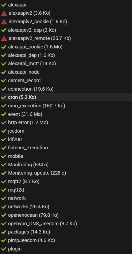

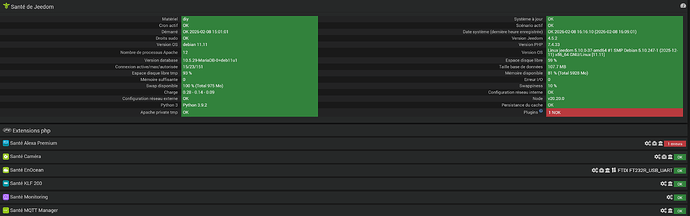

Voici la page santé.
le log alexaapiv2_cookie
0009|[08/02/2026 16:10:07] ERROR  : => Alexa-Cookie:: WARNING Get User data : SyntaxError: Unexpected end of JSON input
0010|[08/02/2026 16:10:07] INFO  : ⚠️⚠️⚠️🔴 ********* NE JAMAIS DIFFUSER CES LOGS EN PUBLIC ********* 🔴⚠️⚠️⚠️
0011|[08/02/2026 16:10:07] ERROR  : getCookie::generateAlexaCookie err: Unexpected end of JSON input >> null
le log alexaapiv2_remote
0009|[08/02/2026 16:10:01] INFO  : {AlexaDaemon}::config{"cookieLocation":"/var/www/html/plugins/alexaapiv2/resources/data/alexa-cookie.json","proxyOwnIp":"192.168.x.x","proxyPort":3457,"amazonPage":"amazon.com","baseAmazonPage":"amazon.fr","amazonserver":"amazon.com","amazonPageProxyLanguage":"fr-FR","acceptLanguage":"fr-FR","userAgent":"","listeningPort":"3467","proxyLogLevel":"info","deviceAppName":"Jee_AlexaPrem100","formerDataStorePath":"/var/www/html/plugins/alexaapiv2/resources/data/alexa-cookie.json","cookieRefreshInterval":86400000,"autoQueryActivityOnTrigger":true,"bluetooth":true,"useWsMqtt":true,"proxyCloseWindowHTML":"<div style=\"display:flex;flex-direction: column;align-items: center;\">\n\t\t<img width=\"100px\" src=\"http://192.168.x.x/plugins/alexaapiv2/core/img/pouce.png\" />\n\t\t<br><br><p>You can close this window...</p></div>\n\t\t<script>setTimeout(function(){self.close();}, 3000);</script>"}
0010|[08/02/2026 16:10:01] INFO  : {AlexaDaemon}::argv["/usr/bin/node","/var/www/html/plugins/alexaapiv2/resources/initRemote.js","192.168.x.x","amazon.com","xxxxxxxx9sJxYI9y0vq1bBFzZugl2wiJRUDYAzdllUdqPqNDlZ0Wf10B47vG0","INFO","fr-FR","3467","true"]
0011|[08/02/2026 16:10:01] INFO  : {AlexaDaemon}  ╔══════════════════════════════════════════════════════════════════════╗
0012|[08/02/2026 16:10:01] ERROR  : {AlexaDaemon}  ║	ERROR									  			  			║
0013|[08/02/2026 16:10:01] INFO  : {AlexaDaemon}  ║	Une erreur est survenue,  Relancez la génération du COOKIE AMAZON ║
0014|[08/02/2026 16:10:01] INFO  : {AlexaDaemon}  ║	Message: Error: Invalid Or Empty Json! Données du Json invalides ou informations manquantes!  											 ║
0015|[08/02/2026 16:10:01] INFO  : {AlexaDaemon}  ╚══════════════════════════════════════════════════════════════════════╝
