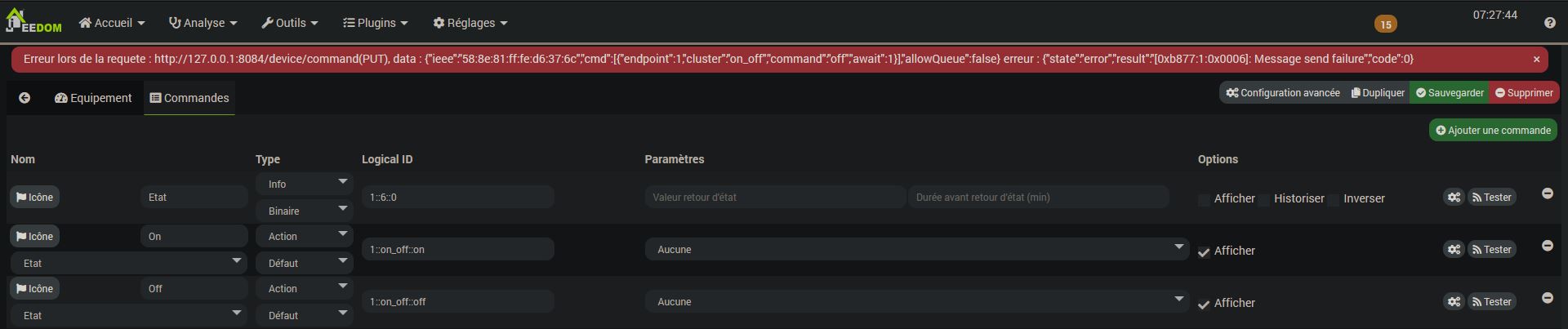

Merci olive pour ta réponse rapide. Oui je confirme j’ai bien le niveau mais pas le type que j’ai par exemple
dans le xiaomi capteur d ouverture
"ieee": "00:15:8d:00:04:52:82:d2",
"nwk": 9650,
"status": 2,
"lqi": "255",
"rssi": "-40",
"last_seen": "1612371876.7880597",
"node_descriptor": "02:40:80:37:10:7f:64:00:00:00:64:00:00",
"endpoints": [
"id": 1,
"status": 1,
"device_type": 2128,
"profile_id": 260,
"manufacturer": "LUMI",
"model": "lumi.sensor_magnet",
"output_clusters": [
"id": 0,
"name": "BasicCluster",
"attributes": []
"id": 6,
"name": "On\/Off",
"attributes": []
"id": 4,
"name": "Groups",
"attributes": []
"id": 3,
"name": "Identify",
"attributes": []
"id": 8,
"name": "Level control",
"attributes": []
"id": 5,
"name": "Scenes",
"attributes": []
"id": 25,
"name": "Ota",
"attributes": []
"input_clusters": [
"id": 0,
"attributes": [
"id": 1,
"name": "app_version",
"value": 10
"id": 4,
"name": "manufacturer",
"value": "LUMI"
"id": 5,
"name": "model",
"value": "lumi.sensor_magnet"
"id": 3,
"name": "Identify",
"attributes": []
"id": 1,
"name": "Power Configuration",
"attributes": [
"id": 32,
"name": "battery_voltage",
"value": 30
"id": 33,
"name": "battery_percentage_remaining",
"value": 111
"id": 65535,
"name": "Manufacturer Specific",
"attributes": []
"id": 25,
"name": "Ota",
"attributes": []
"signature": {
"node_desc": {
"byte1": 2,
"byte2": 64,
"mac_capability_flags": 128,
"manufacturer_code": 4151,
"maximum_buffer_size": 127,
"maximum_incoming_transfer_size": 100,
"server_mask": 0,
"maximum_outgoing_transfer_size": 100,
"endpoints": {
"1": {
"profile_id": 260,
"input_clusters": [
0,
3,
1,
65535,
25
0,
6,
4,
3,
8,
5,
25
"class": "zhaquirks.xiaomi.mija.sensor_magnet"
pour l’apostrophe, pas grave mais dommage car je l’utilise pour d’autre objet sans probleme
Merci encore
