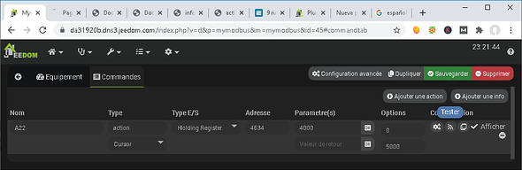

J’utilise mymodbus:
Les commandes d’actions binaires les écrivent bien (coil). Mais pas le holding register. Si je lui donne un test (comme on le voit sur l’image TESTER), il exécute l’action et envoie le numéro via Modbus correctement.
Mais en mode curseur ou bouton, (dans la visualisation), je modifie la valeur, mais il n’envoie rien
Suis-je en train de manquer quelque chose?
A la place de ta valeur parametre mets #slider# de mémoire c’est le tag de la valeur de ton curseur.

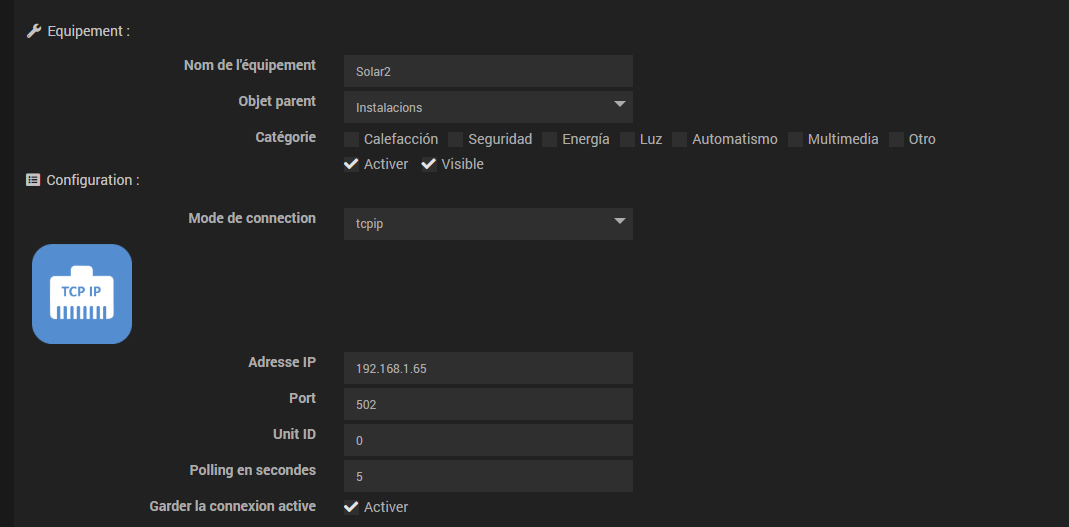

Hi,
First of all thank you @Bebel27 for your great work and dedication.

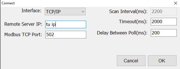

I’m trying to read some registers from my Huawei solar inverter.
I’ve made through them with PC software Modbus Master Tool, but I can’t succeed with your plugin.
I attach some screenshots:
PC software:
With no results when i test them…
Thanks in advance!
PD: Sorry for chaining messages, but I have the limitation of two images per post…

Hello, try with « Adresse » : 79 for the first and 80 for the second
Hello Can you join the Plugins logs? Before, try to configure in holding register int.

Hi,
@Bison, not luck with your trick…
I changed from holding register to register int, but not results.
I still can’t attach files so I have to paste the log…
