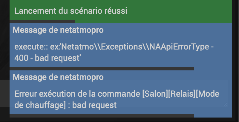

j’ai le même problème qui a été remonté le 25 juillet, le plugin reçoit bien les infos de netatmo, mais quand l’exécute mon script qui passe le planning en mode planning et ou absent ( donc en voie jeedom>netatmo ) j’ai l’erreur bad request
voici le log:
0000|[2025-09-08 21:24:01][DEBUG] : execute:: options:array (   'background' => '0',   'select' => '2', )
0001|[2025-09-08 21:24:01][DEBUG] : execute:: this:\netatmoproCmd::__set_state(array(    'id' => 1724,    'logicalId' => 'setthermmode',    'generic_type' => NULL,    'eqType' => 'netatmopro',    'name' => 'Mode de chauffage',    'order' => 1,    'type' => 'action',    'subType' => 'select',    'eqLogic_id' => 185,    'isHistorized' => '0',    'unite' => '',    'configuration' =>    array (     'listValue' => '0|Mode Hors-Gel (hg);1|Mode Absent (away);2|Planning (schedule)',     'minValue' => '',     'maxValue' => '',   ),    'template' => '{"dashboard":"core::default","mobile":"core::default"}',    'display' => '{"showStatsOnmobile":0,"showStatsOndashboard":0,"icon":"","invertBinary":"0"}',    'value' => '',    'isVisible' => 1,    'alert' => '[]',    '_collectDate' => '',    '_valueDate' => '',    '_eqLogic' =>    \netatmopro::__set_state(array(      'id' => 185,      'name' => 'Relais',      'logicalId' => '70:ee:50:a0:9c:de',      'generic_type' => NULL,      'object_id' => 6,      'eqType_name' => 'netatmopro',      'isVisible' => 1,      'isEnable' => 1,      'configuration' => '{"type":"NAPlug","version":1,"scope":"read_thermostat","createtime":"2023-12-05 18:18:44","dashboard":[],"updatetime":"2025-09-08 21:15:07","home_id":"650f14bd9cbc9f201c07c28e","home_name":"Mon domicile","firmware_revision":251,"wifi_strength":38,"comment":"","previousIsEnable":1,"previousIsVisible":1}',      'timeout' => NULL,      'category' => '{"heating":"1","security":"0","energy":"0","light":"0","opening":"0","automatism":"0","multimedia":"0","default":"0"}',      'display' => '{"backGraph::info":0,"width":"336px","height":"308px"}',      'order' => 9,      'comment' => NULL,      'tags' => NULL,      '_debug' => false,      '_object' =>      \jeeObject::__set_state(array(        'id' => 6,        'name' => 'Salon',        'father_id' => 13,        'isVisible' => 1,        'position' => 4,        'configuration' => '{"parentNumber":3,"tagColor":"#000000","tagTextColor":"#FFFFFF","mobile::summaryTextColor":"","icon":"<i class=\\"far fa-lemon\\"><\\/i>","hideOnDashboard":"0","hideOnOverview":"0","synthToAction":"synthToDashboard","info::type":"room","info::orientation":"270","info::space":"","useCustomColor":"1","useBackground":"0","summary::global::security":"0","summary::global::motion":"0","summary::global::door":"0","summary::global::windows":"0","summary::global::shutter":"0","summary::global::light":"0","summary::global::outlet":"0","summary::global::temperature":"0","summary::global::humidity":"0","summary::global::luminosity":"0","summary::global::power":"0","summary::hide::desktop::security":"0","summary::hide::desktop::motion":"0","summary::hide::desktop::door":"0","summary::hide::desktop::windows":"0","summary::hide::desktop::shutter":"0","summary::hide::desktop::light":"0","summary::hide::desktop::outlet":"0","summary::hide::desktop::temperature":"0","summary::hide::desktop::humidity":"0","summary::hide::desktop::luminosity":"0","summary::hide::desktop::power":"0","summary::hide::mobile::security":"0","summary::hide::mobile::motion":"0","summary::hide::mobile::door":"0","summary::hide::mobile::windows":"0","summary::hide::mobile::shutter":"0","summary::hide::mobile::light":"0","summary::hide::mobile::outlet":"0","summary::hide::mobile::temperature":"0","summary::hide::mobile::humidity":"0","summary::hide::mobile::luminosity":"0","summary::hide::mobile::power":"0","summary":{"security":[],"motion":[],"door":[],"windows":[],"shutter":[],"light":[],"outlet":[],"temperature":[],"humidity":[],"luminosity":[],"power":[]},"synthToPlan":"1","sendToHomebridge":"1"}',        'display' => '{"icon":"<i class=\\"icon maison-sofa5\\"><\\/i>","tagColor":"#eb4d3d","tagTextColor":"#ebebeb"}',        'image' => '{"type":"jpg","sha512":"be27608dadab0aafafb4927df83dd5250187fe880a9fef7b604af6757e07257c5162c73bf922400a8da755d2f94aee860e34079b7c9d238b275e6b9648a0de51"}',        '_child' =>        array (       ),        '_changed' => false,        '_summaryChanged' => false,     )),      '_needRefreshWidget' => false,      '_timeoutUpdated' => false,      '_batteryUpdated' => false,      '_changed' => false,      '_cmds' =>      array (     ),   )),    '_needRefreshWidget' => NULL,    '_needRefreshAlert' => NULL,    '_changed' => false, ))
0002|[2025-09-08 21:24:01][DEBUG] : execute:: this:array (   'listValue' => '0|Mode Hors-Gel (hg);1|Mode Absent (away);2|Planning (schedule)',   'minValue' => '',   'maxValue' => '', )
0003|[2025-09-08 21:24:01][ALERT] : Starting task (Relais/Mode de chauffage #1724)
0004|[2025-09-08 21:24:02][ERROR] : execute:: ex:'Netatmo\\Exceptions\\NAApiErrorType - 400 - bad request'
0005|[2025-09-08 21:24:02][ERROR] : Erreur exécution de la commande [Salon][Relais][Mode de chauffage] : bad request
0006|[2025-09-08 21:24:02][DEBUG] : cron:: refresh:''

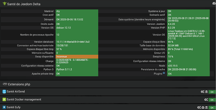

mon jeedom est en 4.4.20

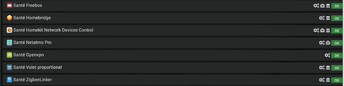

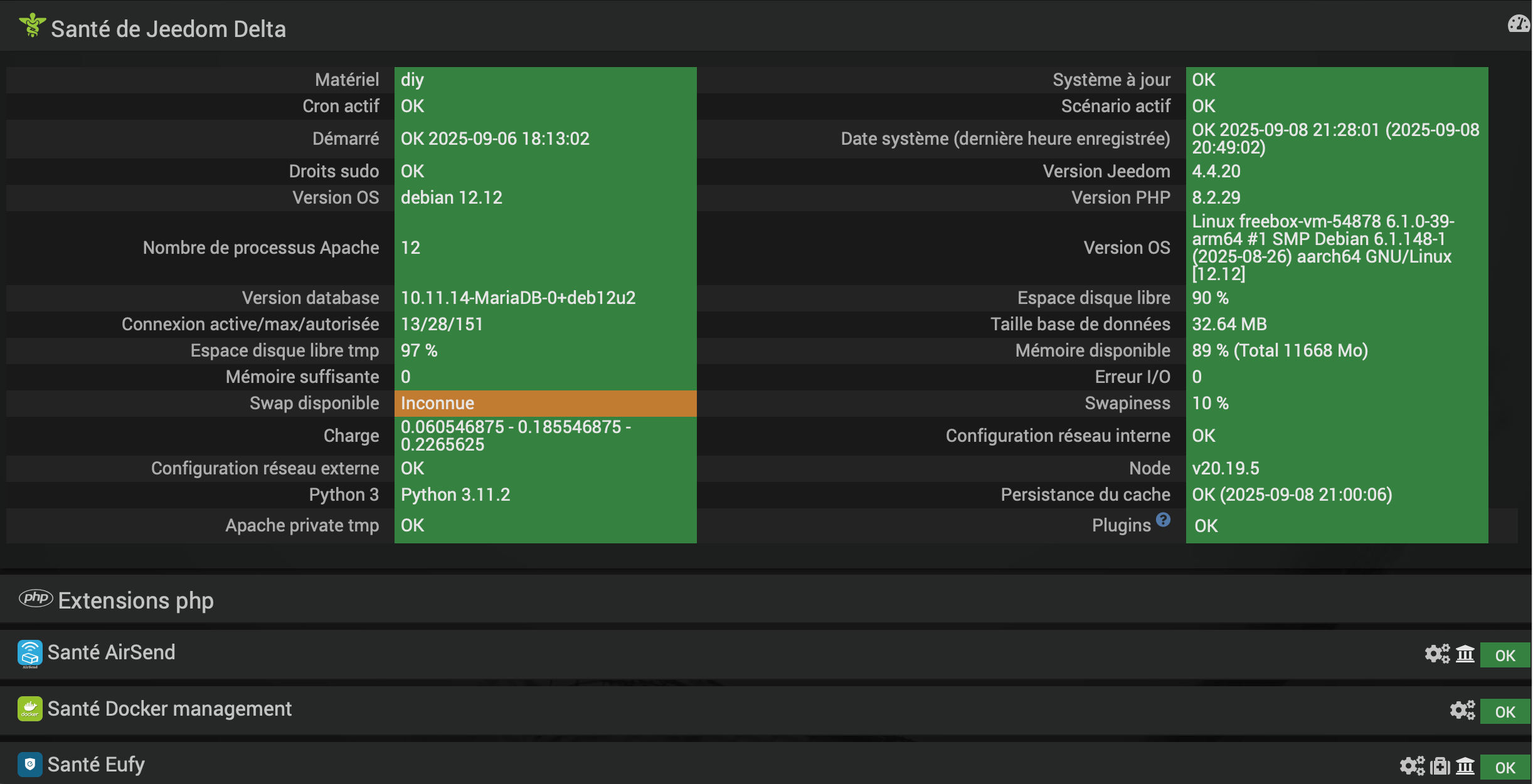

le bilan de santé :wink:
si tu as une idée ?

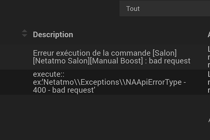

je n’ai pas eu le droit de mettre la 3eme image la voici :slight_smile:

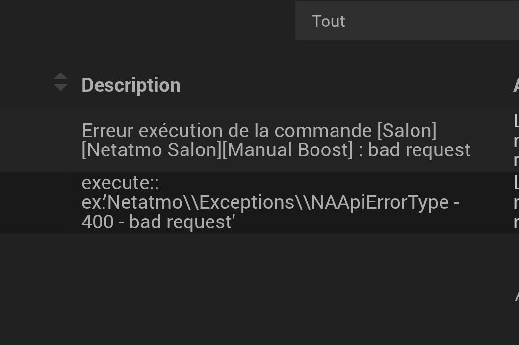

0121|[2025-09-24 19:50:08] ALERT : Starting task (Netatmo Salon/Manual Boost #7059)
0122|[2025-09-24 19:50:09] ERROR : execute:: ex:‹ Netatmo\Exceptions\NAApiErrorType - 400 - bad request ›
0123|[2025-09-24 19:50:09] ERROR : Erreur exécution de la commande [Salon][Netatmo Salon][Manual Boost] : bad request
