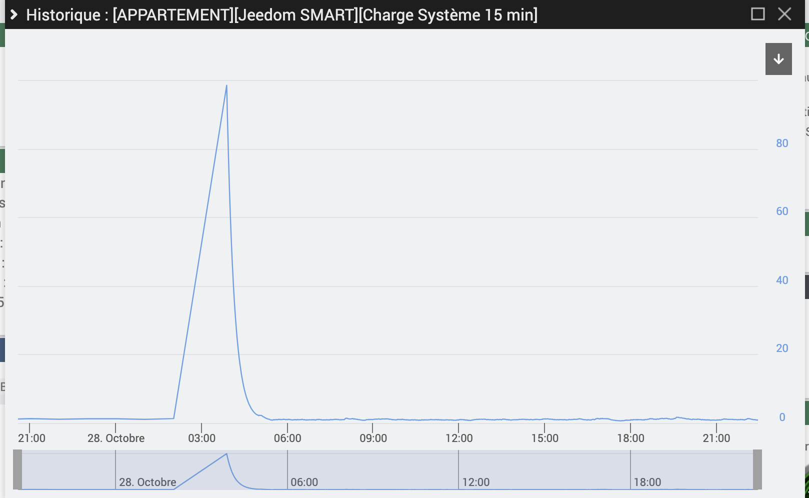

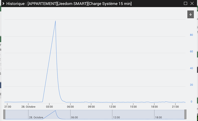

Pic de charge entre 3 et 4 heures du matin

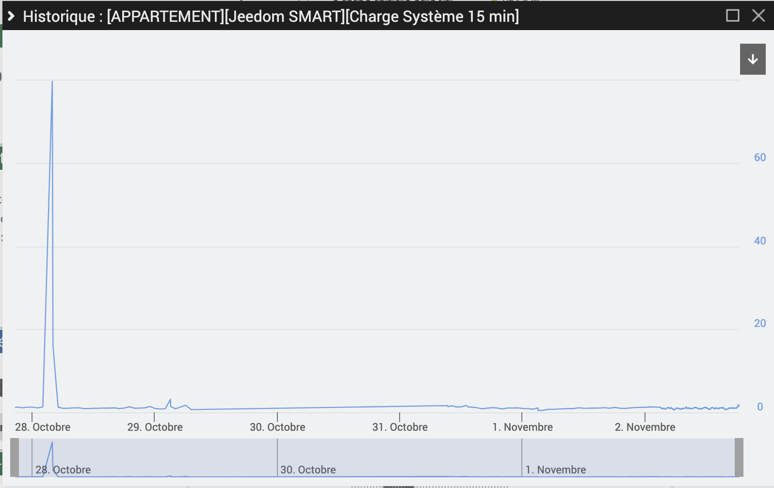

Bonjour à toutes et à tous,
J’ai parfois des gros pics de charge entre 3h et 4h du matin.

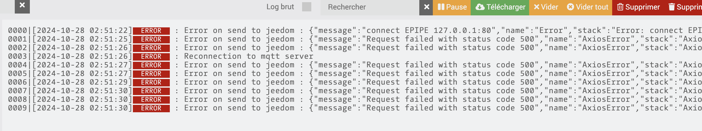

Cela créer dans les logs des erreurs du type « SQLSTATE[HY000] [2002] Connection refused »
Quelques exemples :
heliotrope
0000|[2024-10-28 03:51:17] ERROR : Erreur sur la fonction cronHourly du plugin : SQLSTATE[HY000] [2002] Connection refused 0001|[2024-10-28 03:51:17] ERROR : Erreur sur heliotrope::pull() : SQLSTATE[HY000] [2002] Connection refused
jMQTTd
0000|[2024-10-28 03:01:10,266] ERROR  Client278       Brk278Th     on_disconnect() : Unexpected disconnection from broker!
0001|[2024-10-28 03:04:52,257] ERROR  Client278       Brk278Th     on_disconnect() : Unexpected disconnection from broker!
0002|[2024-10-28 03:04:52,705] ERROR  Client278       Brk278Th     on_disconnect() : Unexpected disconnection from broker!
0003|[2024-10-28 03:05:11,864] ERROR  JMsg.Rcv        MainThread      is_working() : Nothing has been received for 315s (max 315s), Jeedom does not want me any longer.
0004|[2024-10-28 03:51:20,124] ERROR  JMsg.Snd        SockOut               send() : COULD NOT send TO Jeedom: [{'cmd': 'messageIn', 'id': '278', 'topic': 'shellypro3em-a0dd6ca0c748/events/rpc', 'payload': '{"src":"shellypro3em-a0dd6ca0c748","dst":"shellypro3em-a0dd6ca0c748/events","method":"NotifyStatus","params":{"ts":1730080795.08,"em:0":{"id":0,"a_act_power":2698.8,"a_aprt_power":2712.0,"a_current":11.615,"a_freq":49.9,"a_pf":1.00,"a_voltage":233.6,"b_act_power":0.0,"b_aprt_power":6.4,"b_current":0.028,"b_freq":49.9,"b_pf":0.00,"b_voltage":233.6,"c_act_power":0.0,"c_aprt_power":6.6,"c_current":0.028,"c_freq":49.9,"c_pf":0.00,"c_voltage":233.6,"n_current":null,"total_act_power":2698.799,"total_aprt_power":2724.975,"total_current":11.670}}}', 'qos': 1, 'retain': False}]
0005|[2024-10-28 03:51:20,845] ERROR  JMsg.Snd        MainThread            send() : COULD NOT send TO Jeedom: [{'cmd': 'daemonDown'}]
0006|[2024-10-28 03:55:15,952] INFO  Main            MainThread   set_log_level() : New log level set to: ERROR

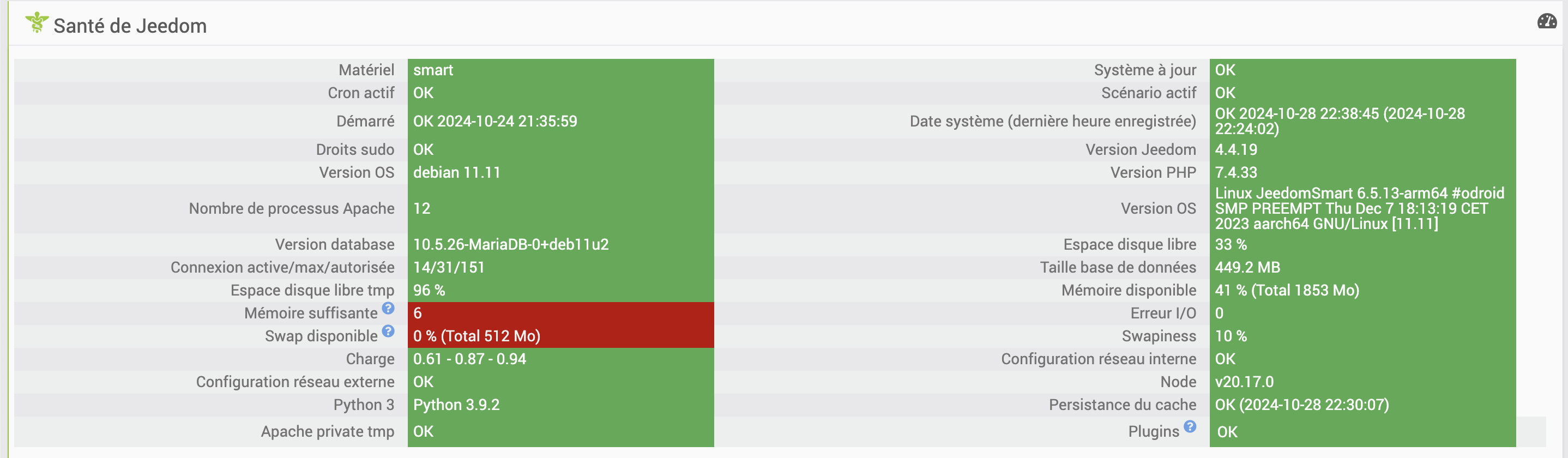

Ma page santé : (ou j’ai des memoire suffisante qui sont apparu)

A quelle heure se font vos backups ?
Quoi qu’il en soit, il est clair que votre box commence à tirer la langue avec ses 2 Go de RAM.
Ce qui attire le plus mon regard dans la page santé :
Swap de 512 Mo passée à 0 en 4 jours >> passez la au moins à 1024
Taille de la BDD : 449.2 MB >> Vous historisez quoi et surtout sur combien de temps ?
En fonction du nombre de plugins et de l’usage que vous en faites, il est peut être temps d’offrir un peu de repos à votre Smart et de passer à quelque chose d’un peu plus musclé.
Ou, pour commencer, de purger tous les historiques inutiles conservés depuis 3 ans.

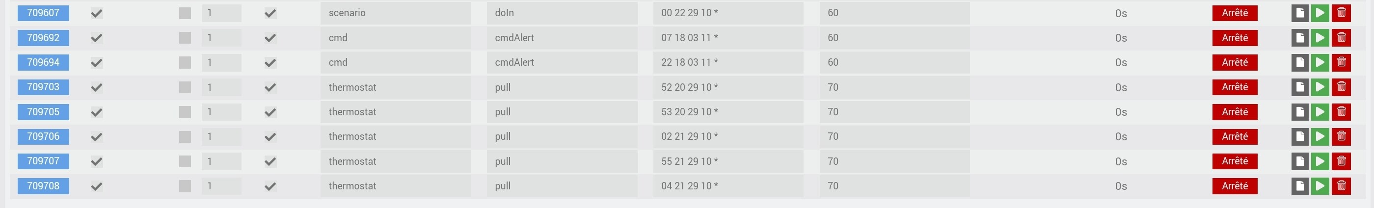

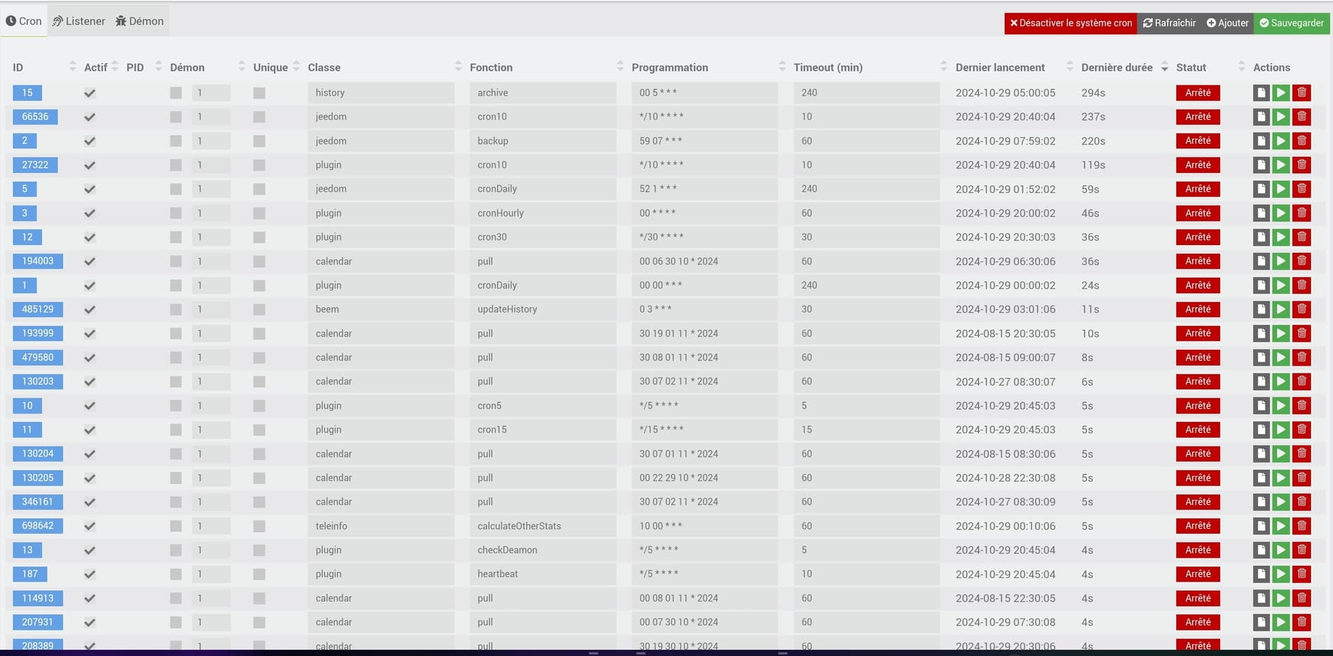

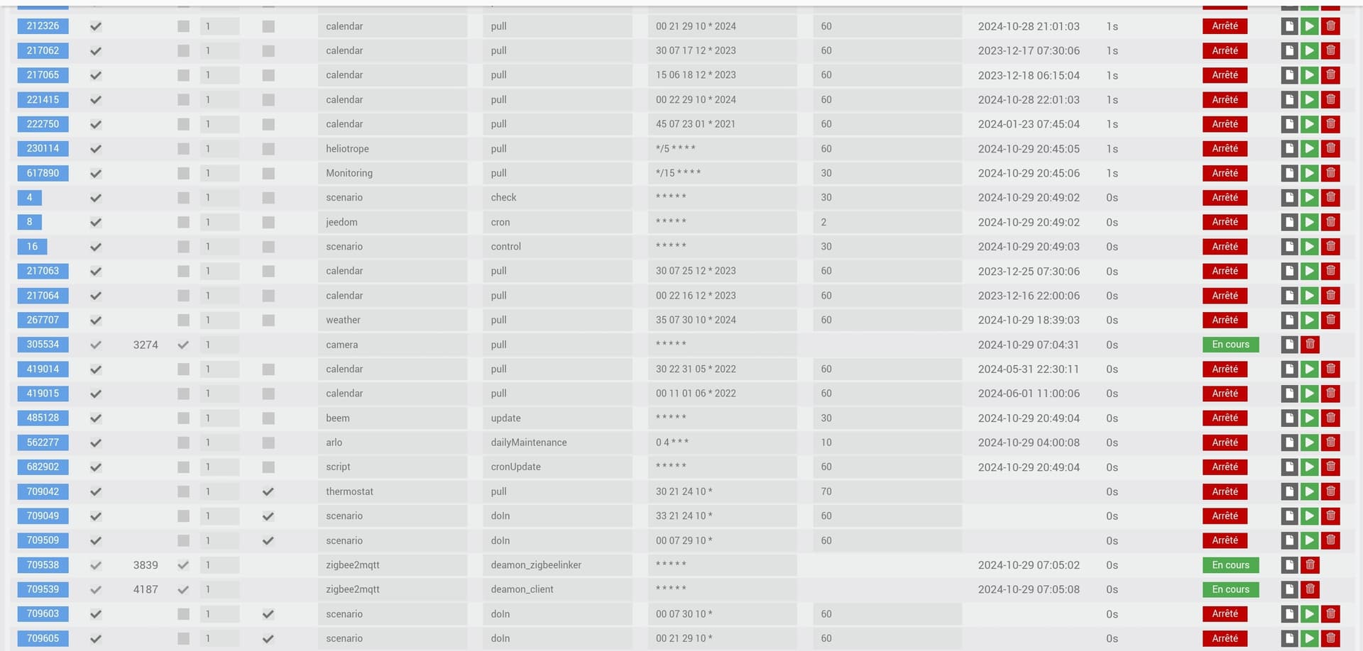

Ensuite, regarde dans le moteur de taches si tu n’as pa sune tache qui tourne entre 3 et 4h en regardant :
1 - la date de dernier lancement
2 - la programmation, si tu n’as pas une programmation de type XX 3 * * * (XX pouvant être un nombre de 0 à 59)

Pour le moteur de tâche, je vois que les taches les plus longues sont archivages et le backup
C’est ca, et relancer pour traiter les suivant de manière à aboutir à un paramétrage correct sur les historisations
Le pb n’est pas au niveau des taches les plus longues mais des taches qui se passent entre 3h et 4h qu’il faut chercher. D’apr-s ta copie d’ecran, tu as le plugin beem qui a une tache d’updateHistory qui se lance à 3h … a mon avis, en lien avec ta table history qui est très grosse, cette opératin d’updateHistory doit faire exploser la charge.
CQFD, corrige tes pbs d’archivage et je pense que tu regleras ton pic et ton plantage de Jeedom
Norbert
pour savoir si une des tâches te provoque cela tu peux aussi la lancer manuellement en cliquant sur le bouton vert en bout de la ligne et voir si tu as un pic de charge à ce moment là

J’ai fait une première « opérations » dans les archives avec l’aide de ton bloc code (merci encore).
Je suis passé d’une base de 449 MO à 195MO !
Et en terme de hauteur de pic de charge, ça donne quoi du coup ?
Bon j’ai fini mon menage. Verdict final : la base de donnée est passée à 95mo.
Au niveau de la charge, je suis à charge système (15) en moyenne à 0,95 (pour une jeedom SMART).
Bon c’est encore un peu tôt pour dire que c’est bon, mais bon on voit bien la diff !
Merci à tous,
Ça confirme encore une fois qu’une bonne gestion des archives est primordiale pour conserver un système Jeedom performant !!
Norbert
