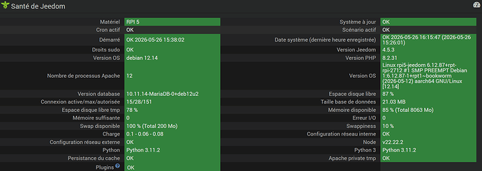

Depuis les dernières MAJ j’ai ces messages : et je ne sais pas comment réparer.
PHP Warning: Undefined property: reolinkAPI::$token in /var/www/html/plugins/reolink/3rdparty/reolinkapi.class.php on line 313
PHP Warning:  Undefined array key "audio" in /var/www/html/plugins/reolink/core/class/reolink.class.php on line 324
0001|PHP Warning:  Undefined array key 0 in /var/www/html/plugins/reolink/core/class/reolink.class.php on line 271
0002|PHP Warning:  Trying to access array offset on value of type null in /var/www/html/plugins/reolink/core/class/reolink.class.php on line 271
0003|PHP Warning:  Undefined array key 0 in /var/www/html/plugins/reolink/core/class/reolink.class.php on line 276
0004|PHP Warning:  Trying to access array offset on value of type null in /var/www/html/plugins/reolink/core/class/reolink.class.php on line 276
0005|PHP Warning:  Undefined array key 0 in /var/www/html/plugins/reolink/core/class/reolink.class.php on line 280
0006|PHP Warning:  Trying to access array offset on value of type null in /var/www/html/plugins/reolink/core/class/reolink.class.php on line 280
0007|PHP Warning:  Undefined array key 0 in /var/www/html/plugins/reolink/core/class/reolink.class.php on line 282
0008|PHP Warning:  Trying to access array offset on value of type null in /var/www/html/plugins/reolink/core/class/reolink.class.php on line 282
