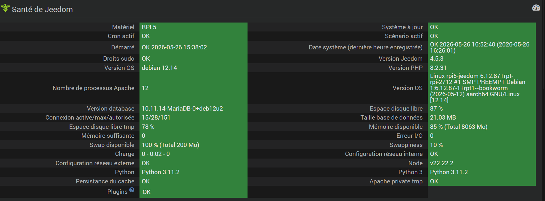

J’ai dans les log « http.error » ces messages : (depuis les dernières MAJ de Zigbeelinker)
0008|[Tue May 26 16:07:11.101509 2026] [php:warn] [pid 1568:tid 1568] [client 192.168.30.65:40308] PHP Warning:  Undefined array key 1 in /var/www/html/core/class/cmd.class.php on line 1678
0009|[Tue May 26 16:07:11.101555 2026] [php:warn] [pid 1568:tid 1568] [client 192.168.30.65:40308] PHP Warning:  Undefined array key 1 in /var/www/html/core/class/cmd.class.php on line 1682
