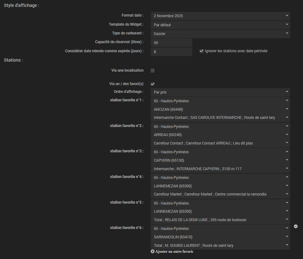

Pour cette configuration :
0000|[Sun Nov 02 07:41:09.415494 2025] [php7:notice] [pid 1833620:tid 1833620] [client 192.168.2.39:51572] PHP Notice:  Undefined offset: 3 in /var/www/html/plugins/prixcarburants/core/class/prixcarburants.class.php on line 221
0001|[Sun Nov 02 07:41:09.415540 2025] [php7:notice] [pid 1833620:tid 1833620] [client 192.168.2.39:51572] PHP Notice:  Trying to access array offset on value of type null in /var/www/html/plugins/prixcarburants/core/class/prixcarburants.class.php on line 224
0002|[Sun Nov 02 07:41:09.647124 2025] [php7:notice] [pid 1833620:tid 1833620] [client 192.168.2.39:51572] PHP Notice:  Undefined offset: 4 in /var/www/html/plugins/prixcarburants/core/class/prixcarburants.class.php on line 221
0003|[Sun Nov 02 07:41:09.647185 2025] [php7:notice] [pid 1833620:tid 1833620] [client 192.168.2.39:51572] PHP Notice:  Trying to access array offset on value of type null in /var/www/html/plugins/prixcarburants/core/class/prixcarburants.class.php on line 224
0004|[Sun Nov 02 07:41:09.863247 2025] [php7:notice] [pid 1833620:tid 1833620] [client 192.168.2.39:51572] PHP Notice:  Undefined offset: 5 in /var/www/html/plugins/prixcarburants/core/class/prixcarburants.class.php on line 221
0005|[Sun Nov 02 07:41:09.863275 2025] [php7:notice] [pid 1833620:tid 1833620] [client 192.168.2.39:51572] PHP Notice:  Trying to access array offset on value of type null in /var/www/html/plugins/prixcarburants/core/class/prixcarburants.class.php on line 224
0006|[Sun Nov 02 07:41:10.148591 2025] [php7:notice] [pid 2475921:tid 2475921] [client 192.168.2.39:57736] PHP Notice:  Undefined offset: 1 in /var/www/html/plugins/prixcarburants/core/class/prixcarburants.class.php on line 886
0007|[Sun Nov 02 07:41:10.149894 2025] [php7:notice] [pid 2475921:tid 2475921] [client 192.168.2.39:57736] PHP Notice:  Undefined offset: 1 in /var/www/html/plugins/prixcarburants/core/class/prixcarburants.class.php on line 886
0008|[Sun Nov 02 07:41:10.150558 2025] [php7:notice] [pid 1167291:tid 1167291] [client 192.168.2.39:36261] PHP Notice:  Undefined offset: 1 in /var/www/html/plugins/prixcarburants/core/class/prixcarburants.class.php on line 886
0009|[Sun Nov 02 07:41:10.150668 2025] [php7:notice] [pid 2475921:tid 2475921] [client 192.168.2.39:57736] PHP Notice:  Undefined offset: 1 in /var/www/html/plugins/prixcarburants/core/class/prixcarburants.class.php on line 886
0010|[Sun Nov 02 07:41:10.151607 2025] [php7:notice] [pid 1167291:tid 1167291] [client 192.168.2.39:36261] PHP Notice:  Undefined offset: 1 in /var/www/html/plugins/prixcarburants/core/class/prixcarburants.class.php on line 886
0011|[Sun Nov 02 07:41:10.152681 2025] [php7:notice] [pid 1167291:tid 1167291] [client 192.168.2.39:36261] PHP Notice:  Undefined offset: 1 in /var/www/html/plugins/prixcarburants/core/class/prixcarburants.class.php on line 886
0012|[Sun Nov 02 07:41:11.131375 2025] [php7:notice] [pid 1167291:tid 1167291] [client 192.168.2.39:36261] PHP Notice:  Undefined offset: 1 in /var/www/html/plugins/prixcarburants/core/class/prixcarburants.class.php on line 886
0013|[Sun Nov 02 07:41:11.135052 2025] [php7:notice] [pid 1167291:tid 1167291] [client 192.168.2.39:36261] PHP Notice:  Undefined offset: 1 in /var/www/html/plugins/prixcarburants/core/class/prixcarburants.class.php on line 886
0014|[Sun Nov 02 07:41:11.135724 2025] [php7:notice] [pid 1833620:tid 1833620] [client 192.168.2.39:51572] PHP Notice:  Undefined offset: 1 in /var/www/html/plugins/prixcarburants/core/class/prixcarburants.class.php on line 886
0015|[Sun Nov 02 07:41:11.136181 2025] [php7:notice] [pid 1167291:tid 1167291] [client 192.168.2.39:36261] PHP Notice:  Undefined offset: 1 in /var/www/html/plugins/prixcarburants/core/class/prixcarburants.class.php on line 886
0016|[Sun Nov 02 07:41:11.136946 2025] [php7:notice] [pid 1833620:tid 1833620] [client 192.168.2.39:51572] PHP Notice:  Undefined offset: 1 in /var/www/html/plugins/prixcarburants/core/class/prixcarburants.class.php on line 886
0017|[Sun Nov 02 07:41:11.138257 2025] [php7:notice] [pid 1833620:tid 1833620] [client 192.168.2.39:51572] PHP Notice:  Undefined offset: 1 in /var/www/html/plugins/prixcarburants/core/class/prixcarburants.class.php on line 886
0018|[Sun Nov 02 07:41:12.163543 2025] [php7:notice] [pid 1167291:tid 1167291] [client 192.168.2.39:36261] PHP Notice:  Undefined offset: 1 in /var/www/html/plugins/prixcarburants/core/class/prixcarburants.class.php on line 886
0019|[Sun Nov 02 07:41:12.164887 2025] [php7:notice] [pid 1167291:tid 1167291] [client 192.168.2.39:36261] PHP Notice:  Undefined offset: 1 in /var/www/html/plugins/prixcarburants/core/class/prixcarburants.class.php on line 886
0020|[Sun Nov 02 07:41:12.165640 2025] [php7:notice] [pid 1167291:tid 1167291] [client 192.168.2.39:36261] PHP Notice:  Undefined offset: 1 in /var/www/html/plugins/prixcarburants/core/class/prixcarburants.class.php on line 886

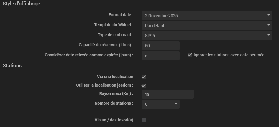

Et pour celle ci :
0000|[Sun Nov 02 07:44:25.126060 2025] [php7:notice] [pid 2482672:tid 2482672] [client 192.168.2.39:41460] PHP Notice:  Undefined offset: 0 in /var/www/html/plugins/prixcarburants/core/class/prixcarburants.class.php on line 221
0001|[Sun Nov 02 07:44:25.126133 2025] [php7:notice] [pid 2482672:tid 2482672] [client 192.168.2.39:41460] PHP Notice:  Trying to access array offset on value of type null in /var/www/html/plugins/prixcarburants/core/class/prixcarburants.class.php on line 224
0002|[Sun Nov 02 07:44:25.130356 2025] [php7:notice] [pid 2482672:tid 2482672] [client 192.168.2.39:41460] PHP Notice:  Undefined offset: 1 in /var/www/html/plugins/prixcarburants/core/class/prixcarburants.class.php on line 221
0003|[Sun Nov 02 07:44:25.130396 2025] [php7:notice] [pid 2482672:tid 2482672] [client 192.168.2.39:41460] PHP Notice:  Trying to access array offset on value of type null in /var/www/html/plugins/prixcarburants/core/class/prixcarburants.class.php on line 224
0004|[Sun Nov 02 07:44:25.131630 2025] [php7:notice] [pid 2482672:tid 2482672] [client 192.168.2.39:41460] PHP Notice:  Undefined offset: 2 in /var/www/html/plugins/prixcarburants/core/class/prixcarburants.class.php on line 221
0005|[Sun Nov 02 07:44:25.131664 2025] [php7:notice] [pid 2482672:tid 2482672] [client 192.168.2.39:41460] PHP Notice:  Trying to access array offset on value of type null in /var/www/html/plugins/prixcarburants/core/class/prixcarburants.class.php on line 224
0006|[Sun Nov 02 07:44:25.132644 2025] [php7:notice] [pid 2482672:tid 2482672] [client 192.168.2.39:41460] PHP Notice:  Undefined offset: 3 in /var/www/html/plugins/prixcarburants/core/class/prixcarburants.class.php on line 221
0007|[Sun Nov 02 07:44:25.132671 2025] [php7:notice] [pid 2482672:tid 2482672] [client 192.168.2.39:41460] PHP Notice:  Trying to access array offset on value of type null in /var/www/html/plugins/prixcarburants/core/class/prixcarburants.class.php on line 224
0008|[Sun Nov 02 07:44:25.133533 2025] [php7:notice] [pid 2482672:tid 2482672] [client 192.168.2.39:41460] PHP Notice:  Undefined offset: 4 in /var/www/html/plugins/prixcarburants/core/class/prixcarburants.class.php on line 221
0009|[Sun Nov 02 07:44:25.133556 2025] [php7:notice] [pid 2482672:tid 2482672] [client 192.168.2.39:41460] PHP Notice:  Trying to access array offset on value of type null in /var/www/html/plugins/prixcarburants/core/class/prixcarburants.class.php on line 224
0010|[Sun Nov 02 07:44:25.137621 2025] [php7:notice] [pid 2482672:tid 2482672] [client 192.168.2.39:41460] PHP Notice:  Undefined offset: 5 in /var/www/html/plugins/prixcarburants/core/class/prixcarburants.class.php on line 221
0011|[Sun Nov 02 07:44:25.137656 2025] [php7:notice] [pid 2482672:tid 2482672] [client 192.168.2.39:41460] PHP Notice:  Trying to access array offset on value of type null in /var/www/html/plugins/prixcarburants/core/class/prixcarburants.class.php on line 224
