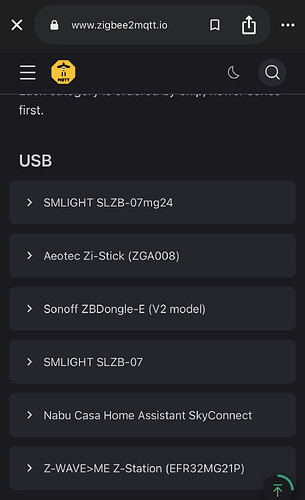

Zigbee2MQTT : Supported Adapters | Zigbee2MQTT deCONZ (Dresden Elektronik) | Zigbee2MQTT akenad slight_smile
Spoiler alerte en USB :bangbang: :
