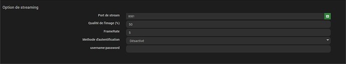

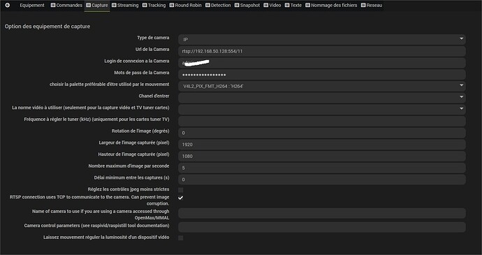

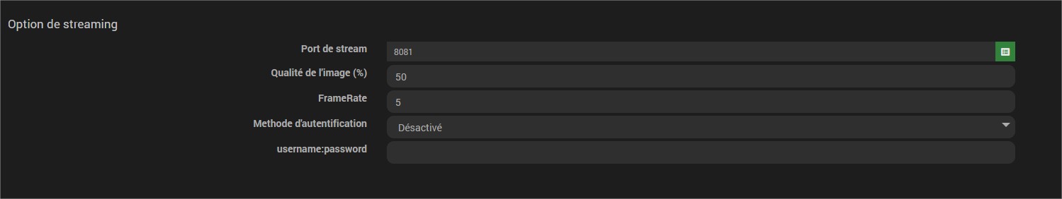

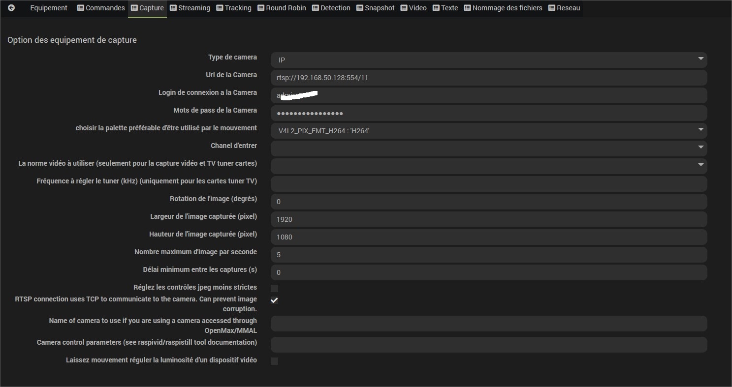

Pouvez-vous mettre des screenshot de l’onglet capture et stream.
N’activer qu’une seul caméra à la fois pour facilité le debug.

Bonsoir, merci de ton retour.
Voici :
LOG du démon :

[1:ml1:Motion Cam ] [NTC] [NET] [Nov 10 20:56:19] netcam_rtsp_ntc: to possibly lower CPU usage.
[1:ml1:Motion Cam ] [NTC] [NET] [Nov 10 20:56:19] netcam_rtsp_ntc: Netcam: 1920 x 1080 => Config: 640 x 320
[1:ml1:Motion Cam ] [NTC] [NET] [Nov 10 20:56:19] netcam_rtsp_ntc: ******************************************************
[1:ml1:Motion Cam ] [NTC] [NET] [Nov 10 20:56:19] netcam_rtsp_connect: Normal resolution: Camera (Motion Cam Jardin) connected
[1:ml1:Motion Cam ] [NTC] [ALL] [Nov 10 20:56:19] image_ring_resize: Resizing pre_capture buffer to 1 items
[2:nc2:Motion Cam ] [NTC] [NET] [Nov 10 20:56:19] netcam_rtsp_handler: Normal resolution: Camera handler thread [2] started
avec du 640*320 … toujours rien… démon rouge…
même dans le log, je n’arrive pas à voir ce qui cloche…
À tu un espace dans le nom ?
motion n’aime pas ainsi que les es caractère spéciaux

Bonjour, j’a ienlevé l’espace et je l’ai appelé CamJardin (nom de la zone MotionCamJardin), démon toujours rouge. Voici le log :
log
[0:motion] [NTC] [ALL] [Nov 11 08:32:24] motion_startup: Motion 4.2.2+git20191030-d8ea81d Started
[0:motion] [NTC] [ALL] [Nov 11 08:32:24] motion_startup: Using log type (ALL) log level (NTC)
[0:motion] [NTC] [ALL] [Nov 11 08:32:24] become_daemon: Motion going to daemon mode
[0:motion] [NTC] [ALL] [Nov 11 08:32:25] motion_startup: Motion running as daemon process
[0:motion] [NTC] [STR] [Nov 11 08:32:25] webu_start_strm: Starting camera 29 stream on port 8081
[0:motion] [NTC] [STR] [Nov 11 08:32:25] webu_strm_ntc: Started camera 29 stream on port 8081
[0:motion] [NTC] [STR] [Nov 11 08:32:25] webu_start_ctrl: Starting webcontrol on port 8080
[0:motion] [NTC] [STR] [Nov 11 08:32:25] webu_start_ctrl: Started webcontrol on port 8080
[0:motion] [NTC] [ENC] [Nov 11 08:32:25] ffmpeg_global_init: ffmpeg libavcodec version 58.35.100 libavformat version 58.20.100
[0:motion] [NTC] [ALL] [Nov 11 08:32:25] translate_init: Language: English
[0:motion] [NTC] [ALL] [Nov 11 08:32:25] motion_start_thread: Camera ID: 29 is from /etc/motion/camera29.conf
[0:motion] [NTC] [ALL] [Nov 11 08:32:25] motion_start_thread: Camera ID: 29 Camera Name: MotionCamJardin Service: rtsp:
[0:motion] [NTC] [ALL] [Nov 11 08:32:25] main: Waiting for threads to finish, pid: 12860
[1:ml1:MotionCamJa] [NTC] [ALL] [Nov 11 08:32:25] motion_init: Camera 29 started: motion detection Enabled
[1:ml1:MotionCamJa] [NTC] [VID] [Nov 11 08:32:25] vid_start: Opening Netcam RTSP
[1:ml1:MotionCamJa] [NTC] [NET] [Nov 11 08:32:27] netcam_rtsp_ntc:
[1:ml1:MotionCamJa] [NTC] [NET] [Nov 11 08:32:27] netcam_rtsp_ntc: ******************************************************
[1:ml1:MotionCamJa] [NTC] [NET] [Nov 11 08:32:27] netcam_rtsp_ntc: The network camera is sending pictures in a different
[1:ml1:MotionCamJa] [NTC] [NET] [Nov 11 08:32:27] netcam_rtsp_ntc: size than specified in the configuration file.
[1:ml1:MotionCamJa] [NTC] [NET] [Nov 11 08:32:27] netcam_rtsp_ntc: The picture is being transcoded into the size
[1:ml1:MotionCamJa] [NTC] [NET] [Nov 11 08:32:27] netcam_rtsp_ntc: requested in the configuration. If possible change
[1:ml1:MotionCamJa] [NTC] [NET] [Nov 11 08:32:27] netcam_rtsp_ntc: netcam or configuration to indicate the same size
[1:ml1:MotionCamJa] [NTC] [NET] [Nov 11 08:32:27] netcam_rtsp_ntc: to possibly lower CPU usage.
[1:ml1:MotionCamJa] [NTC] [NET] [Nov 11 08:32:27] netcam_rtsp_ntc: Netcam: 1920 x 1080 => Config: 640 x 320
[1:ml1:MotionCamJa] [NTC] [NET] [Nov 11 08:32:27] netcam_rtsp_connect: Normal resolution: Camera (MotionCamJardin) connected
[1:ml1:MotionCamJa] [NTC] [ALL] [Nov 11 08:32:27] image_ring_resize: Resizing pre_capture buffer to 1 items
[2:nc2:MotionCamJa] [NTC] [NET] [Nov 11 08:32:27] netcam_rtsp_handler: Normal resolution: Camera handler thread [2] started
Qu’à tu comme caméra car le souci est bien sur la résolution, mais la résolution n’est pas compatible visiblement avec motion
1080 n’est pas un entier divisible par 16 et je pense que motion plante au reseize.
Dans les paramètres de la caméra peux tu changer le flux

Je suis passé en 1280x720, le modulo 16 est respecté et je n’ai plus de message sur la résolution.
Voici le log :
log
[0:motion] [NTC] [ALL] [Nov 11 13:19:16] motion_startup: Motion 4.2.2+git20191030-d8ea81d Started
[0:motion] [NTC] [ALL] [Nov 11 13:19:16] motion_startup: Using log type (ALL) log level (NTC)
[0:motion] [NTC] [ALL] [Nov 11 13:19:16] become_daemon: Motion going to daemon mode
[0:motion] [NTC] [ALL] [Nov 11 13:19:16] motion_startup: Motion running as daemon process
[0:motion] [NTC] [STR] [Nov 11 13:19:16] webu_start_strm: Starting camera 29 stream on port 8081
[0:motion] [NTC] [STR] [Nov 11 13:19:16] webu_strm_ntc: Started camera 29 stream on port 8081
[0:motion] [NTC] [STR] [Nov 11 13:19:16] webu_start_ctrl: Starting webcontrol on port 8080
[0:motion] [NTC] [STR] [Nov 11 13:19:16] webu_start_ctrl: Started webcontrol on port 8080
[0:motion] [NTC] [ENC] [Nov 11 13:19:16] ffmpeg_global_init: ffmpeg libavcodec version 58.35.100 libavformat version 58.20.100
[0:motion] [NTC] [ALL] [Nov 11 13:19:16] translate_init: Language: English
[0:motion] [NTC] [ALL] [Nov 11 13:19:16] motion_start_thread: Camera ID: 29 is from /etc/motion/camera29.conf
[0:motion] [NTC] [ALL] [Nov 11 13:19:16] motion_start_thread: Camera ID: 29 Camera Name: MotionCamJardin Service: rtsp:
[0:motion] [NTC] [ALL] [Nov 11 13:19:16] main: Waiting for threads to finish, pid: 21767
[1:ml1:MotionCamJa] [NTC] [ALL] [Nov 11 13:19:16] motion_init: Camera 29 started: motion detection Enabled
[1:ml1:MotionCamJa] [NTC] [VID] [Nov 11 13:19:16] vid_start: Opening Netcam RTSP
[1:ml1:MotionCamJa] [NTC] [NET] [Nov 11 13:19:18] netcam_rtsp_connect: Normal resolution: Camera (MotionCamJardin) connected
[1:ml1:MotionCamJa] [NTC] [ALL] [Nov 11 13:19:18] image_ring_resize: Resizing pre_capture buffer to 1 items
[2:nc2:MotionCamJa] [NTC] [NET] [Nov 11 13:19:18] netcam_rtsp_handler: Normal resolution: Camera handler thread [2] started
on progresse, mais toujours démon en rouge …
C’est dingue ça
Y a pas d’indication non d’erreur.
il essaye tout de même un reseize tu as bien configurer la même résolution
Je viens de me rendre compte que tu a cocher la transformation rtsp vers tcp il ne le faut pas
tisote
Novembre 11, 2019, 3:38
20
oui, je ne comprends pas non plus.
j’ai décoché la case TCP, pas de changement, voici le log (qui n’évolue pas beaucoup…) :
log
[0:motion] [NTC] [ALL] [Nov 11 16:35:29] motion_startup: Motion 4.2.2+git20191030-d8ea81d Started
[0:motion] [NTC] [ALL] [Nov 11 16:35:29] motion_startup: Using log type (ALL) log level (NTC)
[0:motion] [NTC] [ALL] [Nov 11 16:35:29] become_daemon: Motion going to daemon mode
[0:motion] [NTC] [ALL] [Nov 11 16:35:29] motion_startup: Motion running as daemon process
[0:motion] [NTC] [STR] [Nov 11 16:35:29] webu_start_strm: Starting camera 29 stream on port 8081
[0:motion] [NTC] [STR] [Nov 11 16:35:29] webu_strm_ntc: Started camera 29 stream on port 8081
[0:motion] [NTC] [STR] [Nov 11 16:35:29] webu_start_ctrl: Starting webcontrol on port 8080
[0:motion] [NTC] [STR] [Nov 11 16:35:29] webu_start_ctrl: Started webcontrol on port 8080
[0:motion] [NTC] [ENC] [Nov 11 16:35:29] ffmpeg_global_init: ffmpeg libavcodec version 58.35.100 libavformat version 58.20.100
[0:motion] [NTC] [ALL] [Nov 11 16:35:29] translate_init: Language: English
[0:motion] [NTC] [ALL] [Nov 11 16:35:29] motion_start_thread: Camera ID: 29 is from /etc/motion/camera29.conf
[0:motion] [NTC] [ALL] [Nov 11 16:35:29] motion_start_thread: Camera ID: 29 Camera Name: MotionCamJardin Service: rtsp:
[0:motion] [NTC] [ALL] [Nov 11 16:35:29] main: Waiting for threads to finish, pid: 15905
[1:ml1:MotionCamJa] [NTC] [ALL] [Nov 11 16:35:29] motion_init: Camera 29 started: motion detection Enabled
[1:ml1:MotionCamJa] [NTC] [VID] [Nov 11 16:35:29] vid_start: Opening Netcam RTSP
[1:ml1:MotionCamJa] [NTC] [NET] [Nov 11 16:35:32] netcam_rtsp_connect: Normal resolution: Camera (MotionCamJardin) connected
[1:ml1:MotionCamJa] [NTC] [ALL] [Nov 11 16:35:32] image_ring_resize: Resizing pre_capture buffer to 1 items
la résolution de ma caméra est bien 1280x720 en natif maintenant, comme indiqué dans l’onglet capture… démon rouge toujours… pfffff…
