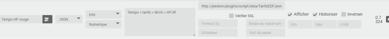

Ci-dessous les différents tarifs EDF au format Json obtenus par extraction manuelle de leurs PDFs.
Tous les prix sont en euros.
Tarifs EDF json
{"Tempo":{"parution":"2023-08-01","tarifs":{"6kVA":{"aboTTCmois":12.8,"HCJB":0.1056,"HPJB":0.1369,"HCJW":0.1246,"HPJW":0.1654,"HCJR":0.1328,"HPJR":0.7324},"9kVA":{"aboTTCmois":16,"HCJB":0.1056,"HPJB":0.1369,"HCJW":0.1246,"HPJW":0.1654,"HCJR":0.1328,"HPJR":0.7324},"12kVA":{"aboTTCmois":19.29,"HCJB":0.1056,"HPJB":0.1369,"HCJW":0.1246,"HPJW":0.1654,"HCJR":0.1328,"HPJR":0.7324},"15kVA":{"aboTTCmois":22.3,"HCJB":0.1056,"HPJB":0.1369,"HCJW":0.1246,"HPJW":0.1654,"HCJR":0.1328,"HPJR":0.7324},"18kVA":{"aboTTCmois":25.29,"HCJB":0.1056,"HPJB":0.1369,"HCJW":0.1246,"HPJW":0.1654,"HCJR":0.1328,"HPJR":0.7324},"30kVA":{"aboTTCmois":38.13,"HCJB":0.1056,"HPJB":0.1369,"HCJW":0.1246,"HPJW":0.1654,"HCJR":0.1328,"HPJR":0.7324},"36kVA":{"aboTTCmois":44.28,"HCJB":0.1056,"HPJB":0.1369,"HCJW":0.1246,"HPJW":0.1654,"HCJR":0.1328,"HPJR":0.7324}}},"Base":{"parution":"2023-08-01","tarifs":{"3kVA":{"aboTTCmois":9.47,"kWh":0.2276},"6kVA":{"aboTTCmois":12.44,"kWh":0.2276},"9kVA":{"aboTTCmois":15.63,"kWh":0.2276},"12kVA":{"aboTTCmois":18.89,"kWh":0.2276},"15kVA":{"aboTTCmois":21.92,"kWh":0.2276},"18kVA":{"aboTTCmois":24.92,"kWh":0.2276},"24kVA":{"aboTTCmois":31.6,"kWh":0.2276},"30kVA":{"aboTTCmois":37.29,"kWh":0.2276},"36kVA":{"aboTTCmois":44.66,"kWh":0.2276}}},"Heures creuses":{"parution":"2023-08-01","tarifs":{"6kVA":{"aboTTCmois":12.85,"HP":0.246,"HC":0.1828},"9kVA":{"aboTTCmois":16.55,"HP":0.246,"HC":0.1828},"12kVA":{"aboTTCmois":19.97,"HP":0.246,"HC":0.1828},"15kVA":{"aboTTCmois":23.24,"HP":0.246,"HC":0.1828},"18kVA":{"aboTTCmois":26.48,"HP":0.246,"HC":0.1828},"24kVA":{"aboTTCmois":33.28,"HP":0.246,"HC":0.1828},"30kVA":{"aboTTCmois":39.46,"HP":0.246,"HC":0.1828},"36kVA":{"aboTTCmois":44.64,"HP":0.246,"HC":0.1828}}},"EJP":{"parution":"2023-08-01","tarifs":{"9kVA":{"aboTTCmois":15.63,"HN":0.1518,"HPM":1.4958},"12kVA":{"aboTTCmois":18.6,"HN":0.1518,"HPM":1.4958},"15kVA":{"aboTTCmois":21.62,"HN":0.1518,"HPM":1.4958},"18kVA":{"aboTTCmois":24.55,"HN":0.1518,"HPM":1.4958},"36kVA":{"aboTTCmois":42.96,"HN":0.1518,"HPM":1.4958}}}}
La structure du JSON:
En plaçant les données ci-dessus dans le fichier plugins/script/data/TarifsEDF.json, on peut alors en extraire les valeurs avec le plugin script:
