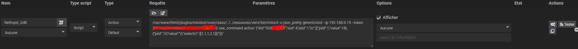

En revanche je n’arrive pas à envoyer cette commande depuis une commande du plugin script alors que j’imagine que c’est fait justement pour !
Sauriez-vous m’aider ?
Voici à quoi ressemble ma commande :
J’ai enlevé le « sudo » à la requête car je vois dans les logs qu’il le rajoute tout seul.
Mais sans succès, les logs me donnent ça :
[2024-09-18 23:08:21] DEBUG  : Exécution de : sudo chmod +x /var/www/html/plugins/mirobot/core/class/../../resources/venv/bin/miiocli 2>/dev/null;/var/www/html/plugins/mirobot/core/class/../../resources/venv/bin/miiocli -o json_pretty genericmiot --ip 192.168.0.19 --token 70744aXXXXXXXXXXXXXXXXXXXXXX raw_command action {"did":"638XYYYYY","siid":4,"aiid":1,"in":[{"piid":1,"value":18},{"piid":10,"value":"{\"selects\":[[1,1,1,2,1]]}"}]} => ERROR:miio.click_common:Exception: invalid syntax (<unknown>, line 1) Traceback (most recent call last):   File "/var/www/html/plugins/mirobot/resources/venv/lib/python3.9/site-packages/miio/click_common.py", line 55, in __call__     return self.main(*args, **kwargs)   File "/var/www/html/plugins/mirobot/resources/venv/lib/python3.9/site-packages/click/core.py", line 1078, in main     rv = self.invoke(ctx)   File "/var/www/html/plugins/mirobot/resources/venv/lib/python3.9/site-packages/click/core.py", line 1688, in invoke     return _process_result(sub_ctx.command.invoke(sub_ctx))   File "/var/www/html/plugins/mirobot/resources/venv/lib/python3.9/site-packages/click/core.py", line 1686, in invoke     sub_ctx = cmd.make_context(cmd_name, args, parent=ctx)   File "/var/www/html/plugins/mirobot/resources/venv/lib/python3.9/site-packages/click/core.py", line 943, in make_context     self.parse_args(ctx, args)   File "/var/www/html/plugins/mirobot/resources/venv/lib/python3.9/site-packages/click/core.py", line 1408, in parse_args     value, args = param.handle_parse_result(ctx, opts, args)   File "/var/www/html/plugins/mirobot/resources/venv/lib/python3.9/site-packages/click/core.py", line 2400, in handle_parse_result     value = self.process_value(ctx, value)   File "/var/www/html/plugins/mirobot/resources/venv/lib/python3.9/site-packages/click/core.py", line 2356, in process_value     value = self.type_cast_value(ctx, value)   File "/var/www/html/plugins/mirobot/resources/venv/lib/python3.9/site-packages/click/core.py", line 2344, in type_cast_value     return convert(value)   File "/var/www/html/plugins/mirobot/resources/venv/lib/python3.9/site-packages/click/core.py", line 2316, in convert     return self.type(value, param=self, ctx=ctx)   File "/var/www/html/plugins/mirobot/resources/venv/lib/python3.9/site-packages/click/types.py", line 83, in __call__     return self.convert(value, param, ctx)   File "/var/www/html/plugins/mirobot/resources/venv/lib/python3.9/site-packages/miio/click_common.py", line 102, in convert     return ast.literal_eval(value)   File "/opt/pyenv/versions/3.9.19/lib/python3.9/ast.py", line 62, in literal_eval     node_or_string = parse(node_or_string, mode='eval')   File "/opt/pyenv/versions/3.9.19/lib/python3.9/ast.py", line 50, in parse     return compile(source, filename, mode, flags,   File "<unknown>", line 1     {did:638554088,siid:4,aiid:1,in:[{piid:1,value:18},{piid:10,value:{"selects":[[1,1,1,2,1]]}}]}                                  ^ SyntaxError: invalid syntax
Merci encore à la commu !
Dans l’image que tu fournis ce n’est pas un script que tu lances :grin: il faut mettre cette commande dans un fichier avec une extension « .sh », et c’est ce script que tu lanceras avec éventuellement des paramètres, à savoir le n° de ta pièce, l’intensité du nettoyage, le nombre de passe, etc…

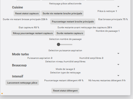

Capture d’écran 2024-09-19 161842
Tu remarqueras sur la deuxième image le script que je lance avec les paramètres correspondants aux options visibles sur la première image.
