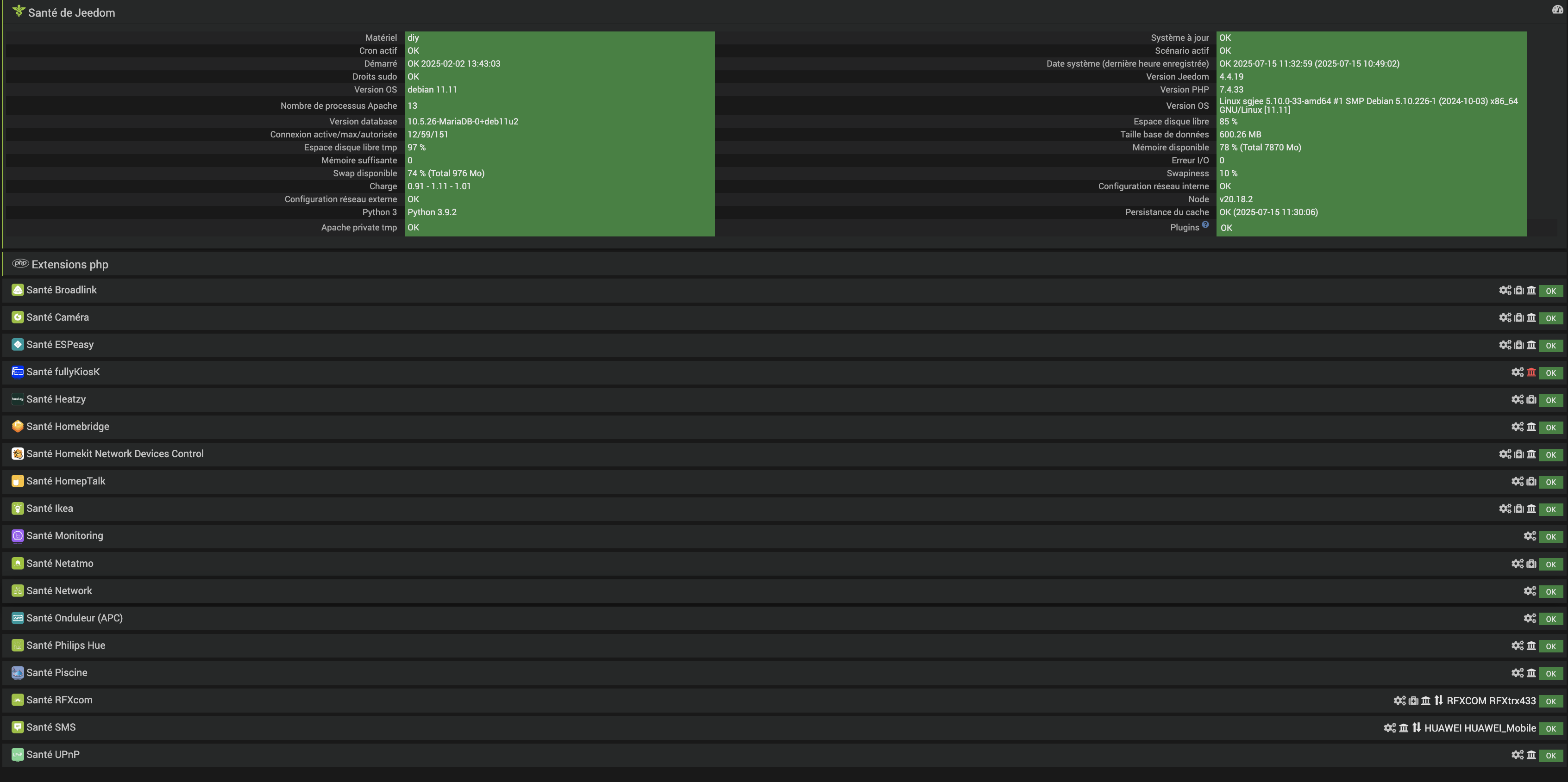

INFOS Système:
Jeedom 4.4.19
Plugin HomepTalk version 2025-02-24 11:35:32
Page santé:
