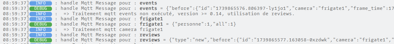

[2025-02-18 10:22:22] DEBUG  : handle Mqtt Message pour : events = {"before":{"id":"1739870526.074291-um5pjn","camera":"Salon","frame_time":1739870536.33965,"snapshot":{"frame_time":1739870526.316377,"box":[321,657,601,1056],"area":111720,"region":[0,392,688,1080],"score":0.796875,"attributes":[]},"label":"person","sub_label":null,"top_score":0.8203125,"false_positive":false,"start_time":1739870526.074291,"end_time":null,"score":0.8203125,"box":[325,655,603,1057],"area":111756,"ratio":0.6915422885572139,"region":[6,396,690,1080],"stationary":true,"motionless_count":51,"position_changes":0,"current_zones":["Tout"],"entered_zones":["Tout"],"has_clip":false,"has_snapshot":false,"attributes":[],"current_attributes":[]},"after":{"id":"1739870526.074291-um5pjn","camera":"Salon","frame_time":1739870536.761348,"snapshot":{"frame_time":1739870526.316377,"box":[321,657,601,1056],"area":111720,"region":[0,392,688,1080],"score":0.796875,"attributes":[]},"label":"person","sub_label":null,"top_score":0.8203125,"false_positive":false,"start_time":1739870526.074291,"end_time":1739870542.21447,"score":0.8203125,"box":[325,655,603,1057],"area":111756,"ratio":0.6915422885572139,"region":[6,396,690,1080],"stationary":true,"motionless_count":54,"position_changes":0,"current_zones":["Tout"],"entered_zones":["Tout"],"has_clip":false,"has_snapshot":false,"attributes":[],"current_attributes":[]},"type":"end"}
[2025-02-18 10:22:22] INFO  :  => Traitement mqtt events non exécuté, version >= 0.14, utilisation de reviews.
Pour moi, l’évènement est bien reçu en mqtt par le plug-in, en temps réel, mais il ne vas pas chercher les informations de l’évènement. « Traitement mqtt events non exécuté ». Mais pour quelle raison le plugin fait-il ce choix ?
Car a partir de la 0.14 les reviews sont utilisés pour les events, ce n’est pas logique que ta version n’envoie pas cette information.

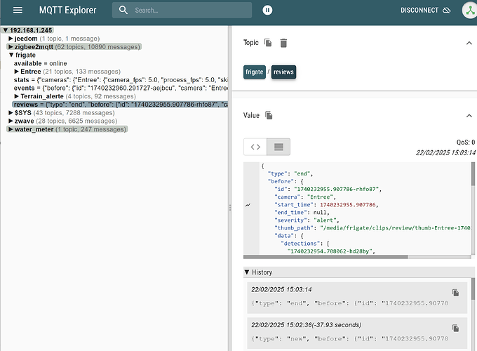

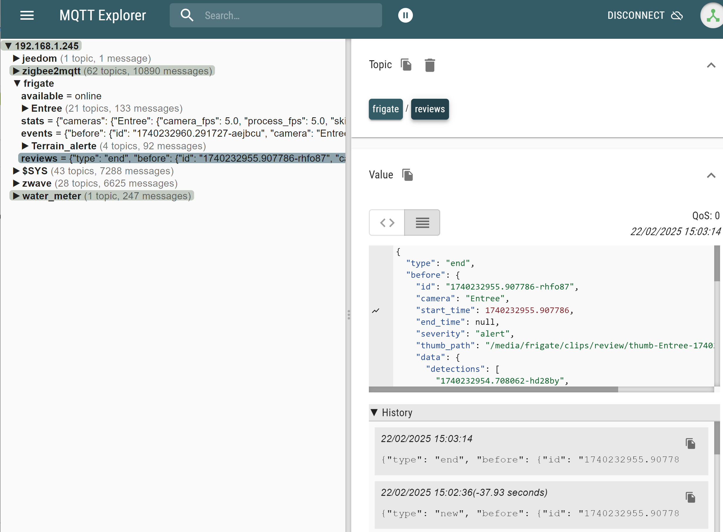

J’ai le même problème que toi, je n’ai pas le topic frigate/reviews dans MQTT manager.
Comment as-tu fait pour réglè ton problème, car le record est en « true » pourtant ça ne fonctionne pas. Peux-tu partager ta config que je l’essaie ?

Suite à plusieurs essais et j’ai fini par redéployer frigate sur mon docker et la miracle :
Bref, je ne sais pas pourquoi je n’avais pas le topic « reviews » . Problème résolu :slight_smile:

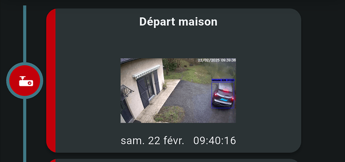

Par contre, j’ai un souci avec les snapshots et les actions de type "new".
J’utilise JeedomConnect pour les notifications et j’ai testé les trois types d’événements (new, update, end).
Problème :
  • Avec le type "new", je ne reçois pas le snapshot.
  • Je ne reçois que les snapshots des événements de type "end".
Voici les logs :
Debug frigate.txt (85,7 Ko)
Pourtant, le fichier snapshot est bien présent dans le dossier :
html/plugins/frigate/data/Entree
J’ai l’impression que Frigate essaie d’envoyer la notification avant que le snapshot ne soit disponible dans Jeedom, ce qui fait que JeedomConnect ne trouve pas l’image et ne l’envoie pas.
Tu aurais une explication ou une solution ?

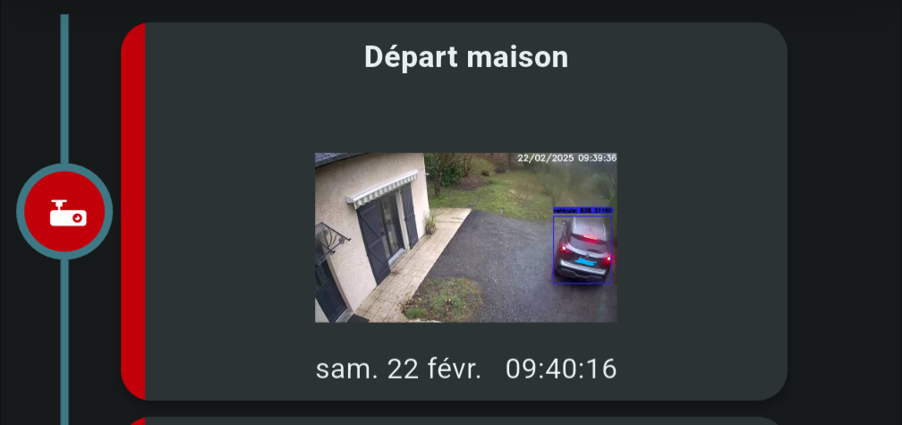

J’imagine qu’il y a un petit souci dans l’ordre de traitement. J’ai refait un test, si ça peut t’aider.
Logs :
Log Frigate_2.txt (83,9 Ko)
Résultat du test :
  • Je suis passé devant la caméra à 19h24.
  • J’ai bien reçu la notification "new" sans snapshot à 19h24 (version sans snapshot)
  • je n’ai pas reçu la notification "new" (version avec le snapshot)
  • J’ai ensuite reçu le snapshot uniquement avec la notification "end".
Le snapshot semble bien avoir été créé à 19h24, mais comme les propriétés du snapshot n’affichent pas les secondes, je ne peux pas voir s’il a été généré avant ou après l’envoi de la notification "new".

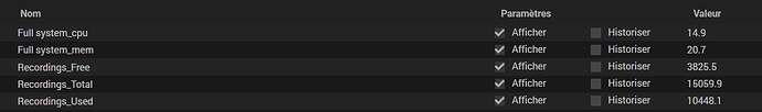

Peux-tu me faire une liste des infos que tu n’as pas dans mon plugin et leur topic mqtt.
il s’agit de la charge cpu system, RAM et de l’espace disque :
  • frigate/stats/cpu_usages/frigate.full_system/cpu
  • frigate/stats/cpu_usages/frigate.full_system/mem
  • frigate/stats/service/storage/ → ensuite c’est le premier noeud qui m’intéresse (recordings) mais son nom dépend de chaque installation car c’est le chemin absolu de stockage
Merci par avance
A tester dans la beta 1.1.9
