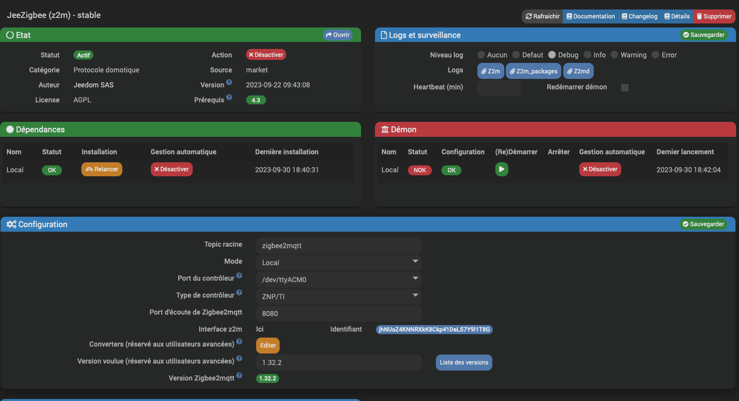

Je viens de refaire un test via la version 1.32.2 de Zigbee2MQTT mais rien n’y fait :
Voici les logs :
Z2M :
Z2M.txt (93,1 Ko)
(Désolé pour le TXT mais le texte était trop long …

Z2Md :
> zigbee2mqtt@1.32.2 start
> node index.js
Zigbee2MQTT:debug 2023-09-30 18:42:07: Loaded state from file /var/www/html/plugins/z2m/data/state.json
Zigbee2MQTT:info  2023-09-30 18:42:07: Logging to console and directory: '/var/www/html/plugins/z2m/data/log/2023-09-30.18-42-07' filename: log.txt
Zigbee2MQTT:debug 2023-09-30 18:42:07: Removing old log directory '/var/www/html/plugins/z2m/data/log/2023-09-24.21-20-05'
Zigbee2MQTT:info  2023-09-30 18:42:07: Starting Zigbee2MQTT version 1.32.2 (commit #1ec1e572)
Zigbee2MQTT:info  2023-09-30 18:42:07: Starting zigbee-herdsman (0.17.2)
Zigbee2MQTT:debug 2023-09-30 18:42:07: Using zigbee-herdsman with settings: '{"adapter":{"concurrent":null,"delay":null,"disableLED":false},"backupPath":"/var/www/html/plugins/z2m/data/coordinator_backup.json","databaseBackupPath":"/var/www/html/plugins/z2m/data/database.db.backup","databasePath":"/var/www/html/plugins/z2m/data/database.db","network":{"channelList":[11],"extendedPanID":[221,221,221,221,221,221,221,221],"networkKey":"HIDDEN","panID":6754},"serialPort":{"adapter":"zstack","path":"/dev/ttyACM0"}}'
Zigbee2MQTT:error 2023-09-30 18:42:27: Error while starting zigbee-herdsman
Zigbee2MQTT:error 2023-09-30 18:42:27: Failed to start zigbee
Zigbee2MQTT:error 2023-09-30 18:42:27: Check https://www.zigbee2mqtt.io/guide/installation/20_zigbee2mqtt-fails-to-start.html for possible solutions
Zigbee2MQTT:error 2023-09-30 18:42:27: Exiting...
Zigbee2MQTT:error 2023-09-30 18:42:27: Error: Failed to connect to the adapter (Error: SRSP - SYS - ping after 6000ms)
at ZStackAdapter.start (/var/www/html/plugins/z2m/resources/zigbee2mqtt/node_modules/zigbee-herdsman/src/adapter/z-stack/adapter/zStackAdapter.ts:103:27)
at Controller.start (/var/www/html/plugins/z2m/resources/zigbee2mqtt/node_modules/zigbee-herdsman/src/controller/controller.ts:132:29)
at Zigbee.start (/var/www/html/plugins/z2m/resources/zigbee2mqtt/lib/zigbee.ts:59:27)
at Controller.start (/var/www/html/plugins/z2m/resources/zigbee2mqtt/lib/controller.ts:101:27)
at start (/var/www/html/plugins/z2m/resources/zigbee2mqtt/index.js:107:5)
J’ai essayé de mettre le port en Auto, mais c’est identique…

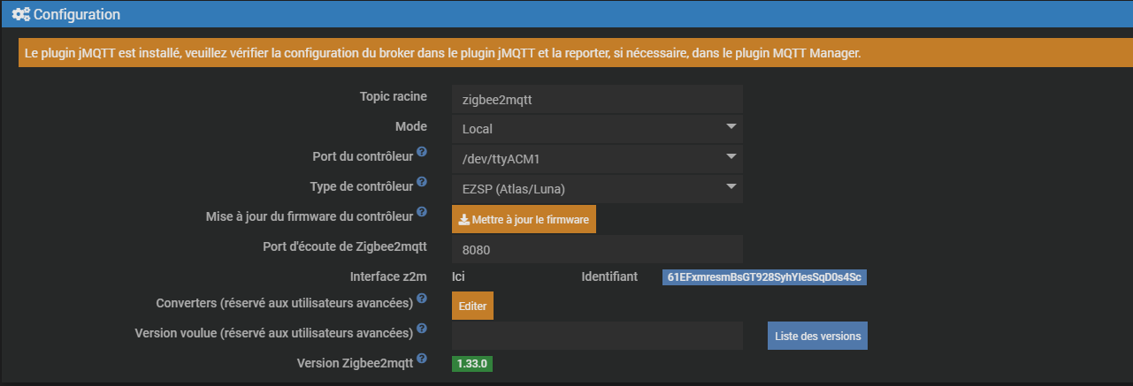

Ma config

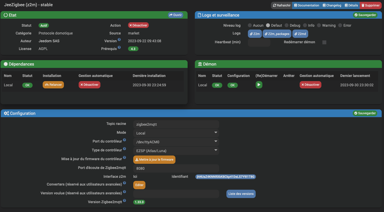

La mise à jour est passée avec cette configuration (identique à la tienne).
Possible que ce soit « type de controleur » qui n’était pas conforme…
On est d’accord qu’avec ce controleur, tu ne fais jamais la Mise à jour frimware via Jeedom ?
Pour l’instant je ne fais aucune mise à jour firmware de la clé
Je pense que je vais partir dans la même logique
