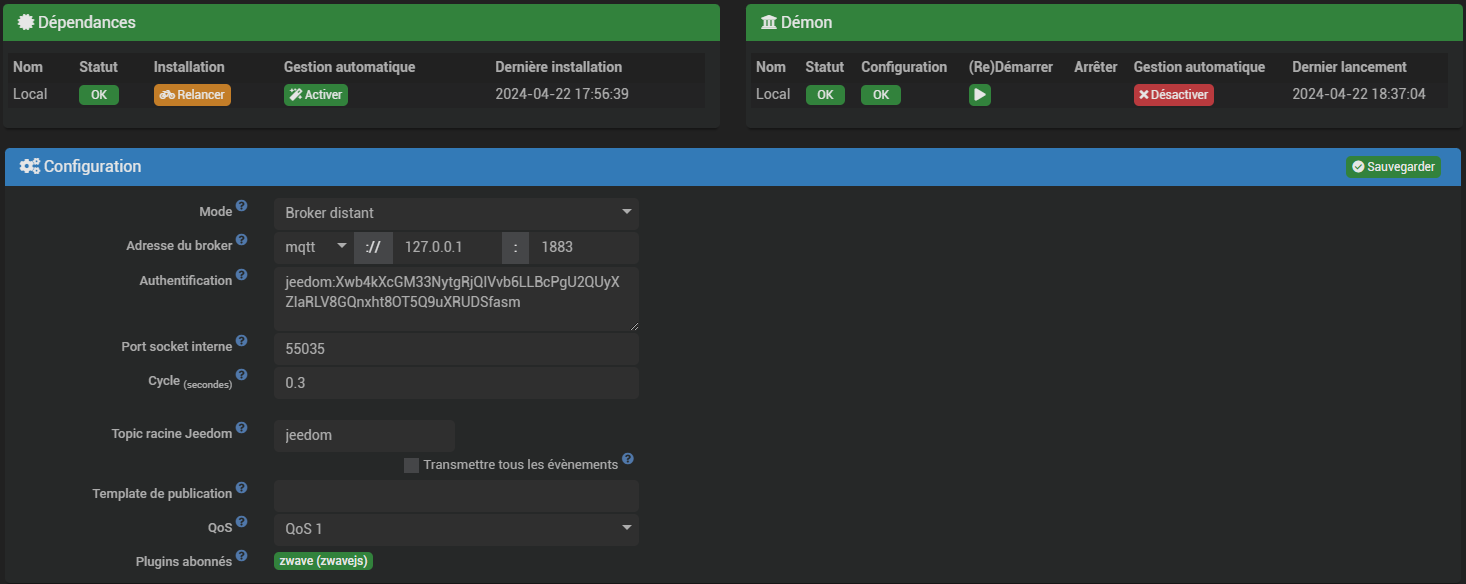

2 - Mes PlugIn :
- MQTT manager (mqtt2) v.2024-03-26 01:21:05
2024-04-19 19:32:11] INFO : Démarrage du démon MQTT Manager : sudo /usr/bin/node /var/www/html/plugins/mqtt2/resources/mqtt2d/mqtt2d.js --loglevel debug --socketport 55035 --mqtt_server mqtts://127.0.0.1:8883 --client_key /var/www/html/plugins/mqtt2/data/ssl/client.key --client_crt /var/www/html/plugins/mqtt2/data/ssl/client.crt --ca /var/www/html/plugins/mqtt2/data/ssl/ca.crt --username "jeedom" --password "Xwb4kXcGM33NytgRjQIVvb6LLBcPgU2QUyXZlaRLV8GQnxht8OT5Q9uXRUDSfasm" --callback http://127.0.0.1:80/plugins/mqtt2/core/php/jeeMqtt2.php --apikey OhGtBOIYpTW0RttdZ2ZFNd53EOGeiuHPO95dUiVaMfL7CcCfJjcJcIpfPsjG4W2H --cycle 0.3 --pid /tmp/jeedom/mqtt2/deamon.pid
[2024-04-19 19:32:13] DEBUG : Message reçu sans prise en charge par un plugin : {"jeedom":{"status":"online"}}
[2024-04-19 19:32:13] DEBUG : Message reçu sans prise en charge par un plugin : {"jeedom":{"cmd":{"event":{"2299":{"value":"11.1","humanName":"[FreeBox][Freebox Player][Version]","unite":"","name":"Version","type":"info","subtype":"string"}}}}}
[2024-04-19 19:32:13] DEBUG : Message reçu sans prise en charge par un plugin : {"jeedom":{"cmd":{"event":{"4030":{"value":1,"humanName":"[FreeBox][Broker MQTT Jeedom][connected]","unite":"","name":"connected","type":"info","subtype":"binary"}}}}}
Pas d’erreur dans les logs

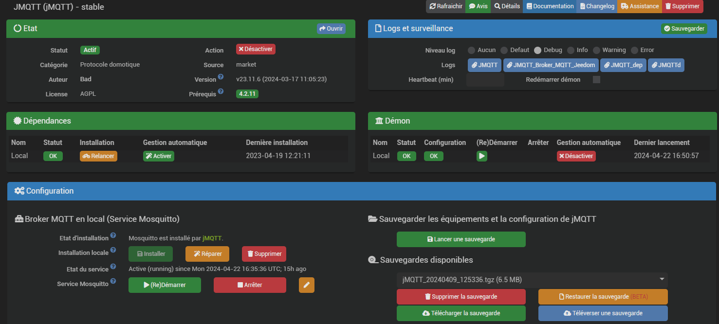

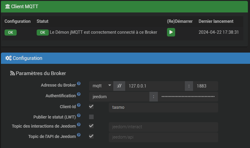

- jMQTT v23.11.6

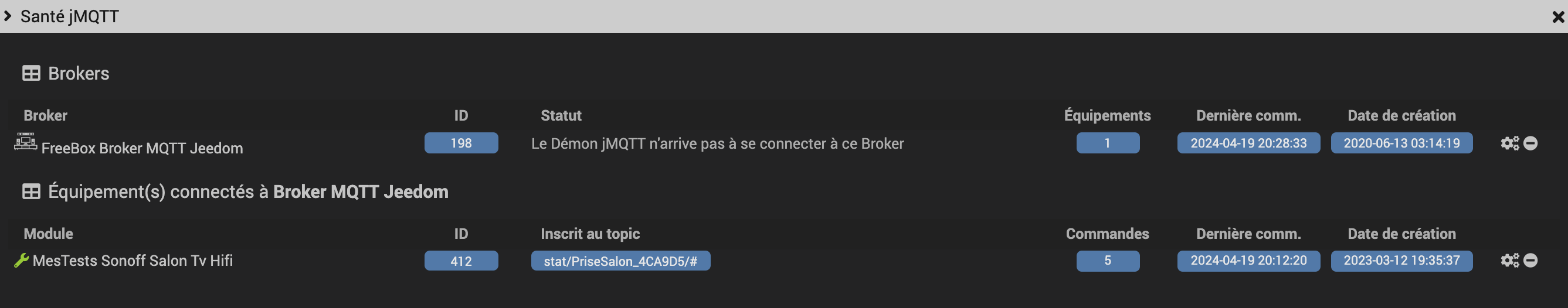

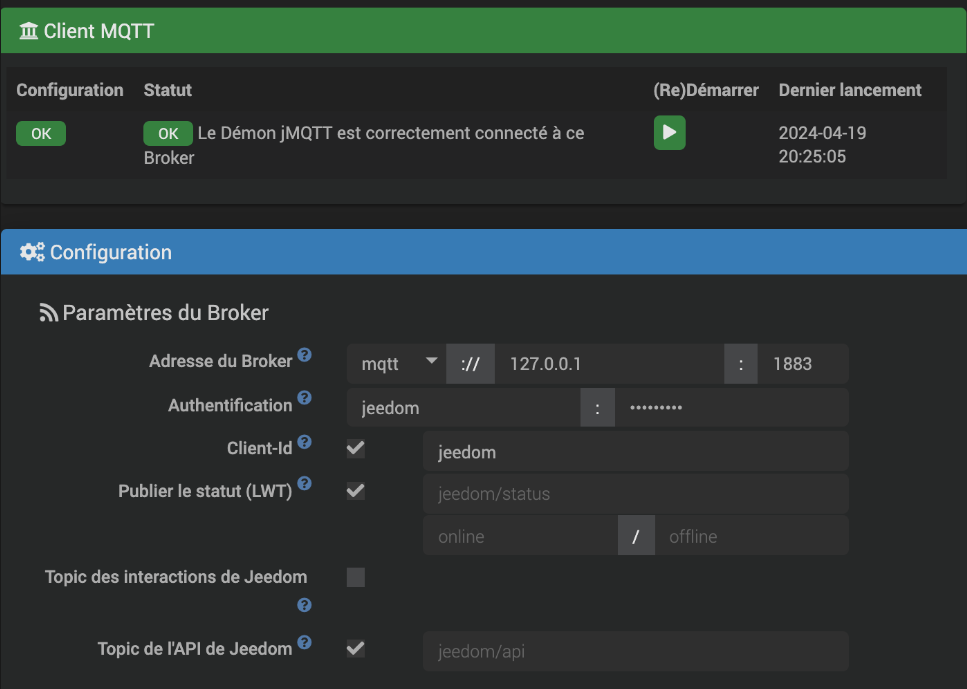

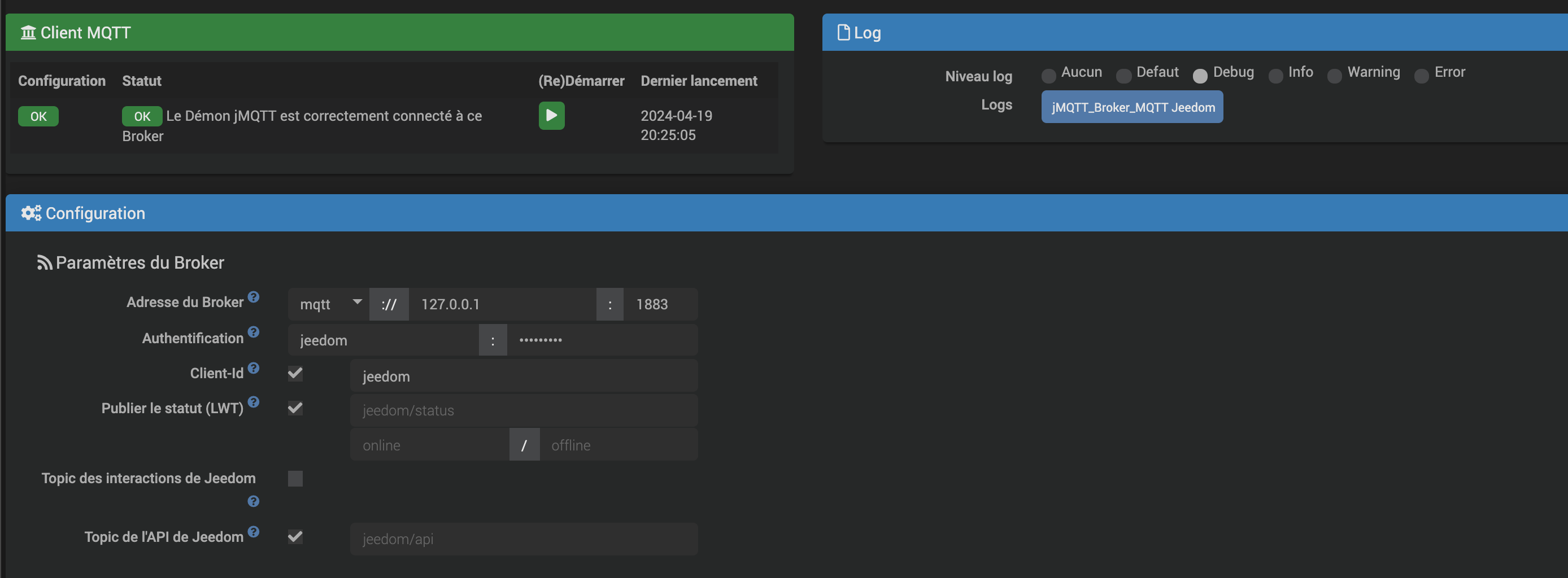

Avec un état de santé correcte
Et un broker UP
Avec les erreurs suivantes :
0010|[2024-04-19 17:32:10,791] INFO Main MainThread set_log_level() : New log level set to: ERROR
0011|[2024-04-19 18:20:57,118] ERROR Client198 Brk198Th on_disconnect() : Unexpected disconnection from broker!
0012|[2024-04-19 18:21:02,122] ERROR Client198 Brk198Th on_disconnect() : Unexpected disconnection from broker!
0013|[2024-04-19 18:21:04,127] ERROR Client198 Brk198Th on_disconnect() : Unexpected disconnection from broker!
0014|[2024-04-19 18:21:09,130] ERROR Client198 Brk198Th on_disconnect() : Unexpected disconnection from broker!
0015|[2024-04-19 18:21:19,133] ERROR Client198 Brk198Th on_disconnect() : Unexpected disconnection from broker!
Le souci est qu’aucune commande n’est prise en compte alors que depuis l’URL du tasmota tout est ok sur le ON/OFF

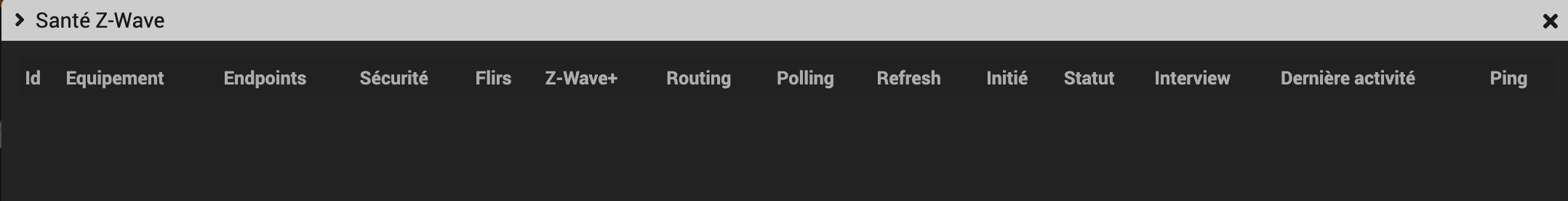

Lors des mise à jour précédentes, un recalage Port du contrôleur Z-Wave et un ping des clients permettait une remise en route. Mais là plus aucun éléménts apparait dans « santé »

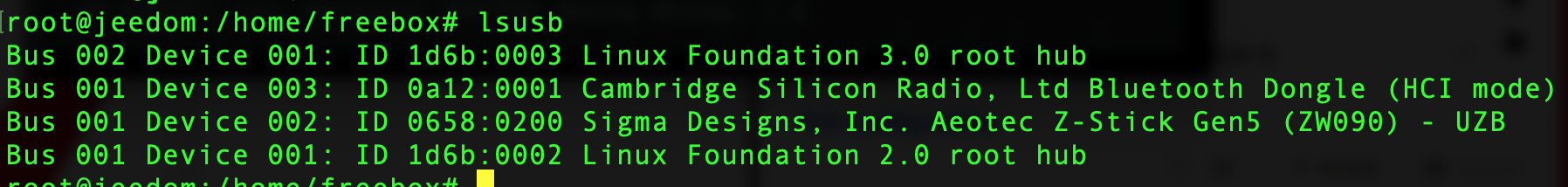

Coté dongle USB il est bien prit en compte par l’OS
