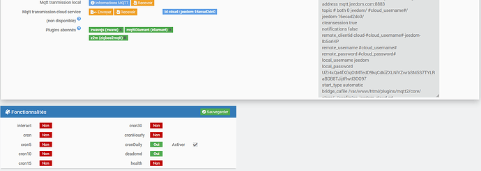

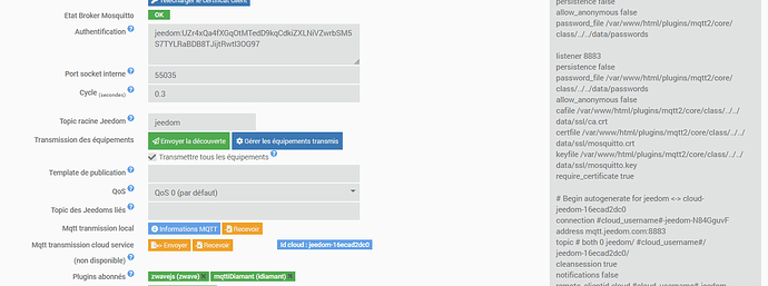

Pourquoi ne pas fournir le log complet ?

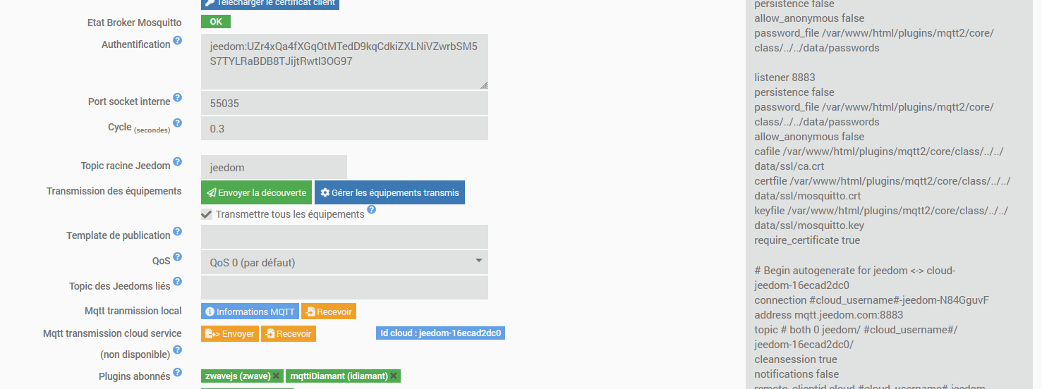

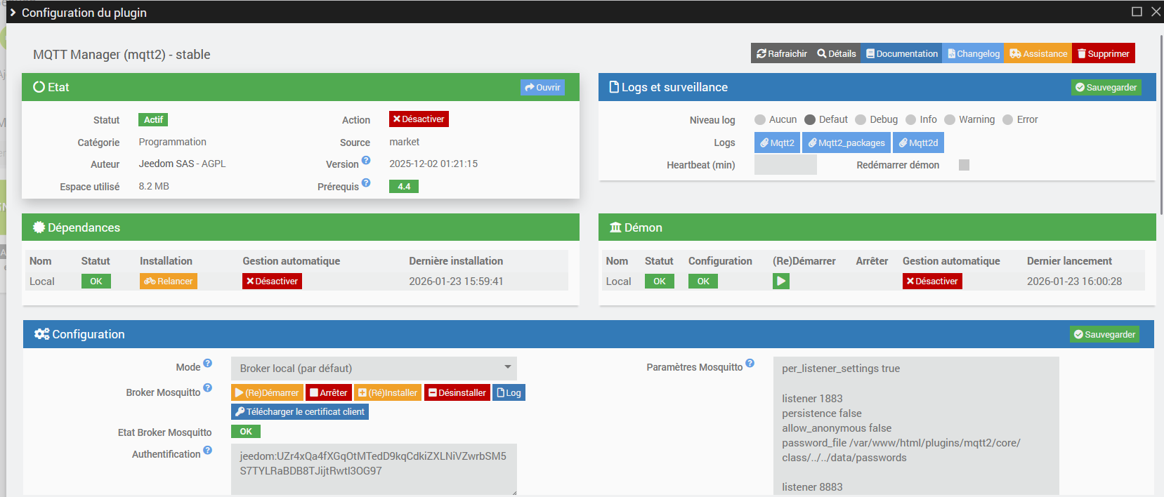

Pourrais-tu fournir la copie écran de la configuration du plugin MQTT Manager ?
akenad :slight_smile:

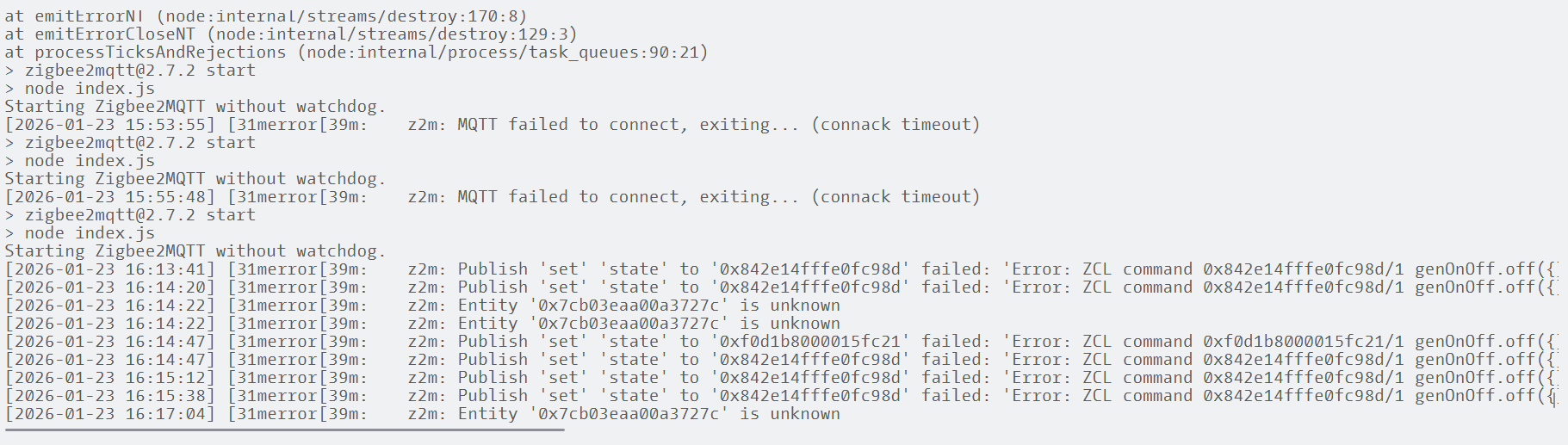

Depuis quelle date , il y en a bcp?
à partir de [2026-01-23 16:13:41]
[2026-01-23 16:13:41] e[31merrore[39m: z2m: Publish ‹ set › ‹ state › to ‹ 0x842e14fffe0fc98d › failed: ‹ Error: ZCL command 0x842e14fffe0fc98d/1 genOnOff.off({}, {« timeout »:10000,« disableResponse »:false,« disableRecovery »:false,« disableDefaultResponse »:false,« direction »:0,« reservedBits »:0,« writeUndiv »:false}) failed (Data request failed with error: ‹ NWK_NO_ROUTE › (0xcd)) ›
[2026-01-23 16:14:20] e[31merrore[39m: z2m: Publish ‹ set › ‹ state › to ‹ 0x842e14fffe0fc98d › failed: ‹ Error: ZCL command 0x842e14fffe0fc98d/1 genOnOff.off({}, {« timeout »:10000,« disableResponse »:false,« disableRecovery »:false,« disableDefaultResponse »:false,« direction »:0,« reservedBits »:0,« writeUndiv »:false}) failed (Data request failed with error: ‹ NWK_NO_ROUTE › (0xcd)) ›
[2026-01-23 16:14:22] e[31merrore[39m: z2m: Entity ‹ 0x7cb03eaa00a3727c › is unknown
[2026-01-23 16:14:47] e[31merrore[39m: z2m: Publish ‹ set › ‹ state › to ‹ 0xf0d1b8000015fc21 › failed: ‹ Error: ZCL command 0xf0d1b8000015fc21/1 genOnOff.off({}, {« timeout »:10000,« disableResponse »:false,« disableRecovery »:false,« disableDefaultResponse »:false,« direction »:0,« reservedBits »:0,« writeUndiv »:false}) failed (Data request failed with error: ‹ NWK_NO_ROUTE › (0xcd)) ›
[2026-01-23 16:14:47] e[31merrore[39m: z2m: Publish ‹ set › ‹ state › to ‹ 0x842e14fffe0fc98d › failed: ‹ Error: ZCL command 0x842e14fffe0fc98d/1 genOnOff.off({}, {« timeout »:10000,« disableResponse »:false,« disableRecovery »:false,« disableDefaultResponse »:false,« direction »:0,« reservedBits »:0,« writeUndiv »:false}) failed (Data request failed with error: ‹ NWK_NO_ROUTE › (0xcd)) ›
[2026-01-23 16:15:12] e[31merrore[39m: z2m: Publish ‹ set › ‹ state › to ‹ 0x842e14fffe0fc98d › failed: ‹ Error: ZCL command 0x842e14fffe0fc98d/1 genOnOff.off({}, {« timeout »:10000,« disableResponse »:false,« disableRecovery »:false,« disableDefaultResponse »:false,« direction »:0,« reservedBits »:0,« writeUndiv »:false}) failed (Data request failed with error: ‹ NWK_NO_ROUTE › (0xcd)) ›
[2026-01-23 16:15:38] e[31merrore[39m: z2m: Publish ‹ set › ‹ state › to ‹ 0x842e14fffe0fc98d › failed: ‹ Error: ZCL command 0x842e14fffe0fc98d/1 genOnOff.off({}, {« timeout »:10000,« disableResponse »:false,« disableRecovery »:false,« disableDefaultResponse »:false,« direction »:0,« reservedBits »:0,« writeUndiv »:false}) failed (Data request failed with error: ‹ NWK_NO_ROUTE › (0xcd)) ›
[2026-01-23 16:17:04] e[31merrore[39m: z2m: Entity ‹ 0x7cb03eaa00a3727c › is unknown

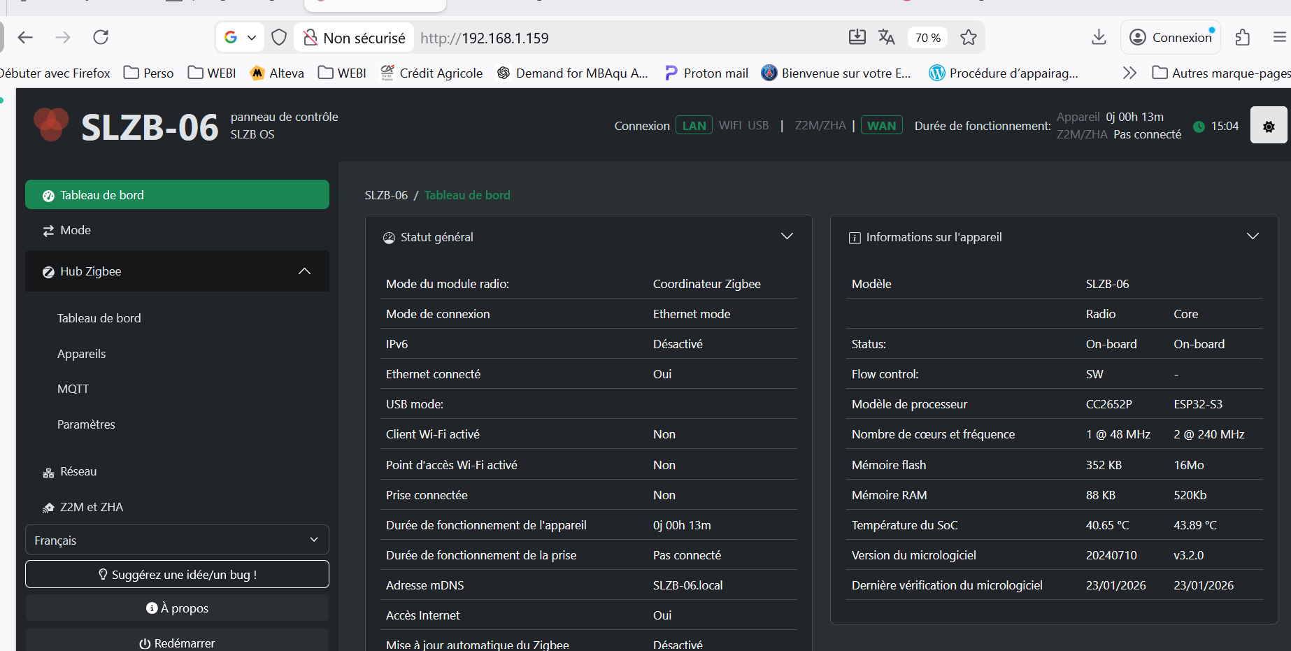

Ce serait moi, je tenterais d’éteindre et de rallumer le SLZB-06.
Quel est l’url que tu mets dans la barre d’adresse du navigateur pour accéder au SLZB-06 ? (pas visible sur la copie écran).

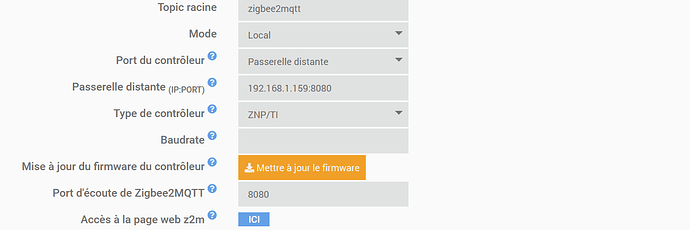

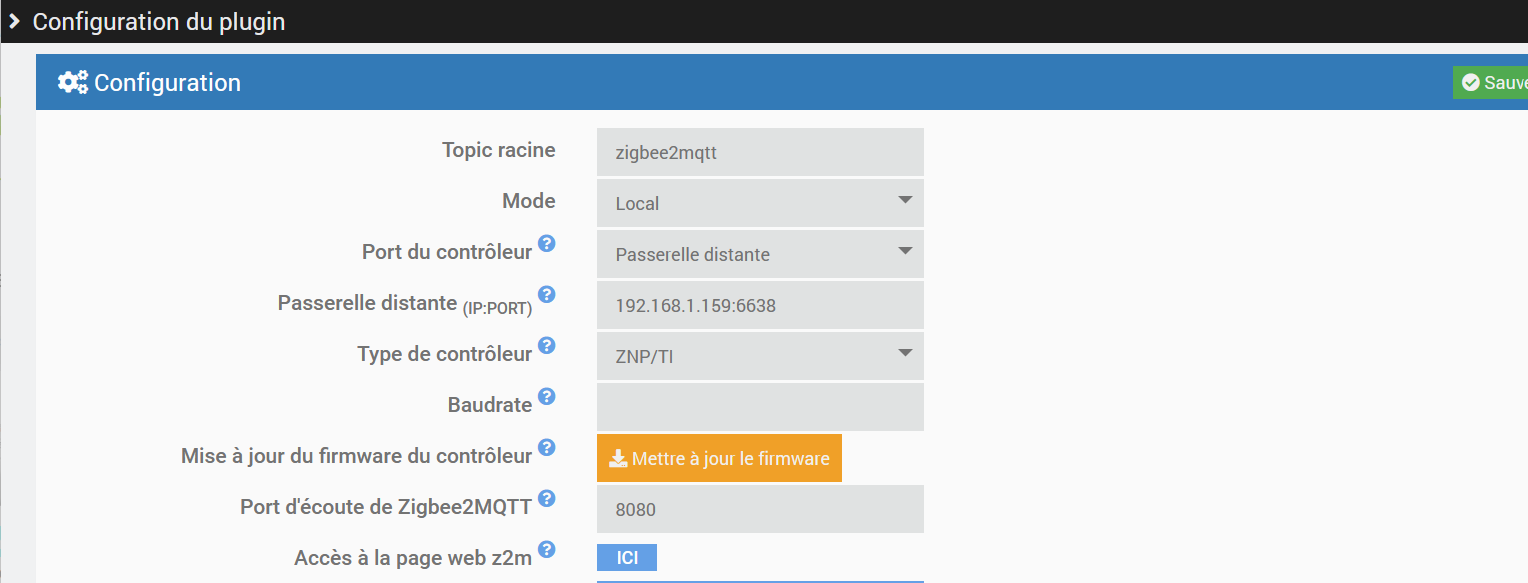

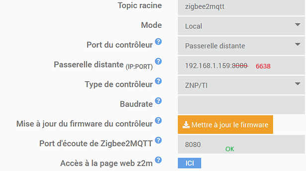

le port d’écoute de zigbee2mqtt (dans la configuration de jeezigbee) est incorrecte (6638)
ça devrait être 8080 par défaut.
Lorque je clique sur le lien pour « ICI » l’adresse qui n’est pas celle de la passerelle zigbee
Mais c’est l’adresse IP de Jeedom ce bug est apparut lors de mon absence et le seul évènement est une coupure de courant
par contre il faut laisser le port 6638 pour la passerelle distante.
jeezigbee-passerelle-distante-port-6638-port-ecoute-zigbee2mqtt-8080

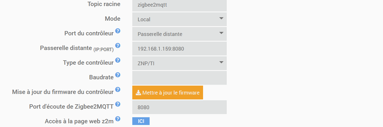

tu n’as pas du sauvegarder la modification que je t’ai suggéré.
Passerelle distante : 192.168.1.159:6638
Port d’écoute de zigbee2mqtt : 8080
si , mais je n’ai touché a rien et tout refonctionne,
