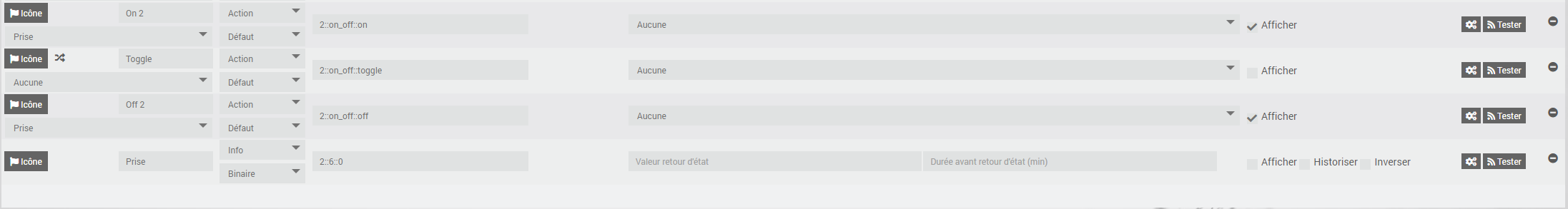

Je n’arrive à faire aucune action sur l’endpoint 2 :
[2021-04-13 16:33:04][DEBUG] : {"ieee":"84:2e:14:ff:fe:fa:1b:22","cmd":[{"endpoint":2,"cluster":"on_off","command":"on","await":1}],"allowQueue":false}
[2021-04-13 16:34:01][ERROR] : Erreur exécution de la commande [Etage][Switch_Camille][On 2] : Erreur lors de la requete : http://127.0.0.1:8089/device/command(PUT), data : {"ieee":"84:2e:14:ff:fe:fa:1b:22","cmd":[{"endpoint":2,"cluster":"on_off","command":"on","await":1}],"allowQueue":false} erreur : {"state":"error","result":"","code":0}
