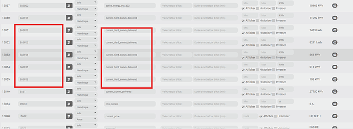

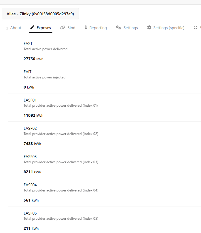

Je souhaiterai integrer un module zlinky (z2m) dans teleinfo mais j’ai l’impresison que les données MQTT ne correspondent pas à ce qui est attendu
données MQTT :
{"active_energy_out_d01":11834,"active_energy_out_d02":10463,"active_power":276,"active_power_max":5757,"active_power_ph_b":154,"apparent_power":353,"available_power":6,"average_rms_voltage_meas_period":234,"current_date":"E250707152528","current_index_tarif":2,"current_price":"HP BLEU","current_summ_delivered":27750,"current_summ_received":0,"current_tarif":"TEMPO","current_tier1_summ_delivered":11092,"current_tier2_summ_delivered":7483,"current_tier3_summ_delivered":8211,"current_tier4_summ_delivered":561,"current_tier5_summ_delivered":211,"current_tier6_summ_delivered":192,"device":{"applicationVersion":12,"dateCode":"20230214","friendlyName":"Allée - Zlinky","hardwareVersion":1,"ieeeAddr":"0x00158d0005d297a9","manufacturerID":4151,"manufacturerName":"LiXee","model":"ZLinky_TIC","networkAddress":9982,"powerSource":"Mains (single phase)","softwareBuildID":"4000-0013","stackVersion":2,"type":"Router","zclVersion":3},"drawn_v_a_max_n1":4938,"injected_active_load_n":0,"injected_active_load_n1":0,"injected_v_a":0,"injected_v_a_max_n":0,"injected_v_a_max_n1":0,"last_seen":"2025-07-07T15:31:25+02:00","linkquality":112,"message1":"PAS DE MESSAGE","message2":"","meter_serial_number":"061864279960","power_threshold":6,"reactive_power":0,"reactive_power_ph_b":0,"reactive_power_ph_c":0,"relais":108,"relais_breakout":{"relais1":0,"relais2":0,"relais3":1,"relais4":1,"relais5":0,"relais6":1,"relais7":1,"relais8":0},"rms_current":2,"rms_voltage":231,"site_id":"19366280726392","software_revision":2,"status_register":"013A4401","status_register_breakout":{"cache_borne_dist":"ferme","comm_euridis":"activee avec securite","contact_sec":"ouvert","depassement_ref_pow":0,"etat_cpl":"nouveau_verrouille","horloge":"correcte","organe_coupure":"ferme","pointe_mobile":"AUCUN","preavis_pointe_mobile":"AUCUN","producteur":0,"sens_energie_active":"positive","surtension_phase":0,"sync_cpl":"non_synchronise","tarif_dist":"index_2","tarif_four":"index_2","tempo_demain":"UNDEF","tempo_jour":"BLEU","type_tic":"standard"},"total_reactive_power":0,"update":{"installed_version":1,"latest_version":16,"state":"available"}}
dans z2m :
dans jeedom :

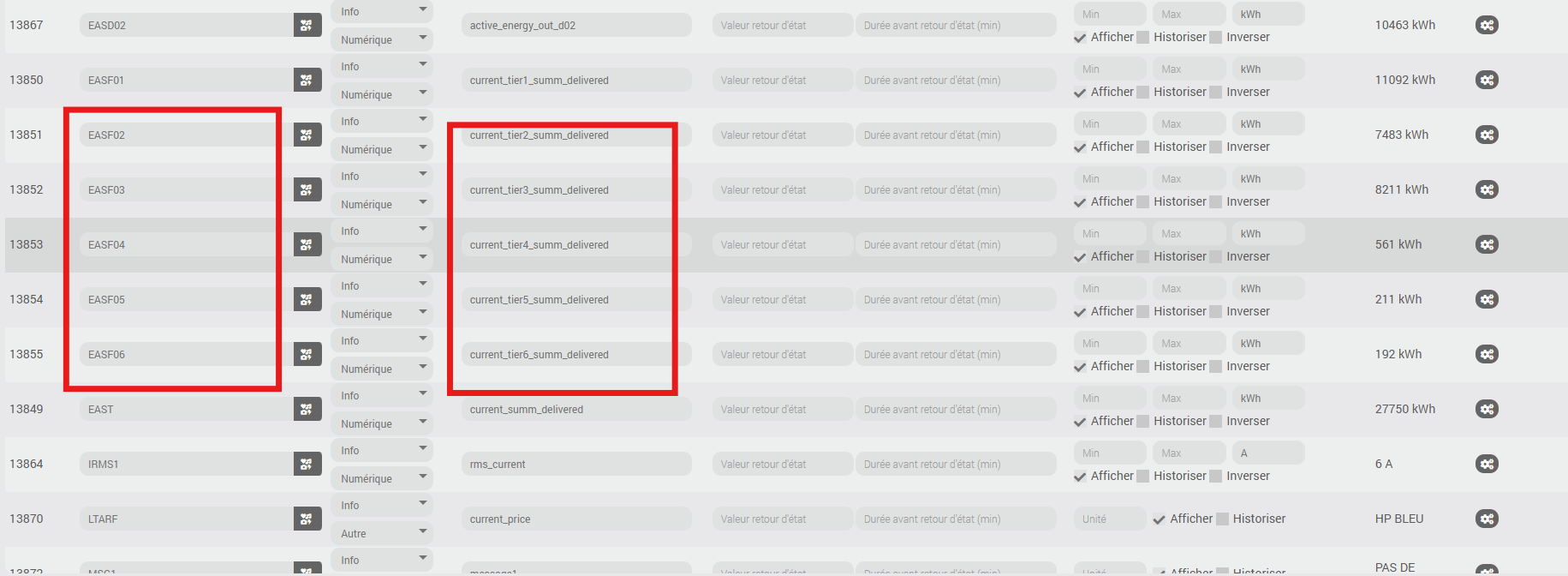

ca génère bien des commandes EASF01 dans z2m et jeedom, … mais la source transmet en MQTT current_tier1_summ_delivered
Comment faire comprendre au plugin-teleinfo qu’il recevra en mqtt current_tier1_summ_delivered
