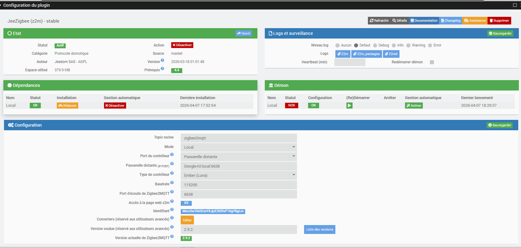

Dans jeedom
J’ai modifié Z2M pour se connecter sur le module avec l’adresse et le port proposé sur l’interface du module sonoff (voir copie d’écran)
Résultat, le demon Z2M se lance et au bout de 30 sec le demon tombe
→ les infos sur l’interface du module Sonoff montrent la même chose
J’ai peut être oublié des infos mais merci de votre aide

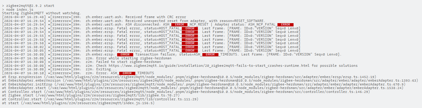

zigbee2mqtt@2.9.2 start
node index.js
[2026-04-07 16:29:48] e[31merrore[39m: 	zh:ember:uart:ash: Received frame with CRC error
[2026-04-07 16:29:54] e[31merrore[39m: 	zh:ember:uart:ash: Received unexpected reset from adapter, with reason=RESET_SOFTWARE.
[2026-04-07 16:29:54] e[31merrore[39m: 	zh:ember:uart:ash: ASH disconnected: ASH_ERROR_NCP_RESET | Adapter status: ASH_NCP_FATAL_ERROR
[2026-04-07 16:29:54] e[31merrore[39m: 	zh:ember:ezsp: Fatal error, status=HOST_FATAL_ERROR. Last Frame: [FRAME: ID=0:"VERSION" Seq=0 Len=0]
[2026-04-07 16:29:55] e[31merrore[39m: 	zh:ember:ezsp: Fatal error, status=HOST_FATAL_ERROR. Last Frame: [FRAME: ID=0:"VERSION" Seq=0 Len=0]
[2026-04-07 16:29:58] e[31merrore[39m: 	zh:ember:ezsp: Fatal error, status=HOST_FATAL_ERROR. Last Frame: [FRAME: ID=0:"VERSION" Seq=0 Len=0]
[2026-04-07 16:30:02] e[31merrore[39m: 	zh:ember:ezsp: Fatal error, status=HOST_FATAL_ERROR. Last Frame: [FRAME: ID=0:"VERSION" Seq=0 Len=0]
[2026-04-07 16:30:05] e[31merrore[39m: 	zh:ember:ezsp: Fatal error, status=HOST_FATAL_ERROR. Last Frame: [FRAME: ID=0:"VERSION" Seq=0 Len=0]
[2026-04-07 16:30:08] e[31merrore[39m: 	zh:ember:ezsp: ERROR Transaction failure; status=ASH_ERROR_TIMEOUTS. Last Frame: [FRAME: ID=0:"VERSION" Seq=0 Len=0].
[2026-04-07 16:30:08] e[31merrore[39m: 	z2m: Error while starting zigbee-herdsman
[2026-04-07 16:30:08] e[31merrore[39m: 	z2m: Failed to start zigbee-herdsman
[2026-04-07 16:30:08] e[31merrore[39m: 	z2m: Check https://www.zigbee2mqtt.io/guide/installation/20_zigbee2mqtt-fails-to-start_crashes-runtime.html for possible solutions
[2026-04-07 16:30:08] e[31merrore[39m: 	z2m: Exiting...
[2026-04-07 16:30:10] e[31merrore[39m: 	z2m: Error: ASH_ERROR_TIMEOUTS
at Ezsp.ezspVersion (/var/www/html/plugins/z2m/resources/zigbee2mqtt/node_modules/.pnpm/zigbee-herdsman@10.0.5/node_modules/zigbee-herdsman/src/adapter/ember/ezsp/ezsp.ts:1452:19)
at EmberAdapter.emberVersion (/var/www/html/plugins/z2m/resources/zigbee2mqtt/node_modules/.pnpm/zigbee-herdsman@10.0.5/node_modules/zigbee-herdsman/src/adapter/ember/adapter/emberAdapter.ts:1393:63)
at EmberAdapter.initEzsp (/var/www/html/plugins/z2m/resources/zigbee2mqtt/node_modules/.pnpm/zigbee-herdsman@10.0.5/node_modules/zigbee-herdsman/src/adapter/ember/adapter/emberAdapter.ts:670:9)
at EmberAdapter.start (/var/www/html/plugins/z2m/resources/zigbee2mqtt/node_modules/.pnpm/zigbee-herdsman@10.0.5/node_modules/zigbee-herdsman/src/adapter/ember/adapter/emberAdapter.ts:1538:24)
at Controller.start (/var/www/html/plugins/z2m/resources/zigbee2mqtt/node_modules/.pnpm/zigbee-herdsman@10.0.5/node_modules/zigbee-herdsman/src/controller/controller.ts:146:29)
at Zigbee.start (/var/www/html/plugins/z2m/resources/zigbee2mqtt/lib/zigbee.ts:70:27)
at Controller.start (/var/www/html/plugins/z2m/resources/zigbee2mqtt/lib/controller.ts:111:29)
at start (/var/www/html/plugins/z2m/resources/zigbee2mqtt/index.js:156:5)
Bonjour, dans le champ « passerelle distante » je ne vois pas l’adresse IP dans votre configuration. Il faudrait remplacer « Dongle-M-Local:6638 » par « 192.168.xxx.xxx:6638 ».
J’ai testé les 2 : Dongle-M-Local:6638 et l’adresse IP interne
Dans les 2 cas ça se connecte 30 sec puis ko
Pour le nom DNS tehoriquement il est resolvable oui.
Dans les logs il y a un lien Zigbee2MQTT fails to start/crashes runtime | Zigbee2MQTT
Quand on va dessus, l’erreur ASH_NCP_FATAL_ERROR indique que ça peut être un souci de connectivité réseau entre jeedom et l’adaptateur.
