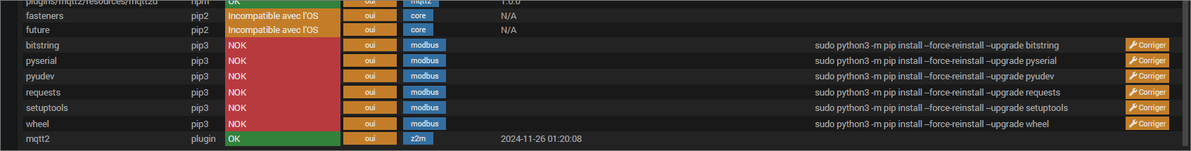

Installation dépendance
L’installation du plugin Modbus l’installation des dépendances bloquent…
Merci d’avance

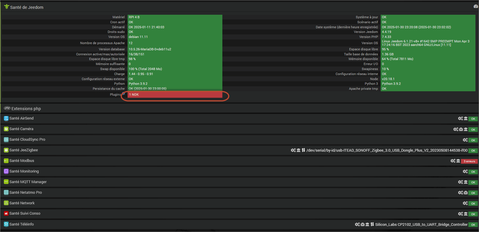

Informations Jeedom
Core : 4.4.19 (master)
DNS Jeedom : non
Plugin : Modbus
Version : 2024-11-09 01:01:56 (stable)
Statut Démon : Stoppé - (Inconnue)
Post illisible!
  • Collez chaque log dans un bloc Texte préformaté (bouton Texte préformaté)
  • fournissez une capture écran de la page santé

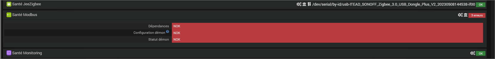

Dépendances
Nom 	Statut 	Installation 	Gestion automatique 	Dernière installation
Local 	NOK
2025-01-22 22:04:04
Démon
Nom 	Statut 	Configuration 	(Re)Démarrer 	Arrêter 	Gestion automatique 	Dernier lancement
Local 	NOK 	NOK Dépendances non installées
Inconnue

Log du plugin modbus_packages
Log brut
+ touch /tmp/jeedom_install_in_progress_modbus
+ echo 1
+ echo 2
apt: no process found
apt-get: no process found
+ sudo apt update
Hit:1 http://archive.raspberrypi.org/debian bullseye InRelease
Hit:2 http://deb.debian.org/debian bullseye InRelease
Hit:3 http://security.debian.org/debian-security bullseye-security InRelease
Hit:4 http://deb.debian.org/debian bullseye-updates InRelease
Hit:5 https://deb.nodesource.com/node_20.x nodistro InRelease
Reading package lists...
Building dependency tree...
Reading state information...
2 packages can be upgraded. Run 'apt list --upgradable' to see them.
+ echo 3
+ sudo apt install -o Dpkg::Options::=--force-confdef -y python3
python3 is already the newest version (3.9.2-3).
0 upgraded, 0 newly installed, 0 to remove and 2 not upgraded.
+ echo 4
+ sudo apt install -o Dpkg::Options::=--force-confdef -y python3-pip
python3-pip is already the newest version (20.3.4-4+rpt1+deb11u1).
+ echo 5
+ sudo apt install -o Dpkg::Options::=--force-confdef -y python3-pyudev
python3-pyudev is already the newest version (0.22.0-2).
+ echo 6
+ sudo apt install -o Dpkg::Options::=--force-confdef -y python3-dev
python3-dev is already the newest version (3.9.2-3).
+ echo 7
+ sudo apt install -o Dpkg::Options::=--force-confdef -y python3-requests
python3-requests is already the newest version (2.25.1+dfsg-2).
+ echo 8
+ sudo apt install -o Dpkg::Options::=--force-confdef -y python3-setuptools
python3-setuptools is already the newest version (52.0.0-4+deb11u1).
+ echo 9
++ awk '$1 <= 4'
++ cut -f 2-
++ find /usr/local/lib/python3.9/dist-packages/ -mindepth 1 -maxdepth 1 -type d -exec du -ks '{}' +
+ RESULTTODELETE=
++ sed 's, ,\ ,g'
++ echo ''
+ RESULTTODELETE2=
+ echo ''
+ xargs rm -rf
+ echo 10
+ sudo pip3 cache purge
File "/usr/bin/pip3", line 33, in <module>
sys.exit(load_entry_point('pip==20.3.4', 'console_scripts', 'pip3')())
File "/usr/bin/pip3", line 25, in importlib_load_entry_point
return next(matches).load()
File "/usr/lib/python3.9/importlib/metadata.py", line 77, in load
module = import_module(match.group('module'))
File "/usr/lib/python3.9/importlib/__init__.py", line 127, in import_module
return _bootstrap._gcd_import(name[level:], package, level)
File "<frozen importlib._bootstrap>", line 1030, in _gcd_import
File "<frozen importlib._bootstrap>", line 1007, in _find_and_load
File "<frozen importlib._bootstrap>", line 986, in _find_and_load_unlocked
File "<frozen importlib._bootstrap>", line 680, in _load_unlocked
File "<frozen importlib._bootstrap_external>", line 790, in exec_module
File "<frozen importlib._bootstrap>", line 228, in _call_with_frames_removed
File "/usr/lib/python3/dist-packages/pip/_internal/cli/main.py", line 10, in <module>
from pip._internal.cli.autocompletion import autocomplete
File "/usr/lib/python3/dist-packages/pip/_internal/cli/autocompletion.py", line 9, in <module>
from pip._internal.cli.main_parser import create_main_parser
File "/usr/lib/python3/dist-packages/pip/_internal/cli/main_parser.py", line 7, in <module>
from pip._internal.cli import cmdoptions
File "/usr/lib/python3/dist-packages/pip/_internal/cli/cmdoptions.py", line 23, in <module>
from pip._vendor.packaging.utils import canonicalize_name
File "/usr/lib/python3/dist-packages/pip/_vendor/__init__.py", line 94, in <module>
vendored("requests.packages.urllib3.contrib.pyopenssl")
File "/usr/lib/python3/dist-packages/pip/_vendor/__init__.py", line 36, in vendored
__import__(modulename, globals(), locals(), level=0)
File "<frozen importlib._bootstrap>", line 664, in _load_unlocked
File "<frozen importlib._bootstrap>", line 627, in _load_backward_compatible
File "<frozen zipimport>", line 259, in load_module
File "/usr/share/python-wheels/urllib3-1.26.5-py2.py3-none-any.whl/urllib3/contrib/pyopenssl.py", line 50, in <module>
File "/usr/lib/python3/dist-packages/OpenSSL/__init__.py", line 8, in <module>
from OpenSSL import crypto, SSL
File "/usr/lib/python3/dist-packages/OpenSSL/crypto.py", line 1556, in <module>
class X509StoreFlags(object):
File "/usr/lib/python3/dist-packages/OpenSSL/crypto.py", line 1575, in X509StoreFlags
NOTIFY_POLICY = _lib.X509_V_FLAG_NOTIFY_POLICY
AttributeError: module 'lib' has no attribute 'X509_V_FLAG_NOTIFY_POLICY'
+ echo 11
+ sudo pip3 install --upgrade pip
+ echo 12
+ sudo python3 -m pip install --force-reinstall --upgrade pyudev
File "/usr/lib/python3.9/runpy.py", line 197, in _run_module_as_main
return _run_code(code, main_globals, None,
File "/usr/lib/python3.9/runpy.py", line 87, in _run_code
exec(code, run_globals)
File "/usr/lib/python3/dist-packages/pip/__main__.py", line 23, in <module>
from pip._internal.cli.main import main as _main  # isort:skip # noqa

Vous avez l’état de santé juste au dessus et les logs d’installations des dépendances. Pouvez vous m’indiquer ce qu’il manque ?
Pouvez vous m’indiquez de quels éléments complémentaires vous avez besoin ?
Commençons par la page santé jeedom comme cité ci-dessus (menu analyse > santé)
