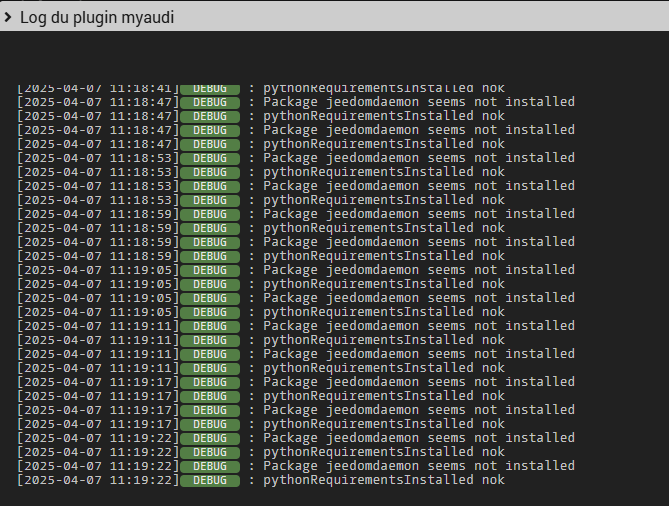

[2025-04-07 11:16:51][DEBUG] : Package jeedomdaemon seems not installed
[2025-04-07 11:16:51][DEBUG] : pythonRequirementsInstalled nok
[2025-04-07 11:16:57][DEBUG] : Package jeedomdaemon seems not installed
[2025-04-07 11:16:57][DEBUG] : pythonRequirementsInstalled nok
[2025-04-07 11:17:03][DEBUG] : Package jeedomdaemon seems not installed
[2025-04-07 11:17:03][DEBUG] : pythonRequirementsInstalled nok
[2025-04-07 11:17:09][DEBUG] : Package jeedomdaemon seems not installed
[2025-04-07 11:17:09][DEBUG] : pythonRequirementsInstalled nok
[2025-04-07 11:17:14][DEBUG] : Package jeedomdaemon seems not installed
[2025-04-07 11:17:14][DEBUG] : pythonRequirementsInstalled nok
[2025-04-07 11:17:20][DEBUG] : Package jeedomdaemon seems not installed
[2025-04-07 11:17:20][DEBUG] : pythonRequirementsInstalled nok
[2025-04-07 11:17:26][DEBUG] : Package jeedomdaemon seems not installed
[2025-04-07 11:17:26][DEBUG] : pythonRequirementsInstalled nok
[2025-04-07 11:17:32][DEBUG] : Package jeedomdaemon seems not installed
[2025-04-07 11:17:32][DEBUG] : pythonRequirementsInstalled nok
[2025-04-07 11:17:37][DEBUG] : Package jeedomdaemon seems not installed
[2025-04-07 11:17:37][DEBUG] : pythonRequirementsInstalled nok
[2025-04-07 11:17:37][DEBUG] : pythonRequirementsInstalled nok```
