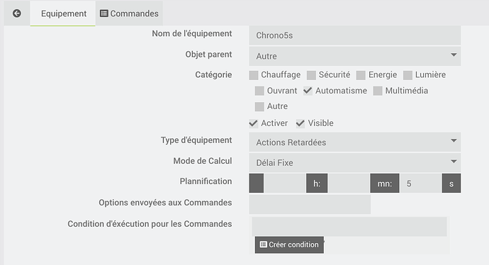

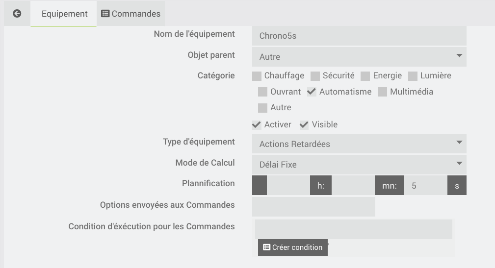

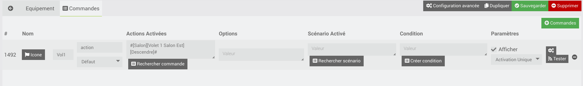

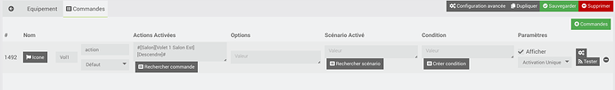

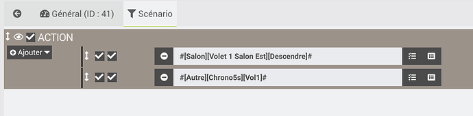

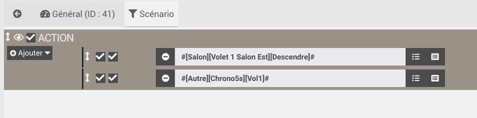

Avez-vous trouvé une réponse ? j’ai le même soucis je pense.
Je souhaite piloter un volet et le piloter de nouveau 5s plus tard (je souhaite éviter la fonction sleep qui bloque l’execution d’autres commandes).
[2024-06-08 15:42:16][DEBUG] : Instances Array (     [1717854136] => Array         (             [user_login] => user             [user_id] => 3         )  )
[2024-06-08 15:42:16][DEBUG] : Instances {"1717854136":{"user_login":"user","user_id":"3"}}
[2024-06-08 15:42:16][DEBUG] : Difftext +5 second  for 1717854136
[2024-06-08 15:42:16][DEBUG] : API Return
[2024-06-08 15:42:16][DEBUG] : Set delayed action http://xxx.xxx.xxx.xxx/plugins/dkron/core/api/dkron.php?apikey=T3DD5bD3f3RjgzitJBYwzNEEmE30mXfEEqwUBb4VwyxXYB4LByKxoKA0ou7Bx3d6&type=delayed&id=1492&time=1717854136 with @at 2024-06-08T13:42:21Z
[2024-06-08 15:42:16][DEBUG] : Body Array (     [name] => 1492     [displayname] => Jeedom 1492     [schedule] => @at 2024-06-08T13:42:21Z     [disabled] =>      [retries] => 0     [concurrency] => allow     [executor] => http     [executor_config] => Array         (             [method] => GET             [url] => http://xxx.xxx.xxx.xxx/plugins/dkron/core/api/dkron.php?apikey=T3DD5bD3f3RjgzitJBYwzNEEmE30mXfEEqwUBb4VwyxXYB4LByKxoKA0ou7Bx3d6&type=delayed&id=1492&time=1717854136             [timeout] => 10             [expectCode] => 200             [expectBody] => OK         )      [metadata] => Array         (             [plugin] => dkron             [type] => delayed             [id] => 1492         )  )
